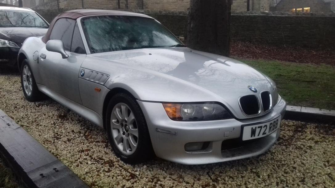

I must be a glutton for punishment or just enjoy build kits one or the other.
Kit on order swb convertible for a change planning to have it ready for stoneleigh I did say planning.

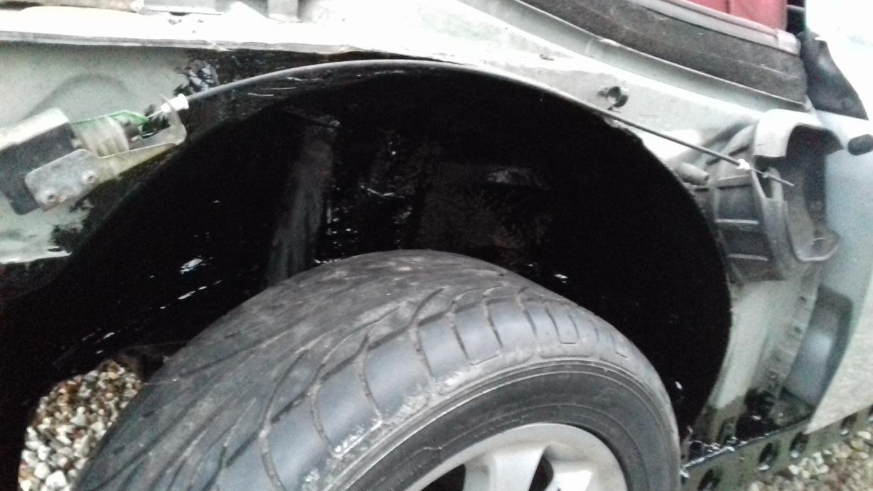

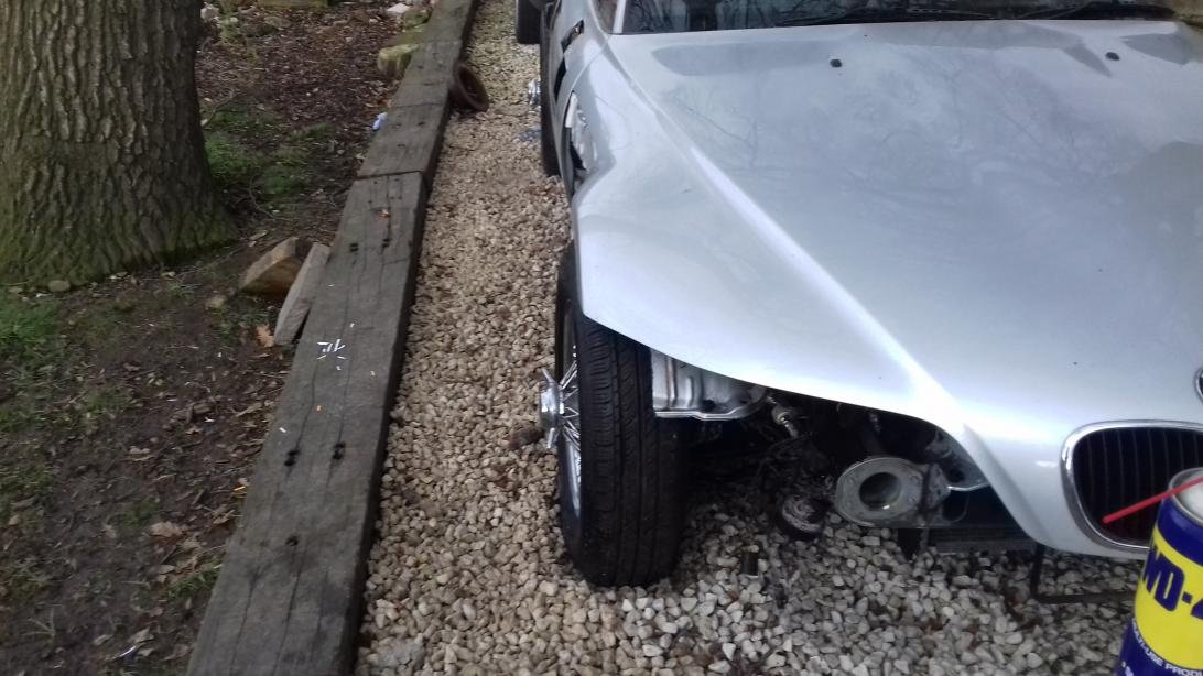

car arrived thursday had the weekend in the rain stripping it
as I am waiting on the kit I decided to go through the car, so I have ordered vented discs and new pads all round and splashed some under seal in the soon to be unseen areas.
let's hope the weather holds out for next weekend:rain:

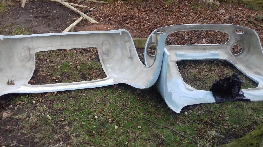

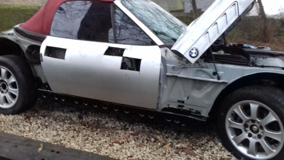

30 Jan 2017, 1:27pm

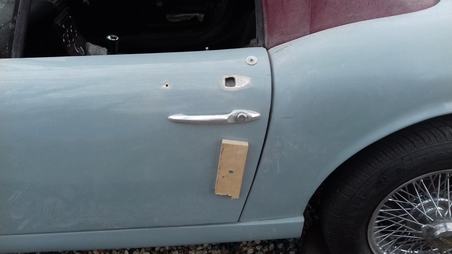

What are the advantages of cutting the holes in the door?
Any chance of a close up picture of the door handle hole?
30 Jan 2017, 1:46pm
from experience makes life easier to adjust and fit the door handle same again with the mirror. no point been bashful and struggling with small holes been there pain in the backside. you will not see it when the new skin is fitted. cars wrapped up and its raining but will take you a pick next time working on it . think my last swb thread had some pics of the door handle set up. andy

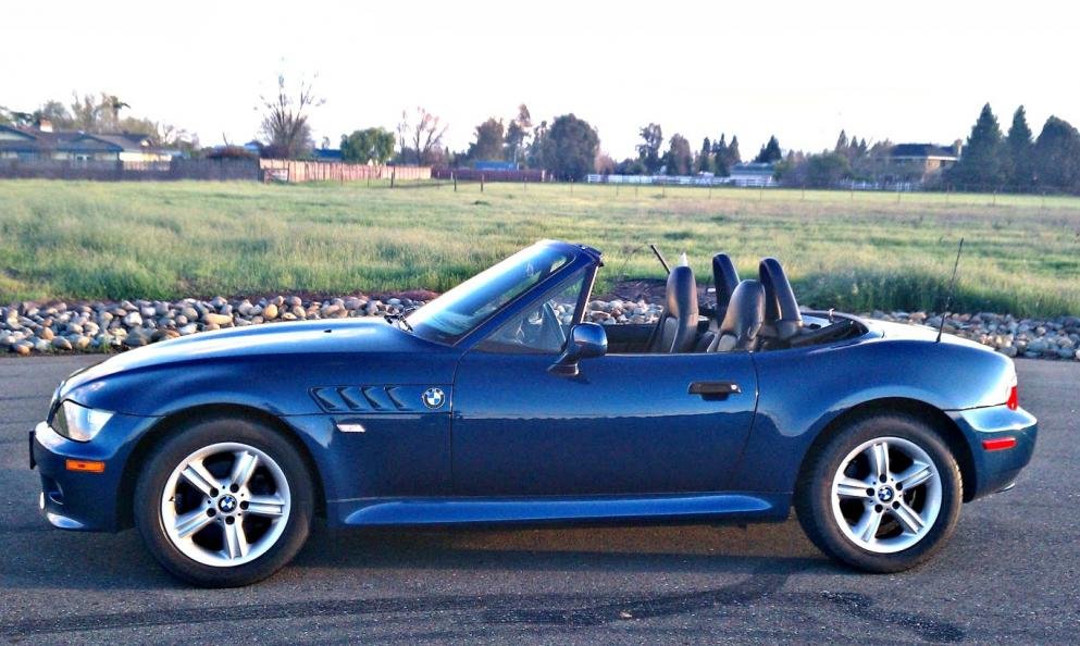

I think the Z4 sits and looks a lot better even the interior
it would look sweet with a SWB kit on with the longer noise and window screen more laid back wonder if chris as ever paid it a thought.
1 Feb 2017, 9:57am
Z3's are still considerably cheaper than Z4's but the 4's do all seem to have larger engines. I've been looking at Z4's for a donor for DNA's 365 Daytona but nothing much coming along in the bargain basement department. My Z3 2.8 donor was pretty much free after I had sold off all the parts, can't see that happening with a Z4.
As the Z3's become too old to warrant the expense of a conversion, I'm sure Chris won't have too much trouble converting it to a Z4 version, he's already done all the hard work.

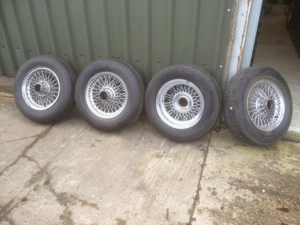

wheels have arrived etype series 1 , hubs will be here for morning praying the brakes get here before the weekend so I can get stuck in raining or not

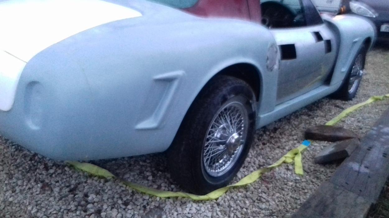

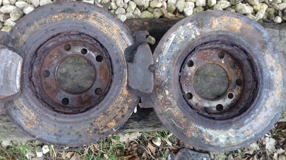

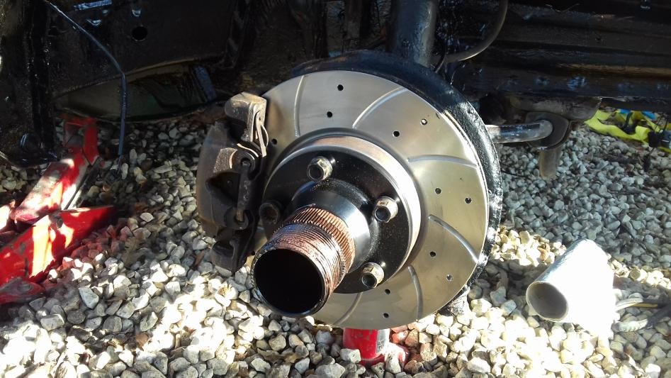

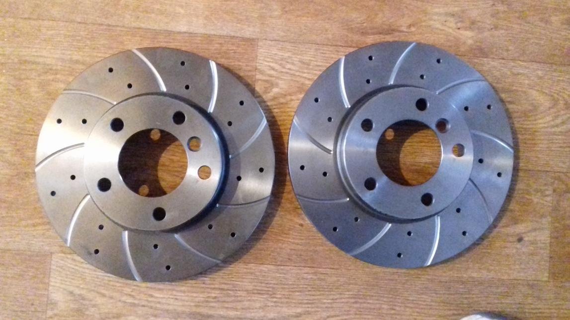

think the brakes did need changing
The brake disc did not look to bad no groves etc all the surface rust is from the rust stop I used. but I ordered a full set anyway good job I did when I finally got them off.
nice new ones
what a pain in the arse think they were original to the car and it did not want to give them up it took twice as long as it should have but worth it.

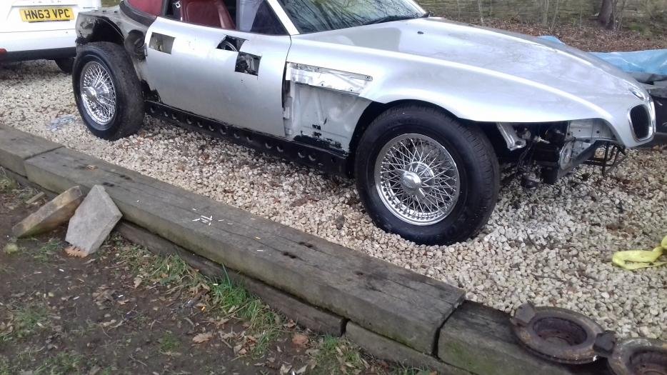

wire wheel hub fitted
and wheels fitted
5 Feb 2017, 5:56pm
The second picture from the bottom looks quite cool in a rat rod sort of way. I wonder how far from legal it would be to drive. A couple of discrete front light clusters hidden somewhere and go cruising...

The wires do look very nice.
Worth getting a spinner removal tool made in aluminium.
http://www.ebay.co.uk/itm/Ferrari-Testarossa-or-Boxer-Wheel-Knock-Off-Spinner-Tool-Wrench-Socket-/112291816455?hash=item1a251d2407:g:QM8AAOxyHntSYE5g
He also makes them for 2 eared spinners, he made me one a few years ago for my Jag. You can tighten and remove them without damaging the spinner.
A lead mallet will damage them, I have tried the wooden tool and and it isn't worth buying as it splits and splinters very quickly. There is also a metal version available but it marks the spinner as well so not worth bothering about.

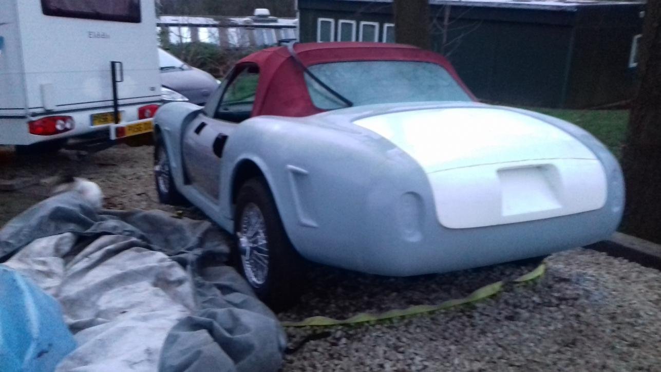

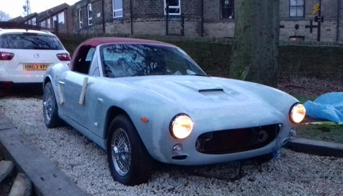

the eagle has landed
kit arrived this morning I would have photographed it on the pallet as you do but the wind was 40mph and raining typical.
so part under a sheet and part getting wet heres where im at day one
quality of the kits is getting better from the first one I did to this the gelcoat has a much better finnish . The wheels fit the arch so no flaring out this time saves me and the bodyshop work another plus. If it stops raining for long enough tomorrow I can get the rest of the body on and start on the tweaking.

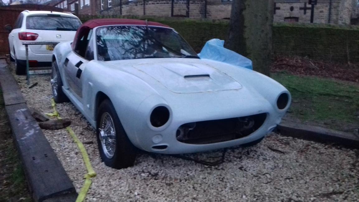

21 Feb 2017, 6:23pm

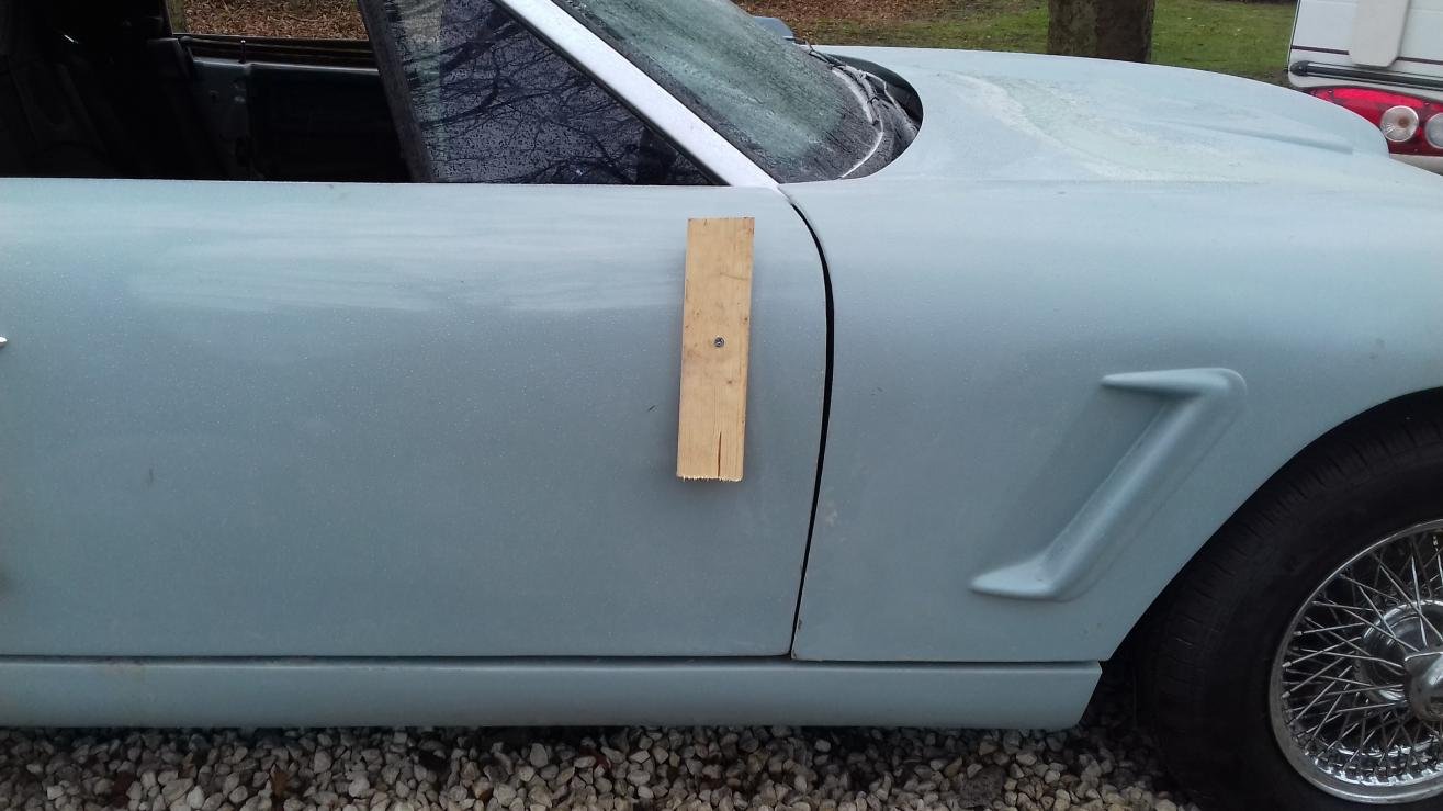

I don't think the door gaps are bad for a trial fit the drivers side I got a bit happy with the sander and trimmed it back a bit too far.
still adjustments to do but I am waiting on the PU18 to arrive to do the final fix and fit.
passenger side was a much better fit because I put the sander away.
For anyone wondering why the wood a screws it's so I can adjust the skin and get the gaps better. first one I ever did I used clamps with the door open. When it was dry I removed the clamps the fit was crap so now do it with the door shut.
fitted the door handle way to high using the marks in the gelcoat for a reference school boy error .

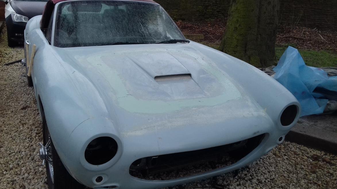

I have glassed the bonnet in and started to fill it out
plan to hold it down using these bad boys they are the bigger 60mm top fixing

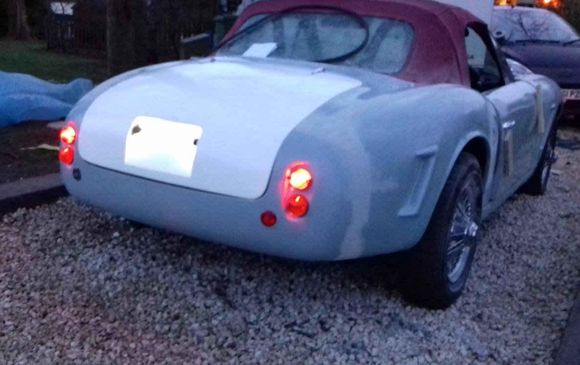

day number4
day number 4 of the build and we have working lights and a boot lid.
if the weather hold off tomorrow should get the doors sorted .:high5:
25 Feb 2017, 11:03am
Looking good ! Are you on it full time or just a couple of hours a day? I know once you've built one car the subsequent ones go together much quicker .
