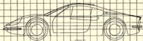

It would be interesting to see a good side on photo of a replica and compare it to a Ferrari blueprint. Probably good to measure height from the ground at several places, e.g. mid nose, mid rear, side rear, swage line at both ends of door, bumpers front and rear, lower glass height at front and rear of door, bottom of body at front wheel arch, rear wheel arch, both ends of sill top of wheel arches, top of door frame at both ends of window glass, height of engine lid, centre in middle of car and rear of engine bay.....
Unfortunately photos are just too distorted to give realistic dimensions.
that way it will be possible to get a good idea of shape. Even real Dinos are varied. I was reading a post on Ferrarichat about someone wanting his Dino rear window to be measured because he had noticed a lot of variation.

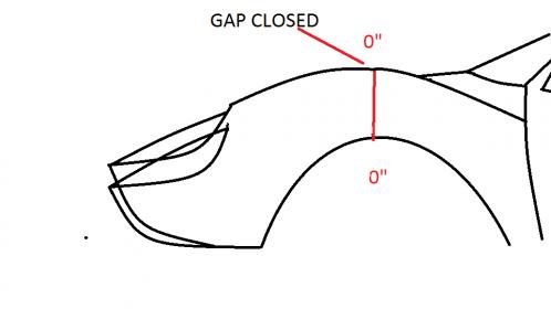

Droopy nose and tail.
Attachment “SANY0541.jpg” from the original forum could not be reliably recovered.
I agree that the front of Deons, JH CLassics and Classic replcas all droop. I noticed it long before I bought one. As I understand it, the original moulds for these cars were taken from a 206, which most examples seem to droop some compared with 246's in profile. If you look at photos of 206 cars, the boot lid always droops down from the back of the engine lid, where as the 246 panels line up level with each other. I suspect that a change was made when they elongated the wheelbase. 246's all have a higher rear. I think some of the kit bodies seem to be drooping a little bit more than others, but in general, they look about right in the back compared to the dino 206 cars. I cut a tapered slice from the top of my front wheelhouses that tapered to zero at the wheel opening and the bonnet opening, raised the front 1 1/2 " and re-glassed everything. The front of the car now looks about like it should. I was surprised, that the front lid now aligns better than it did before and the drop angle of the fiberglass coming down to the headlight opening also looks better. Obviously, I had to rework the beltline to make it level. /Jon
7 May 2017, 2:00am
It's pretty ballsy to chop the whole front end! If you can do it in your garage you would think that manufacturers could fix it up in a pro workshop.

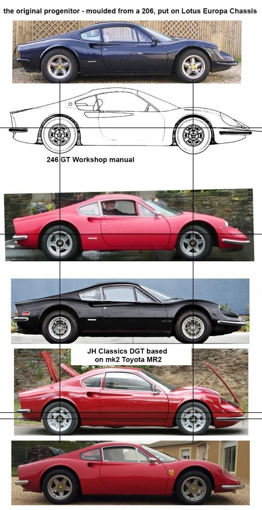

Hi, your solution of cutting at the top of the arch is something I have thought of too but I was worried that it would reduce the curve. I think the initial problem is that mouldings (or the mould itself) were taken out too green and allowed to fully cure without support. Somehow that seems to have made its way into the moulds and hence the sag or droop. I have a genuine front 'clip' of the nose from a 246 but it's not on a chassis to take heights etc from.
Here is a comparison of a few Dinos to assess the differences - just remember that photos of this type do foreshorten and distort.

I think CASCU (on this forum) makes his body from a genuine 246 while virtually every other manufacturer used the mould in one form or another taken from a 206 which had its rear wheel arch shifted to fit a Lotus Europa wheelbase. CASCU's body looks very straight. He doesn't make a kit though - only replica 246 chassis which require 246/308/Mondial suspension. Maybe you could use a CASCU body and make your own chassis? Or adapt a DeHavilland chassis to a CASCU body?

the Pininfarina Blueprint - low res

Ross, if I had 1/10th of the talent of you and others on here I might just do that. I'm handy with spanners and sockets but have no fabrication skills whatsoever.
I'll keep dreaming for now and see what happens. Thanks for the comparison pics - interesting to see the "family tree".

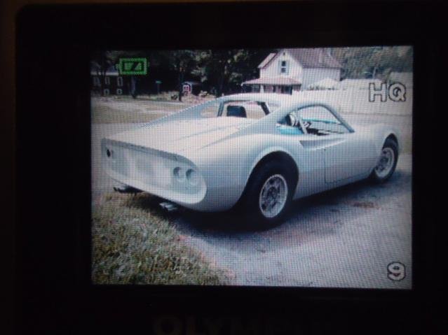

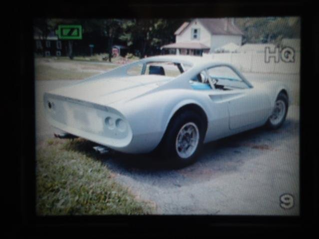

Body work

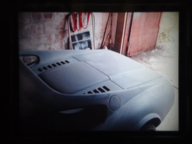

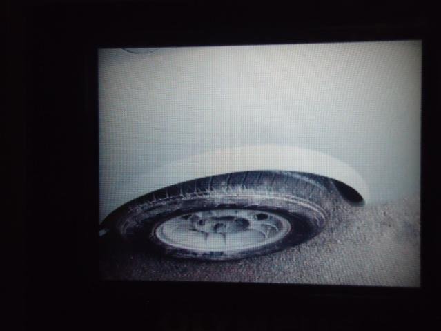

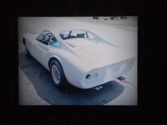

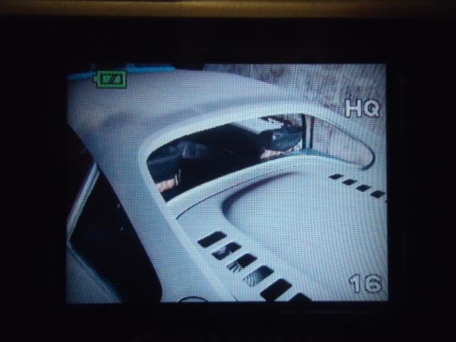

It seems pretty quiet, so I thought I would post some pictures. The nose of the car has been cut off and glassed on higher up to compensate for the droop that Deon/Classic Replicas always seem to have. I have been body working all summer, trying to get the bodyline down the side and wheel arch lines sharp. The car is now almost ready for paint. I would love to see pictures of some of your cars and what you've been doing. Cheers/ Jon

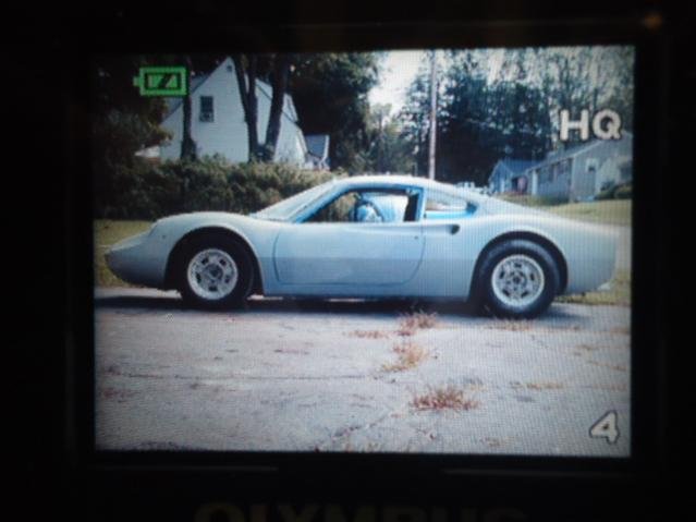

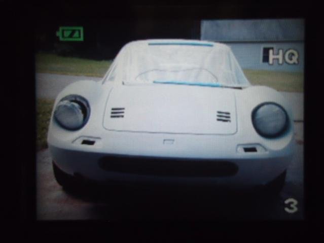

Body Work
More pictures.
