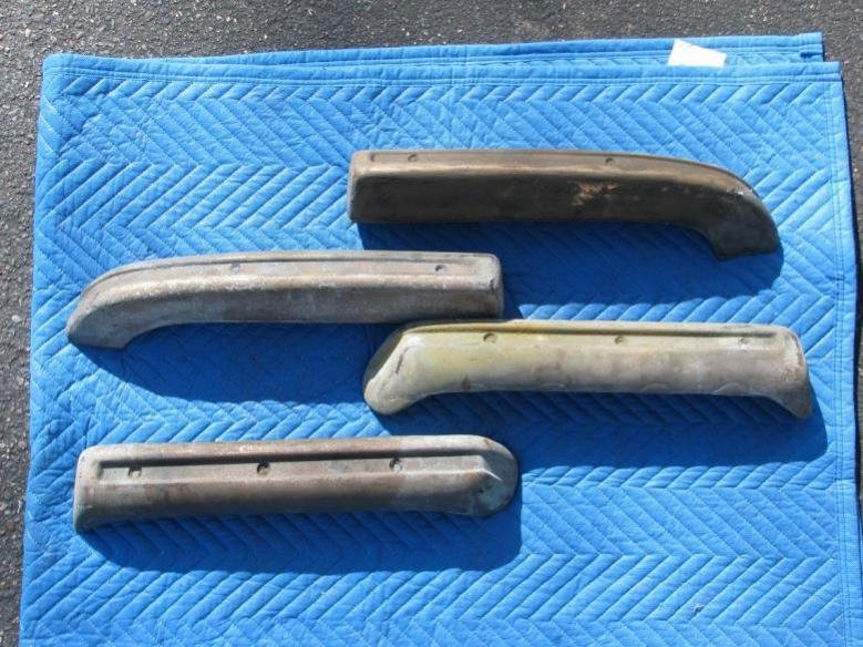

aluminium raw castings - bumpers
Here is a photo from the 'for sale' section on this forum. It shows the raw aluminium castings for Daytona replica bumpers. These are then highly polished and/or I think they can be chromed.
