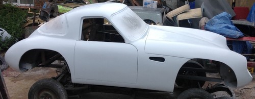

OMG, my first TVR was a Mk2 in white with wire wheels just like that one. Happy days (except for the VW torsion bar suspension). Had a TR2 engine with 2" ground clearance.
A shame that the shell won't drop onto an early Audi TT.
TVR WB 84" Track 52"
Audi WB 95.4" Track 60"

If you were going to use the shell I think it would be more than viable to use a MX5 ,as Tribute does on their MX250
OK who in now checking the wheelbases??
23 Jun 2019, 4:29pm
TVR = 84 inches
MX-5 89 inches (+ or -)
23 Jun 2019, 7:10pm
5 extra inches in the doors wouldn't go amiss then
23 Jun 2019, 9:29pm
I'd stretch it from the cowl forward

Dimensions Checker
Easy to find exact (or close) dimension matches here.
25 Jun 2019, 6:25am
Thanks for posting that Ian, it's a very useful tool for anyone looking for donor chassis for classic replicas.
I did a quick check and it only took a few moments to confirm that the wheelbases of the 356 Speedster and Triumph Spitfire/GT6 are the same, but it also showed me that I could have used a 1990's Willys-Overland Interlagos*, which for some obscure reason I hadn't even considered!
