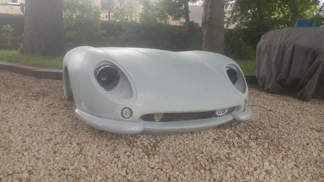

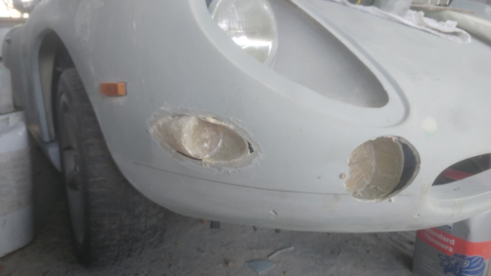

Hi all here I go again waiting on the guy to come back off holiday to paint my 250swb so started a 275GT well why not. love the shape of the 275 just a bigger gto and thats the one car I miss. going to be a slowish build this one as its a keeper for a while . spent some of the weekend building up the front end light and indicator pods fitted. bumpers on but one side is snug one has a gap so I am thinking of blending them in.

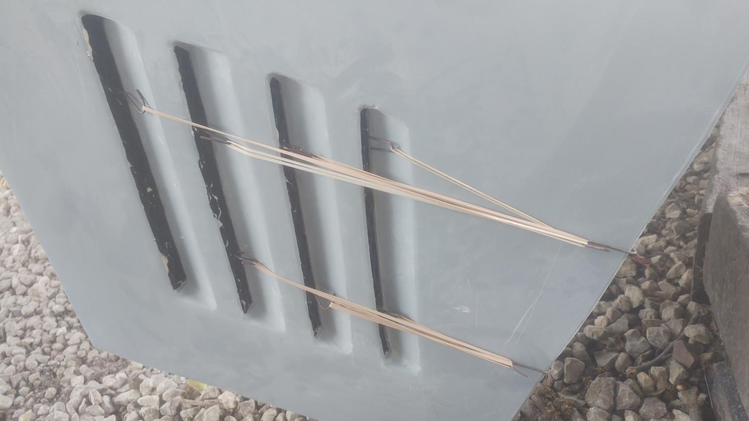

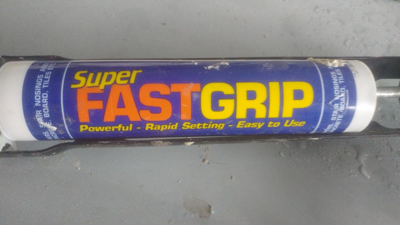

the side vents caused me some serious thinking holding everything in place till it drys so I came up with this. good job the stuff I use sets in ten mins

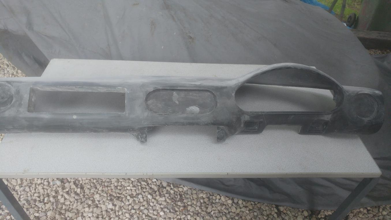

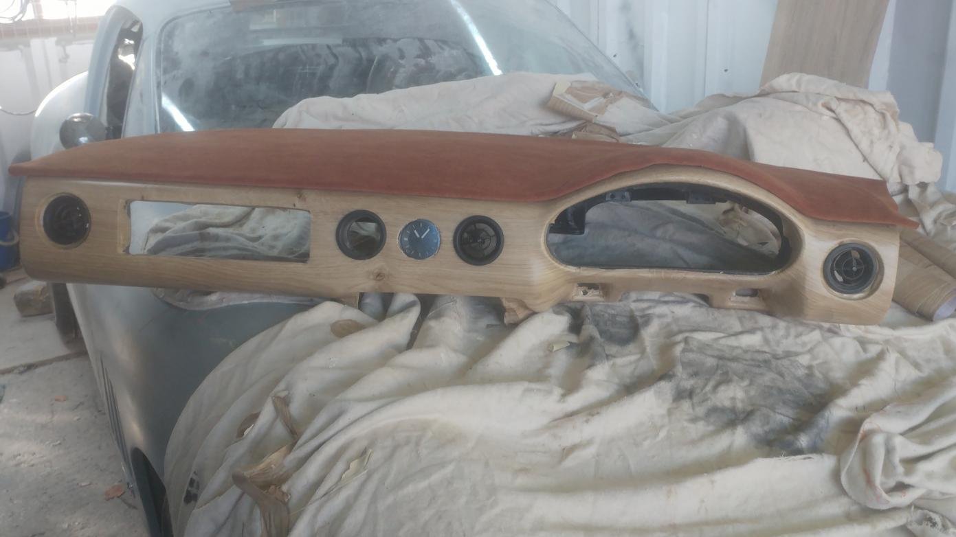

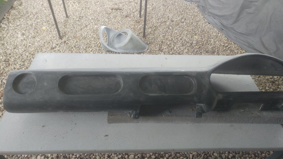

made a change to the dash I want a glovebox so lost one of the pods. I am a bit limited to how much I can do to it at the mo till I get a car to put it in.

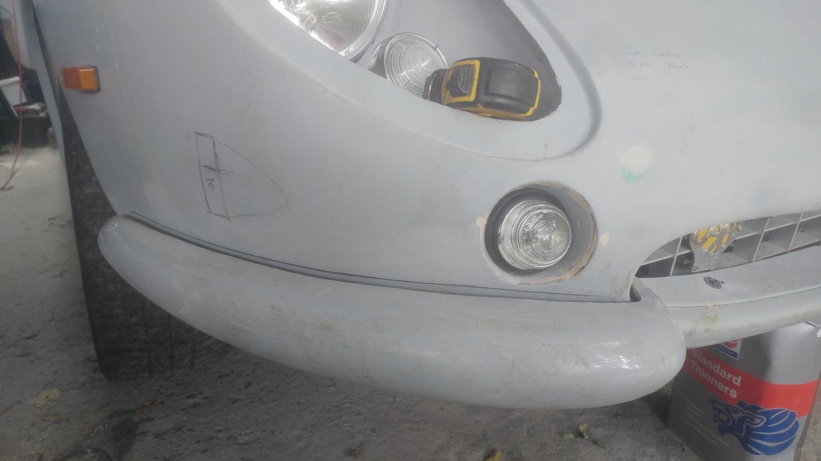

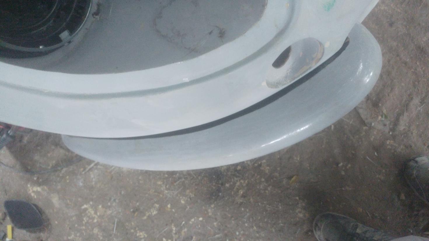

managed to get both the front bumpers snug by cutting the back bracket off trimming it down and re bonding it back on while holding it in place on the car sounds easy but believe me it was not.

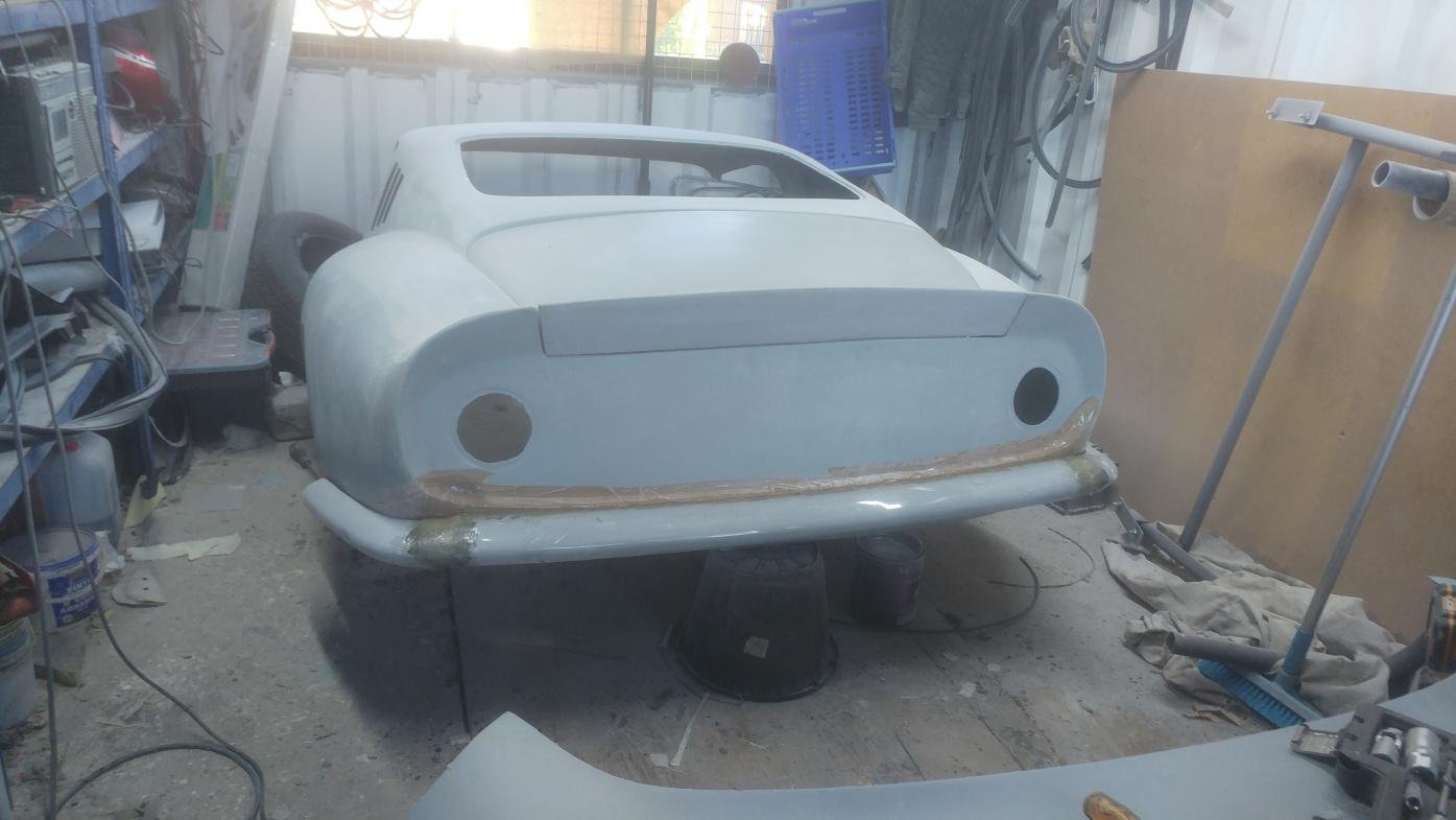

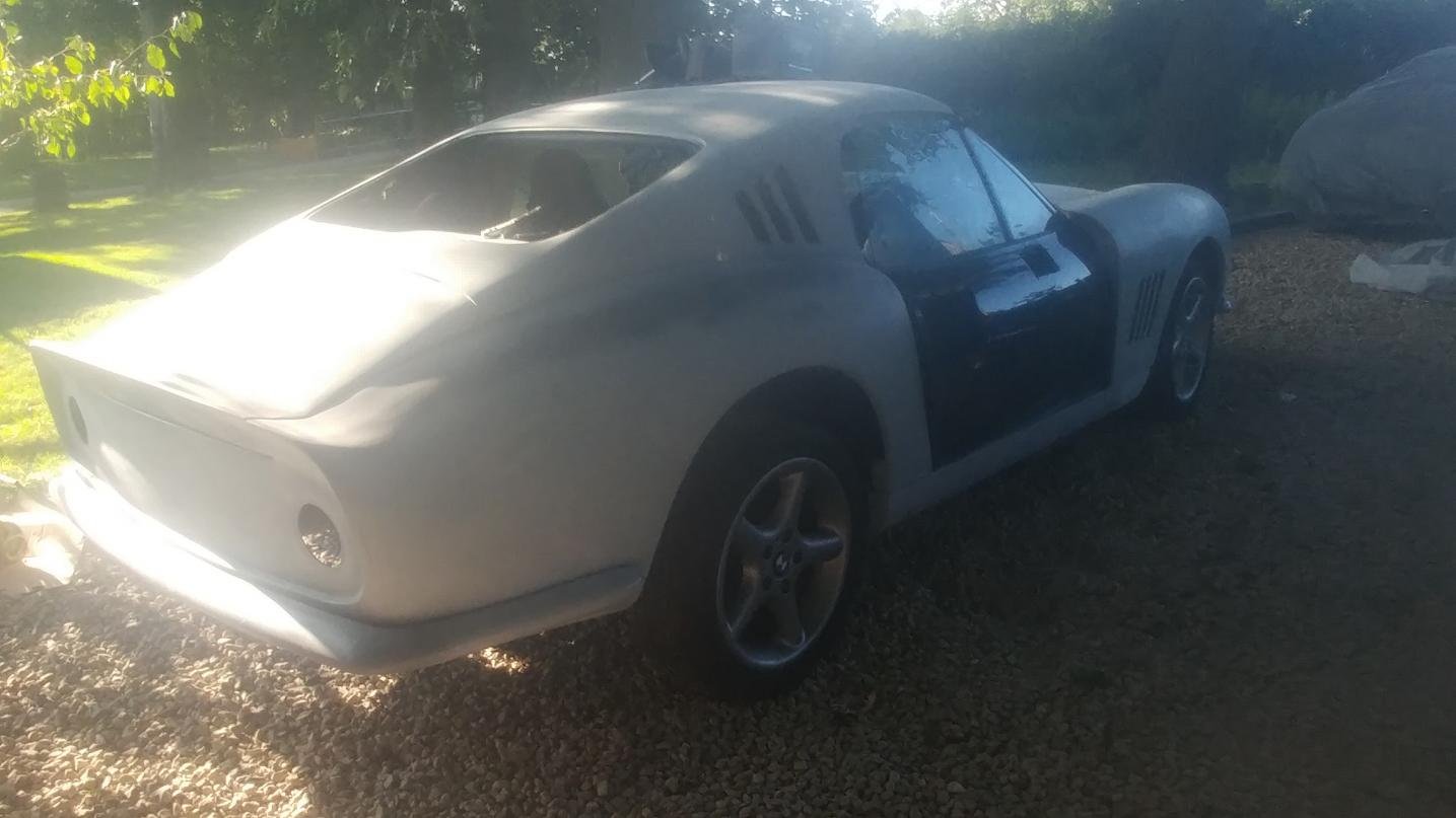

back bumper when bolted together did not sit right but in parts sat pretty good.so I bolted it to the car in parts and glassed the comers and along the back of the car so I can take it off make good and trim all the gaps latter.

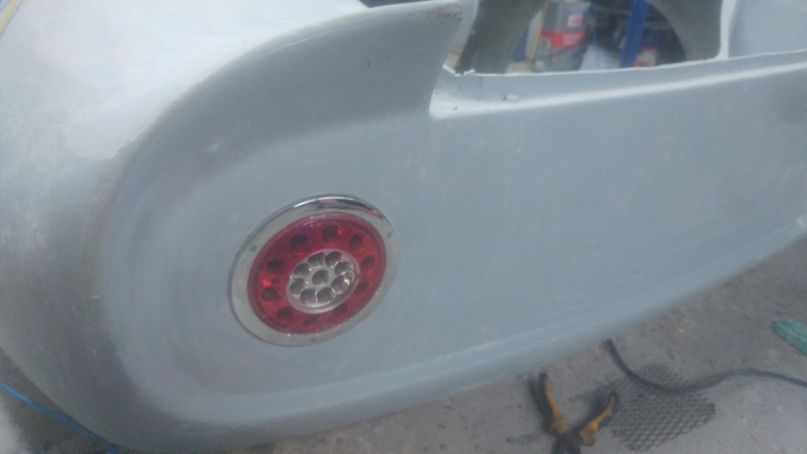

back lights were for an other project a long time ago just so happens they fit the recces so for now I am going to run with these see if they grow on me

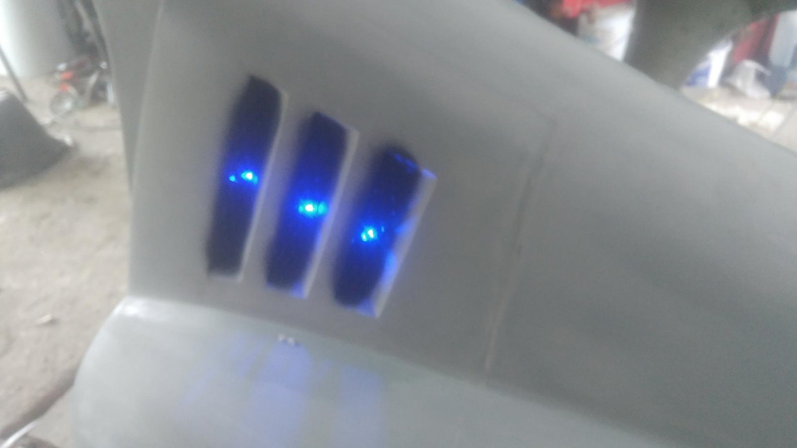

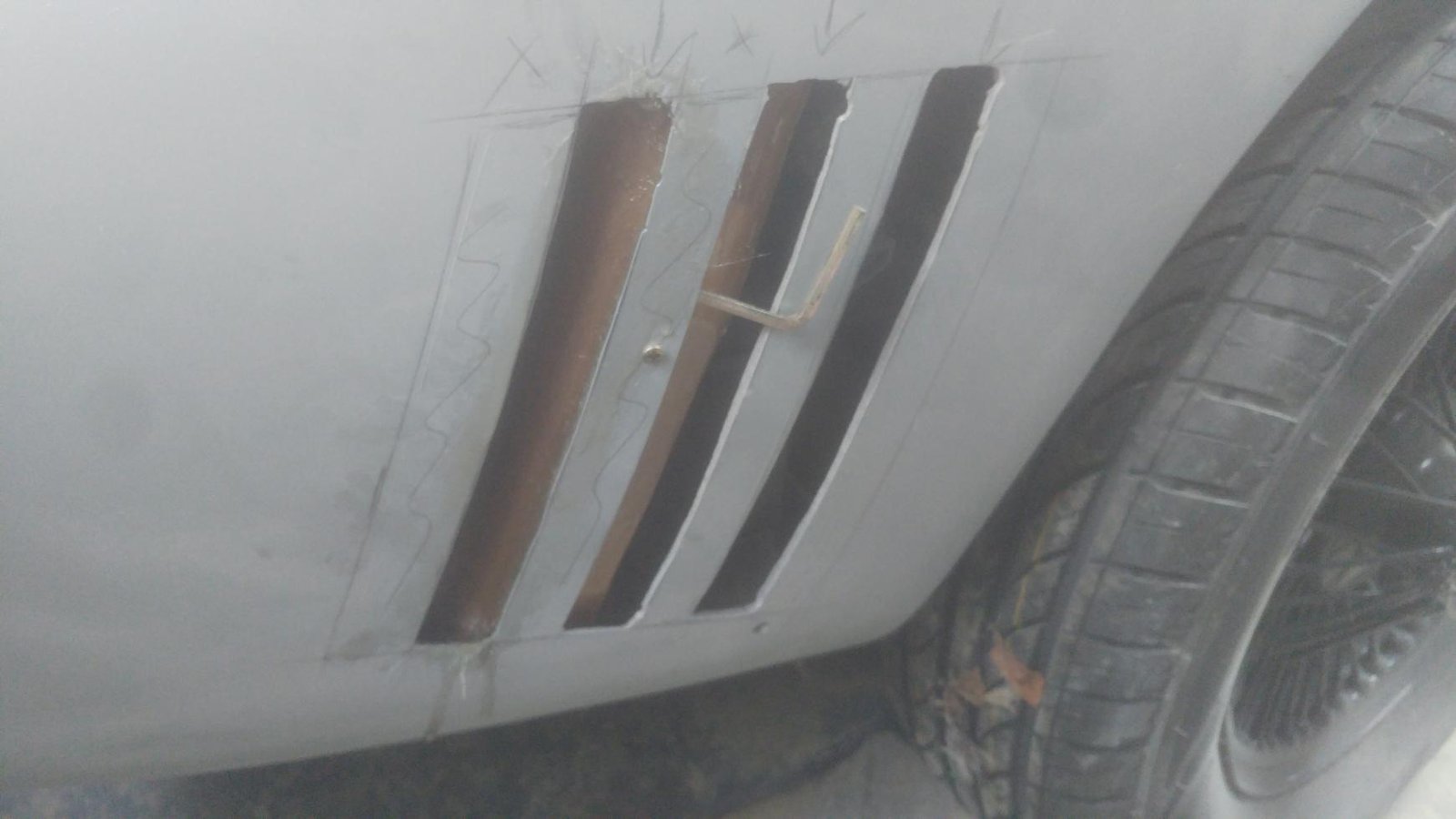

side vents grills fitted in and glassed them from the back fitted some L E D lights for a bit of bling

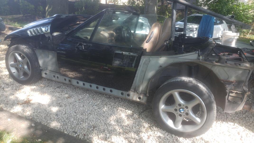

31 Aug 2019, 8:07pm

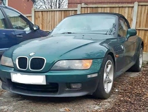

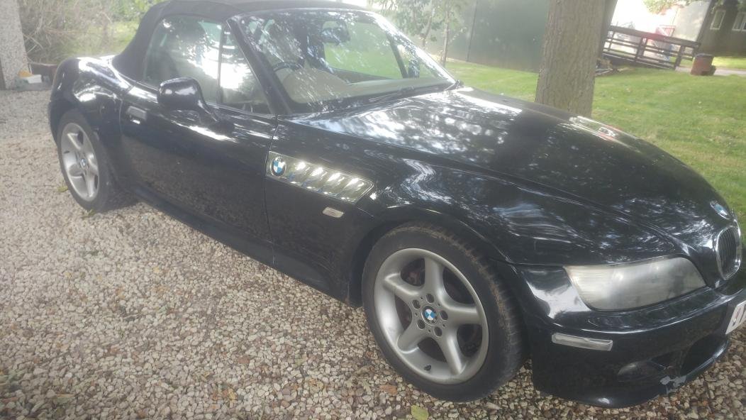

Well back off my hols so must be time to get stuck in, bought a 2.2 car last Saturday while still on holiday ebay dont tell the wife lol. had it delivered Wednesday mot Friday stripped it Saturday today and started getting the kit on today . one good thing about doing so many its like clock work all in a days work thanks to Chris and Dans . I am knackered but worth it love the shape of the 275 it must be beer o'clock

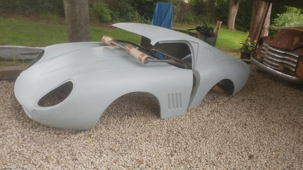

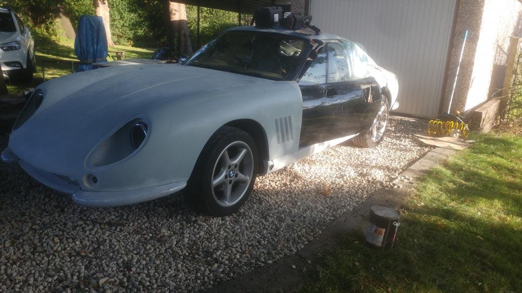

Well we did not go to the van this weekend so car time , typical of me spending 2 days getting the bumpers to sit and look good they are now coming off the car after seeing this.
Attachment “rm_1965ferrari275b_c_lemansspeciale_007.jpg” from the original forum could not be reliably recovered.
bing bong
so here we go before
work in progress
almost there
still needs some work but getting there

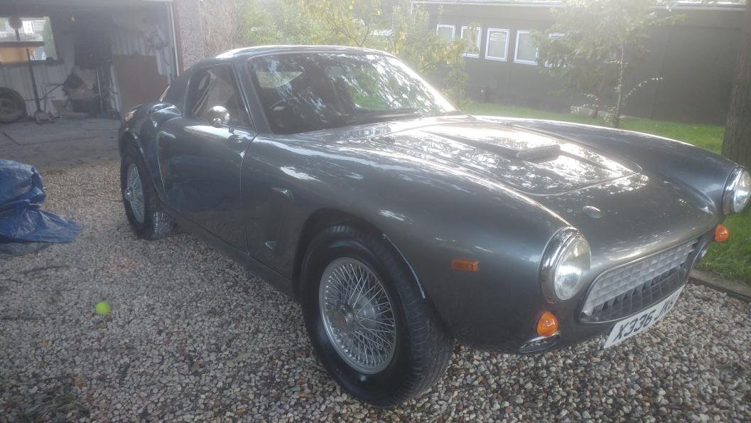

I need to think about ware to put a side repeater if at all you can now see the front ones from the side view. Yellow headlight bulbs on order ,black wire wheels going on next week..

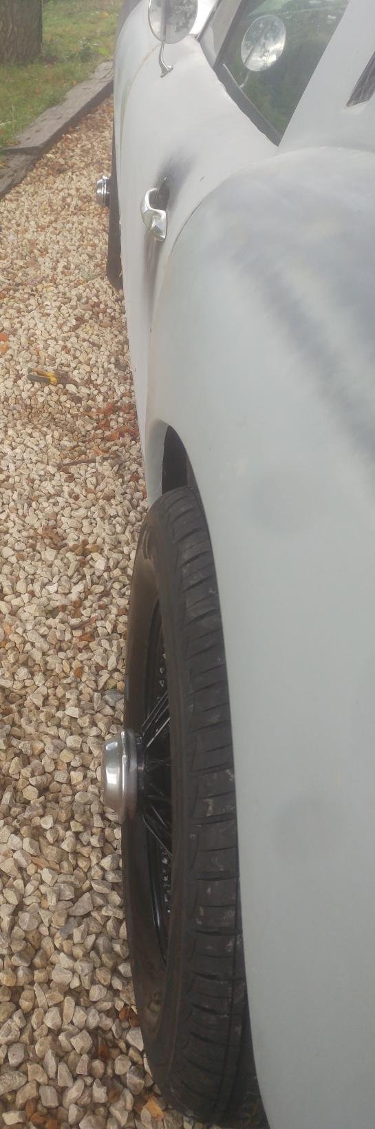

26 Sep 2019, 7:10pm

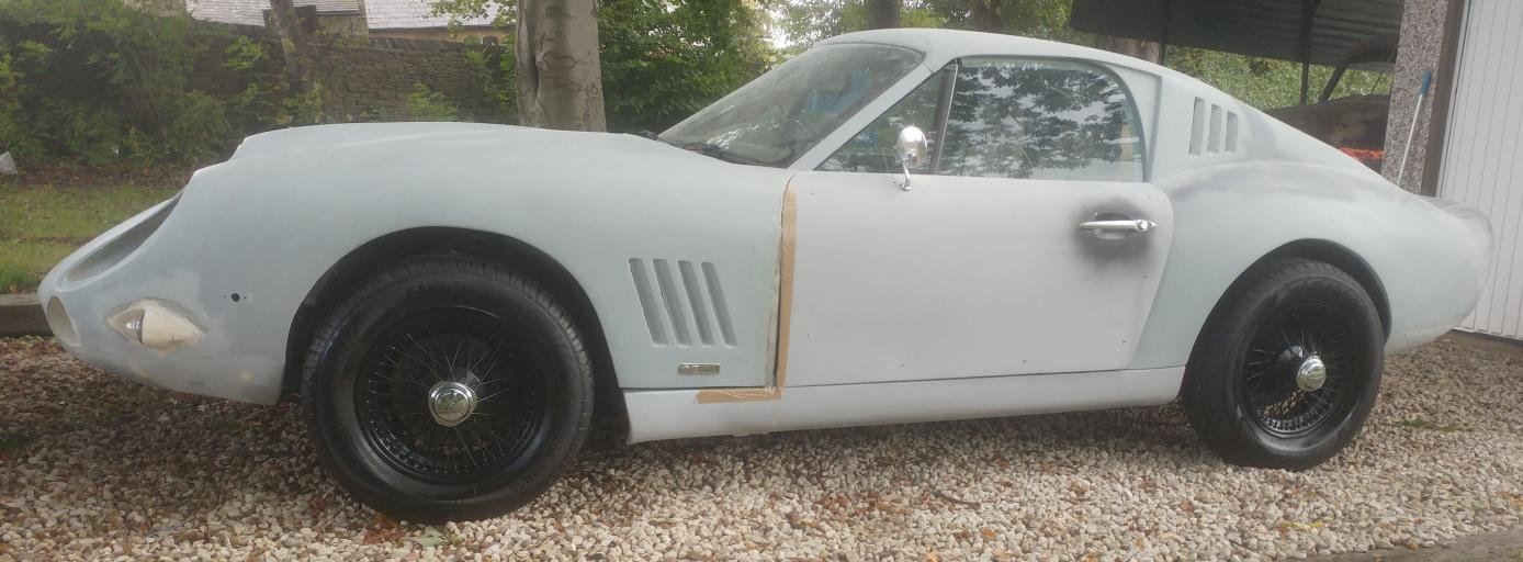

picked up my new wheels had to do a test fit 15mm wider on the back fit a treat
26 Sep 2019, 10:26pm
Are you going to pie cut the rear wings to suit?
27 Sep 2019, 6:57am

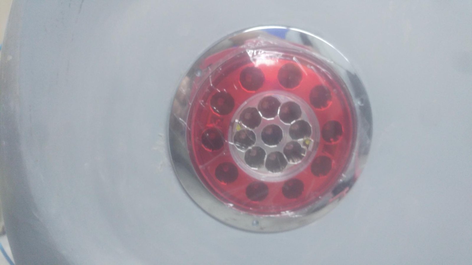

at the mo dont think so but I am doing everything two or three times fit it dont like it so change it. Got a new grill on order this will be my 3rd and hopefully the last change to the bonnet grill. fitted the back lights did not like them so then cut them out to fit the fiat ones 160 quid wow, I will get there. Bought a dash for it but the one in the car is light tan it fits in well with the style but so will the new one when its trimed up but thats a lot of work to sort and something that will only get changed the once honest . unlike everything else lol
29 Sep 2019, 7:58pm

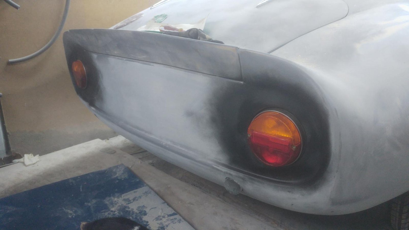

quick update backlight pods glassed in and fitted

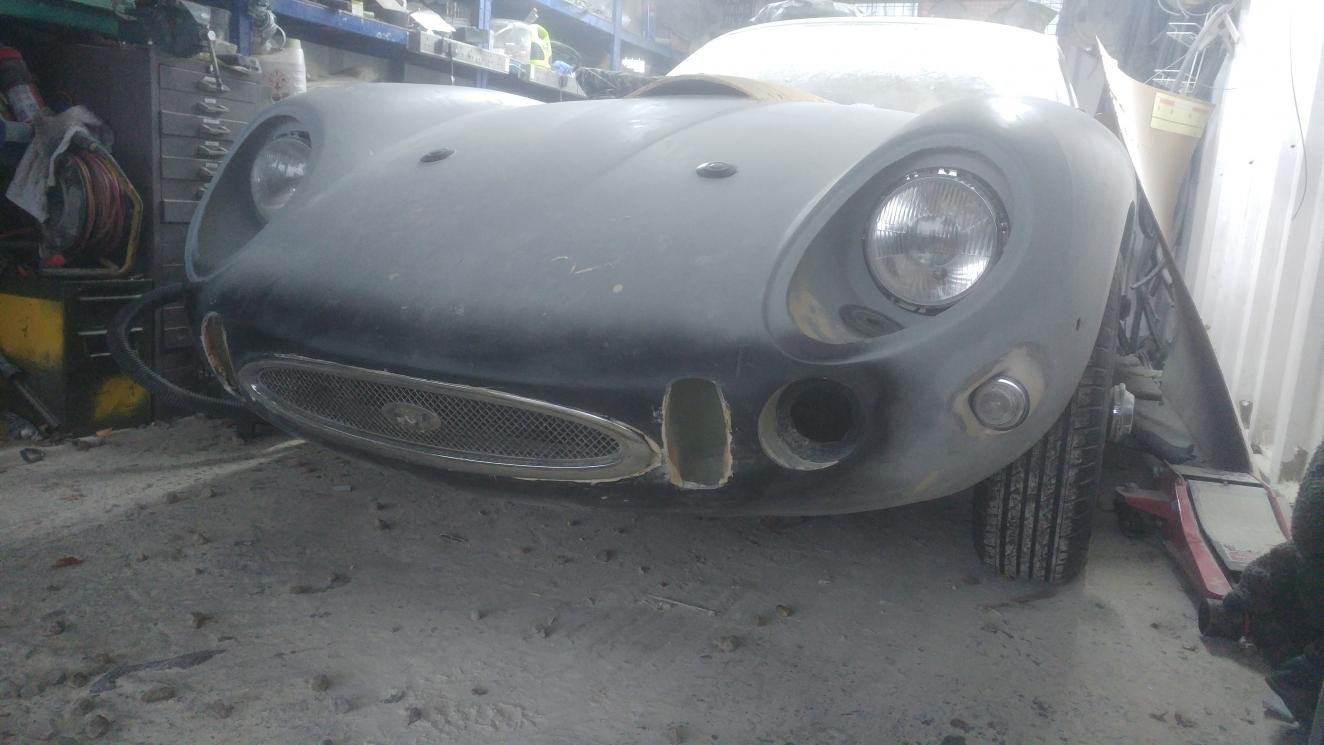

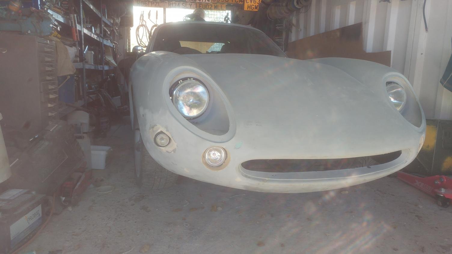

new grill araived and fitted looking at it from the front the spotlight on the left needs turning inwards ,so that will be the next job to cut it out and move it.
not to sure about the shape of the end of the bonnet with the new grill. I need a pair of grills to go each side of the main grill to break it up
it may be the answer to just cut out the sides of the grill to match the car above. one to think about for a few days either way the angle grinder will be out soon :juggle:

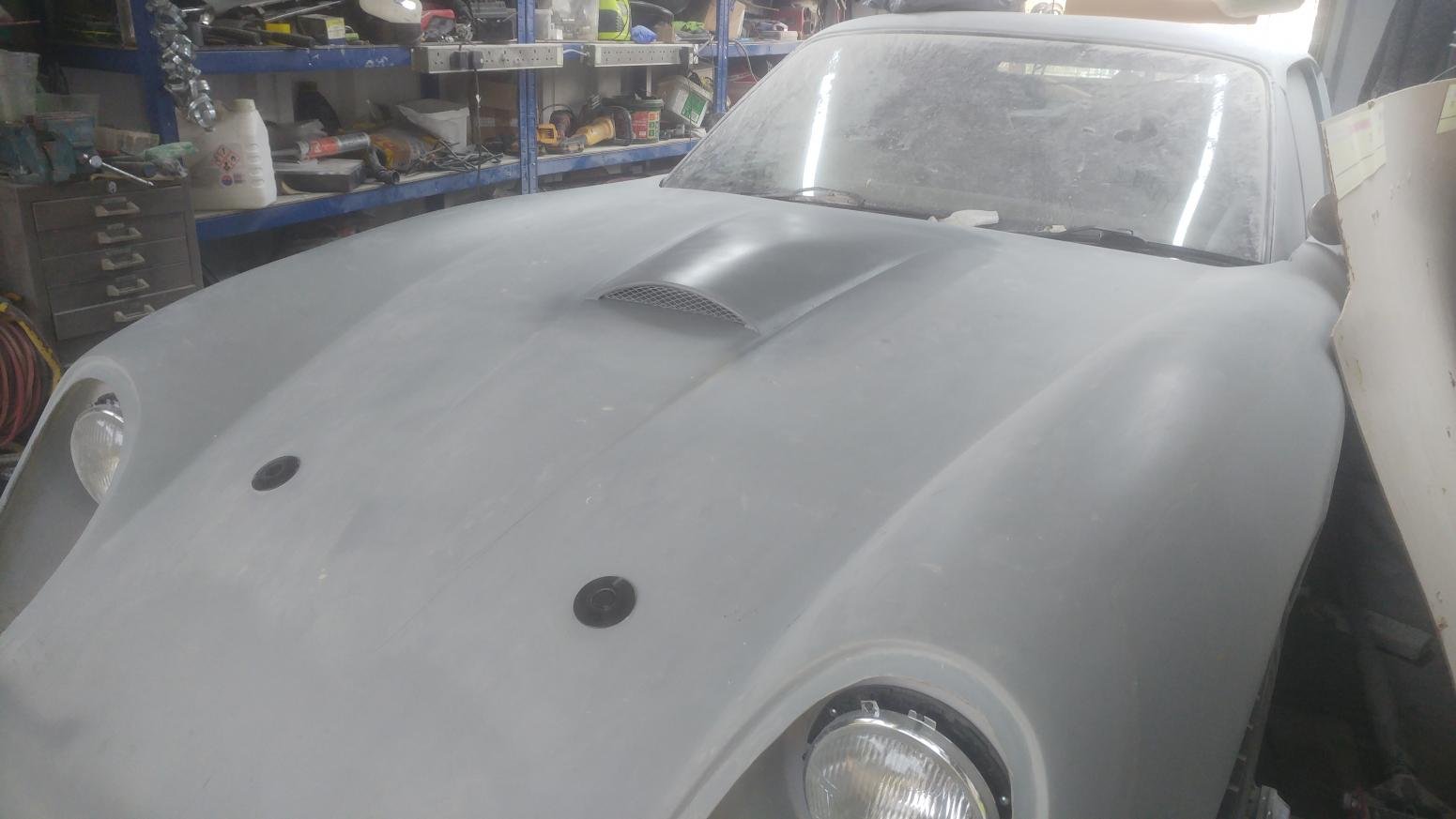

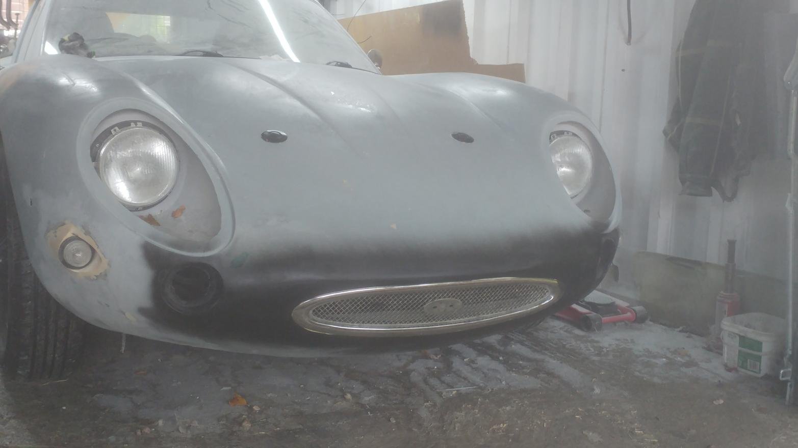

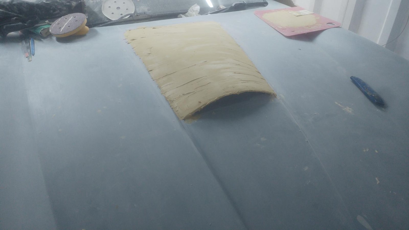

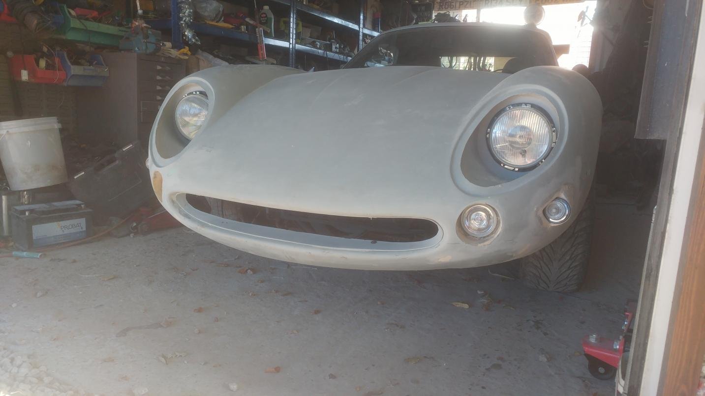

quick update on today's work after measuring 10 times I worked out the grill was an inch to one side so that has been pulled out and glassed back in and the slots have been roughed in each side of the grill,

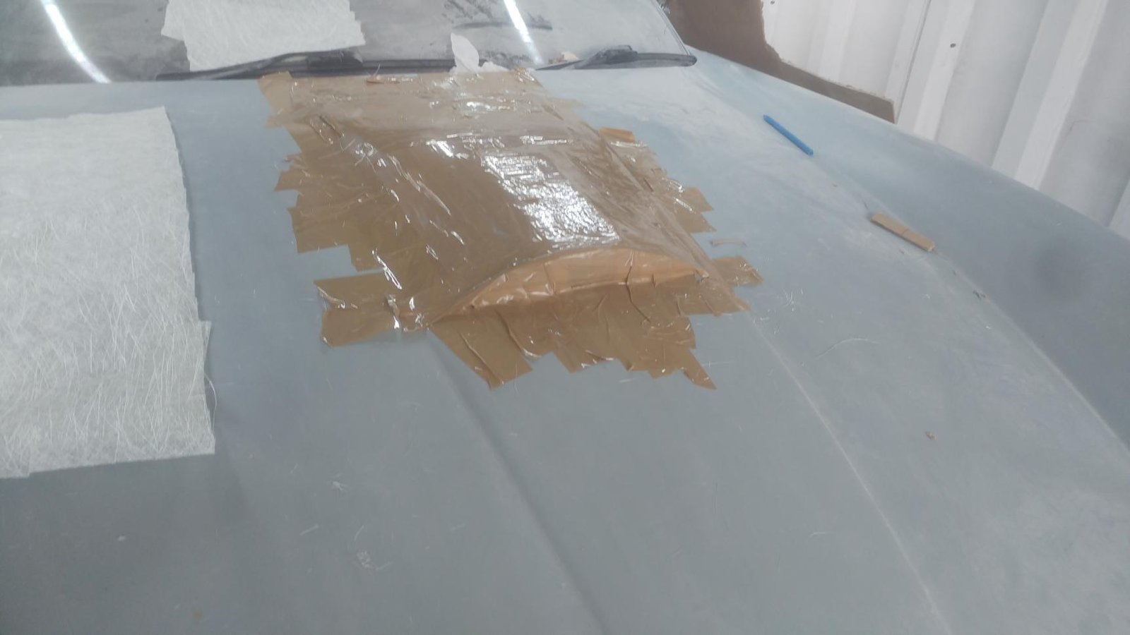

thought it would look good with an air scoop so a bit of card and tape latter came up with this
I glassed over it then when it was dry pulled it of cut it down and glassed it back on minus the cardboard
Attachment “20191005_172418.jpg” from the original forum could not be reliably recovered.
hopefully this should be the last sanding down so I will put a bit of primer on to see how it looks

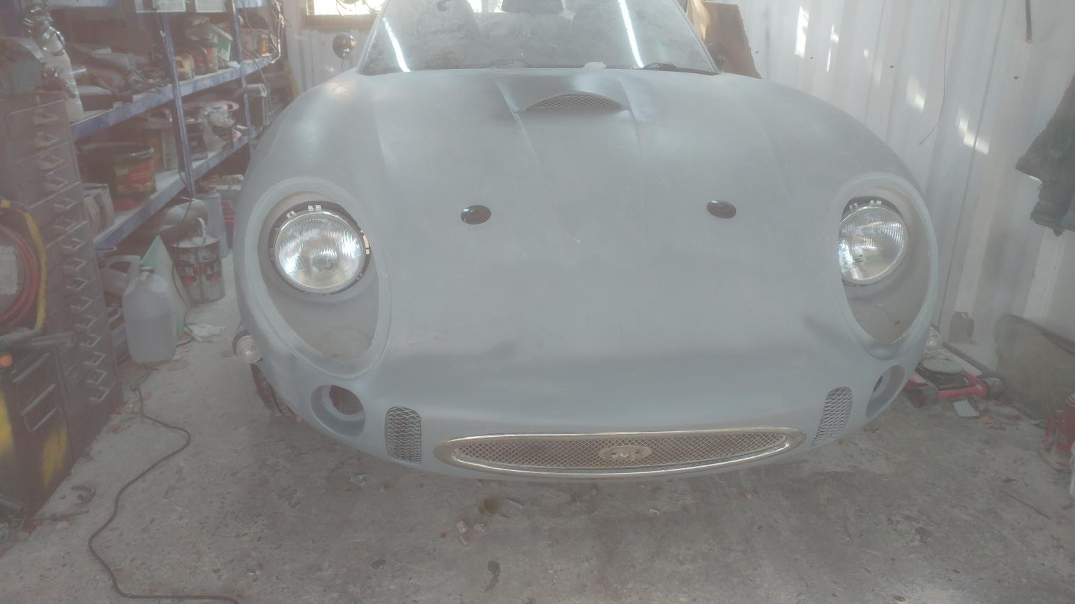

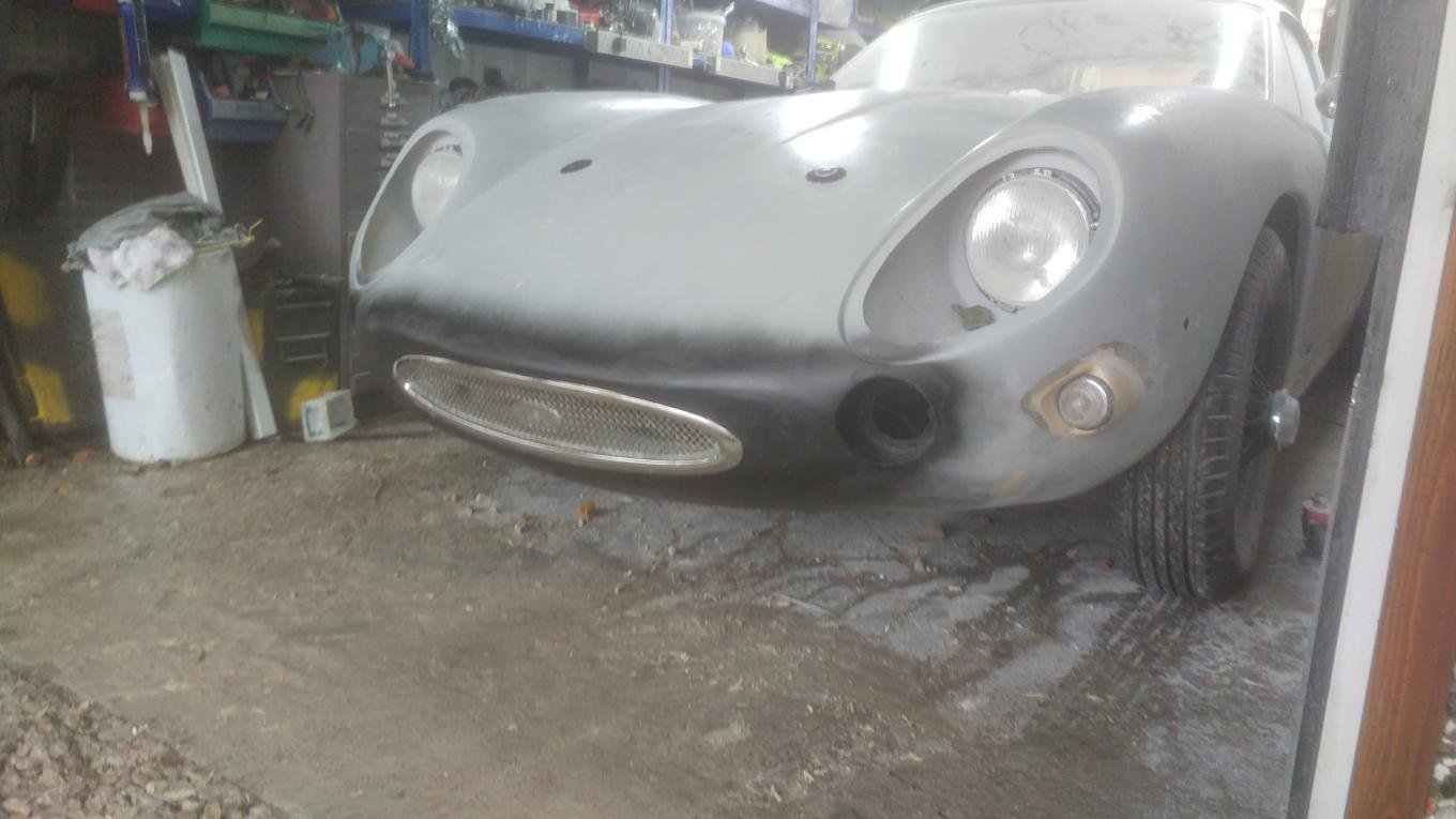

front end is coming together now will just needs fine filling and sanding
I wasn't going to put vents in the rear end but things change lol, I will see how it looks as things progress it can always be filled back in the beauty of fiberglass

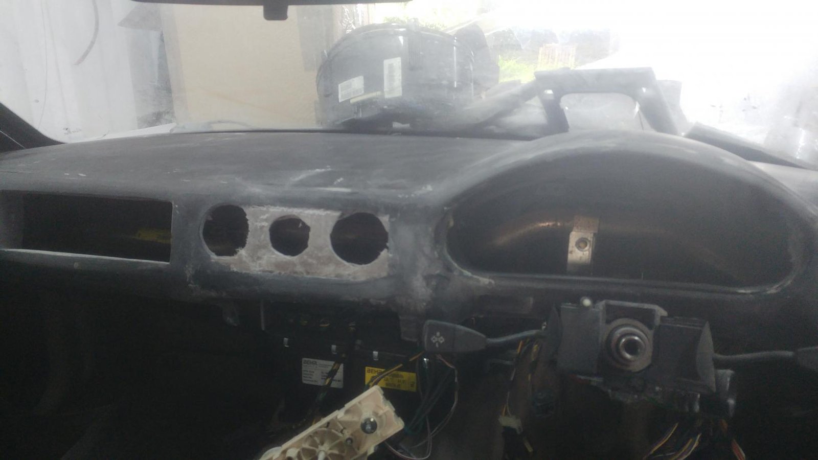

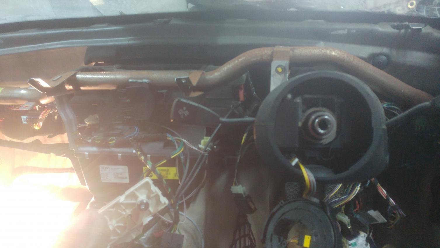

quick update spent most of the weekend removing the dash ready to fit the new one .there is a lot of work in making up the dash the old top under the window screen needs to cutting off the old one and be bonded onto the new one to keep the air vents. also the sides where the dash bolts onto the body also need cut off and bonded on.

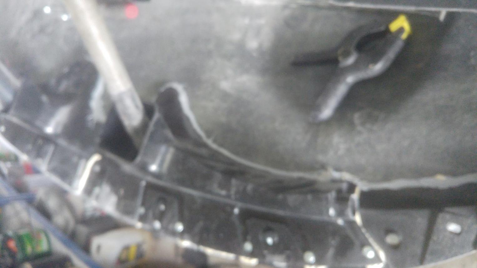

this is a pic is not the best but its of the underside of the new dash with the old vent boneded on
trial fitting of new dash still loads to do i've filled the middle in with a bit of spare fiberglass

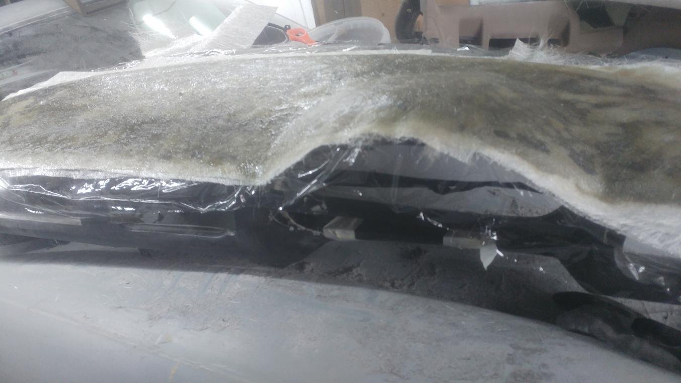

I have taken a mould off the top so I can pad it and cover it in leather then stick it back on when the dash is covered. not pretty but it will do the job when its cut down
this stuff is my savior setts in 5 to 10m mins expands setts like rock and can be sanded back what else do you need from a glue. just run out but 12 tubes on the way.

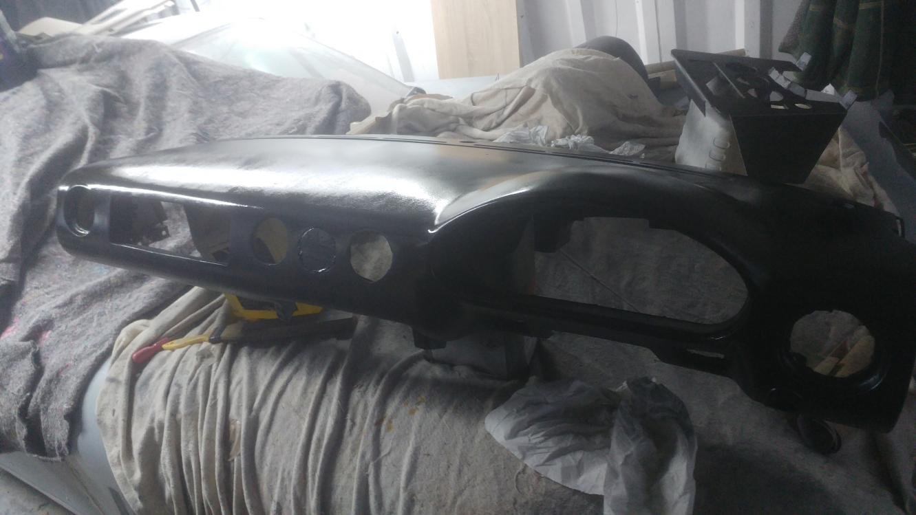

21 Oct 2019, 12:49pm
dash vinyl wrap

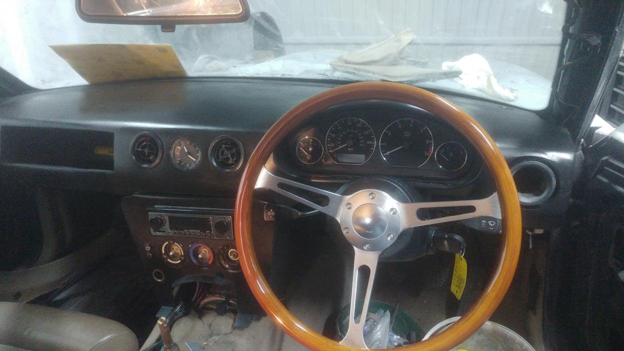

spent 4 hours prepping the dash applied a heat proof glue then wood grain vinyl wrap stood back and looked at it bleeding horrible so off it come again.
striped it again primed and painted satin black if I change the colour again it will be while it's in the car its a pain in the arse to remove and refit
think I can live with it for now still work to do as always but its back in all working
