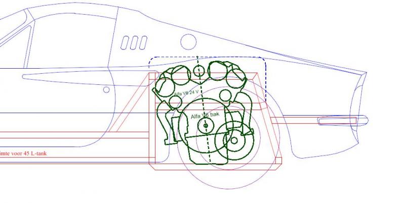

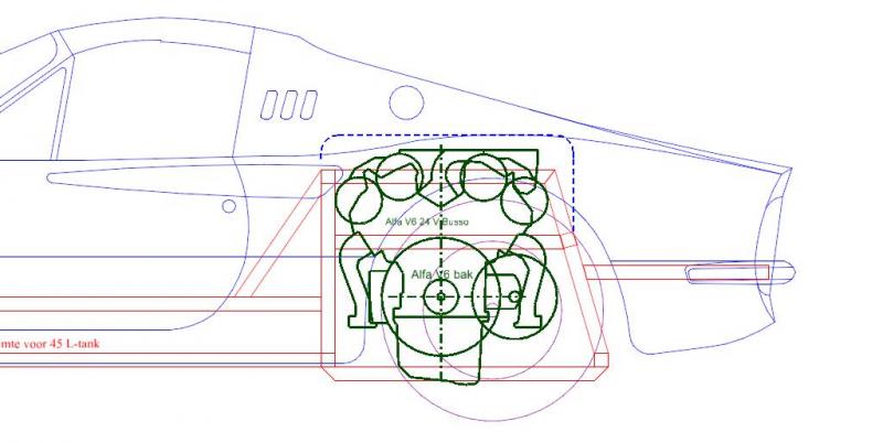

I thought long and hard about an Alfa V6 3.2L 24V, as well as a Jaguar V6 3.0L 24V. Both deliver about 240 HP stock and have aluminum engine blocks. However, when I measured up the engine bay, things became a lot less straightforward. Both engines may fit with some effort, but positioning is far from ideal due to lack of space. Below you can see both engines in the the engine bay:
The Alfa V6 is sitting too high and too far back, placing the driveshafts in an awkward angle, which is not ideal.
The Jaguar V6 is even bulkier, it is sitting at the right height, but too far back, giving the same the driveshaft problems.

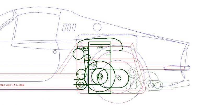

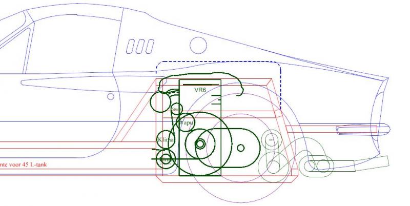

Enter the VW VR6 24V:
You can see that it can be positioned more to the front, giving straight driveshaft angles and moving the center of gravity forward as well.
The VR6 is compact and available from 2.8 to 3.6L, 204 to 300 HP stock. It is not a very sporty engine, it is quite undersquare and the internals are quite heavy. I hope to find a 3.6L version, giving between 260 and 280 HP and less undersquare. Lighter flywheel will hopefully make it more lively too.

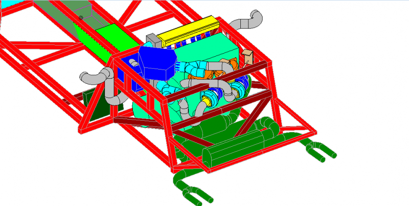

On the plus side, it is very tolerant to turbocharging. As for turbos, the exhaust is at the back, where there is a ample space to place turbos, cats and exhaust, and lots of air around them to get rid of the heat. Due to the Max Power brigade turboing their Golf VR6's, there is a lot of experience and parts available in this department. I am thinking 400 to 450 HP in a twin turbo setup, to keep engine response and drivability as good as possible. This can be done without enhancing engine internals.
See below for a 3D pic of the setup:

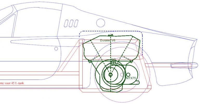

Thanks Ross. To be honest, I have no measurements of the Alfa V6 & box. I just based the drawings on various photos, while using the bore size and oil filter diameter as references. Apart from that, some incomplete CAD drawings from sources you have found yourself already. Sadly, most of the photos are taken from an angle. As such, it is certainly not completely accurate, but a good indicator nevertheless. I have updated the drawing with the additional info I found.
PLUS, apparently the gearbox places the engine in a tilted position. The new drawing represents both:
This gives a better position, although the driveshafts are still at an angle.
The Duratec/Jaguar V6 drawing is pretty reliable (based on Ford drawings). As it is considerable bigger than the Busso V6, it is out of the selection.
I also updated the VR6 drawing to be more accurate:
Still the best position, although the driveshafts make a very small angle.
CG wise, it could be on par with the Busso: it can be placed further forward, but the VR6 is some 40 kg heavier.

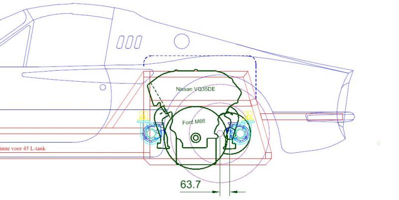

Don't know yet. To complicate matters further, there is also the Nissan VQ35DE: High revving, strong internals (turbo) and light. On the other hand, slightly bigger than the Busso. Available from the likes of Renault Espace, Vel Satis, or Nissan Murano.

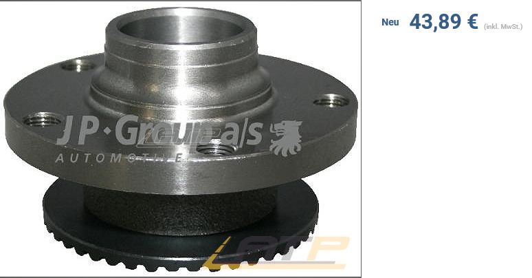

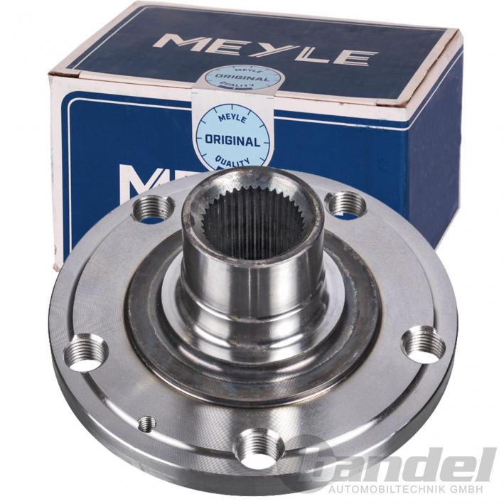

As for the Audi 100 C4 & A6 C4 hubs, they have a 57.1 mm center bore, so you even need to add a spacer 57.1x58.1 mm diameter to reach the 58.1 mm center bore of the Cromodora replicas.
But you're right as for the Ford/Jag hubs, Center bore is a massive 63.4 mm.

Kai, are there versions of the Audi C4 A6 hubs that are 108 x 5 instead of the usual 112mm. Or are you going to redial the hubs?
No, they are all 5x112 mm. But you can either redrill & tap them to 5x108, or remain 5x112 mm and use adaptation wheelbolts which can compensate for 2 mm offset/piece (3 euro/piece).

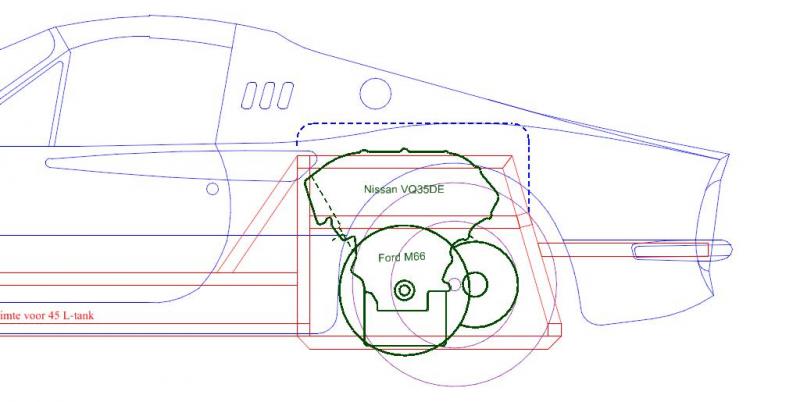

See below for an estimate of the Nissan VQ35DE. Estimate because of the fact that I could not find sufficiently reliable data.
Again, engine & box are quite far back, resulting in a driveshaft angle of ca. 10 degrees. Not exactly ideal from an engineering perspective. There are CV joints with a maximum running angle (permanently) of 10 degrees and more, so it should be doable. Downsides are more vibrations, more friction and lower CV life. Last one is not that important for me.
Ciao, Kai

Have to cut up the car anyway because I do not fit in. But that is approx. in the middle of the door, where all body lines are more or less straight, so rather easy to extend. At the engine bay it's a completely different story, with a lot of sloping & curved lines.
Looking at the options, I still favour the VR6. VQ35 and Busso do fit acceptably in N/A form, but when the turbos are added space becomes a lot more dire:
(VQ35DE with turbos roughly at the position of commercially available turbo turbo manifolds).
Ciao, Kai
