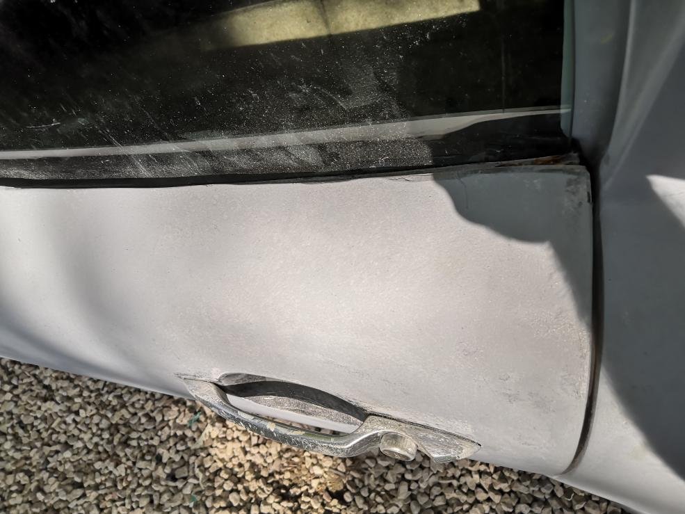

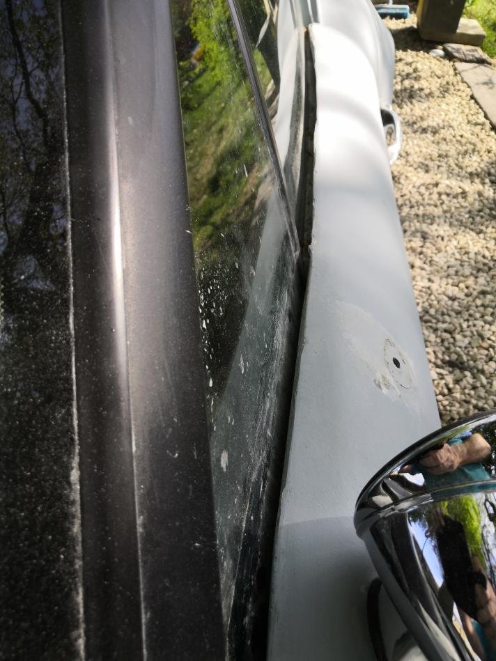

what are people using to give a good finish on the door where it meets the window edge. its proper wonky on mine so I need some sort of a trim to tidy it up a we bit.

On my Z75 I used a piece of 16mm half round section aluminium strip. I curved it slightly to follow the window shape and notched out around the quarter window upright. The trim was bonded in place with PU adhesive after paint.
I used the same 16mm profile to make the windscreen trim all the way round. Looks good and easy to work with.
