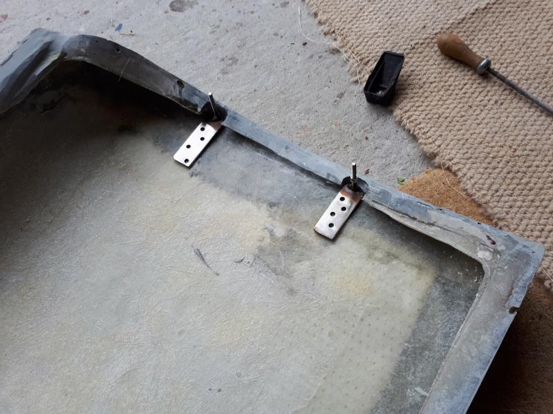

To straighten out the bonnet, I secured six M8 bolts to its underside, each welded to a metal plate glasses onto the bonnet, with four at the corners and the other two half way along the edges of the bonnet. These pass through the sill. Nuts sit above the sill and below it. That way I could adjust the level of the bonnet and so persuade it into the right shape. Sorry, no pics of these bits!
