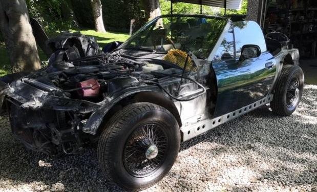

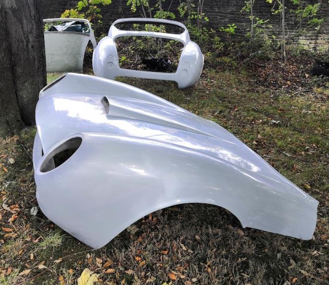

so not been on the tribute page for a while been plodding on with other builds but my kit arrived thursday so I dropped my other builds to make the most of the weather.
car was already stripped so good start

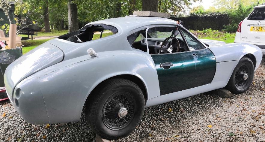

half day fridays so got stuck in

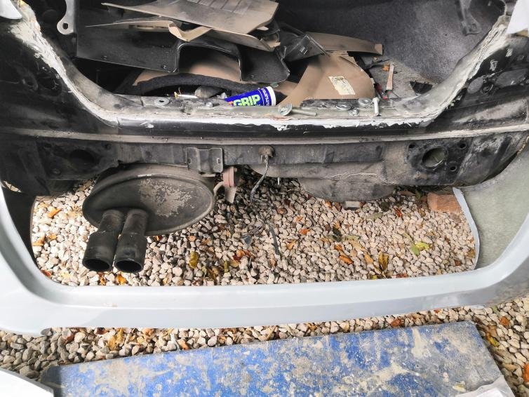

anyone spot a problem lol
11 Oct 2020, 5:56pm

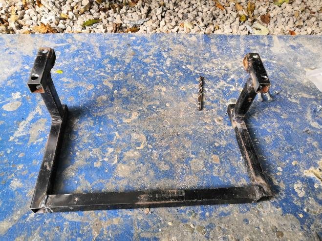

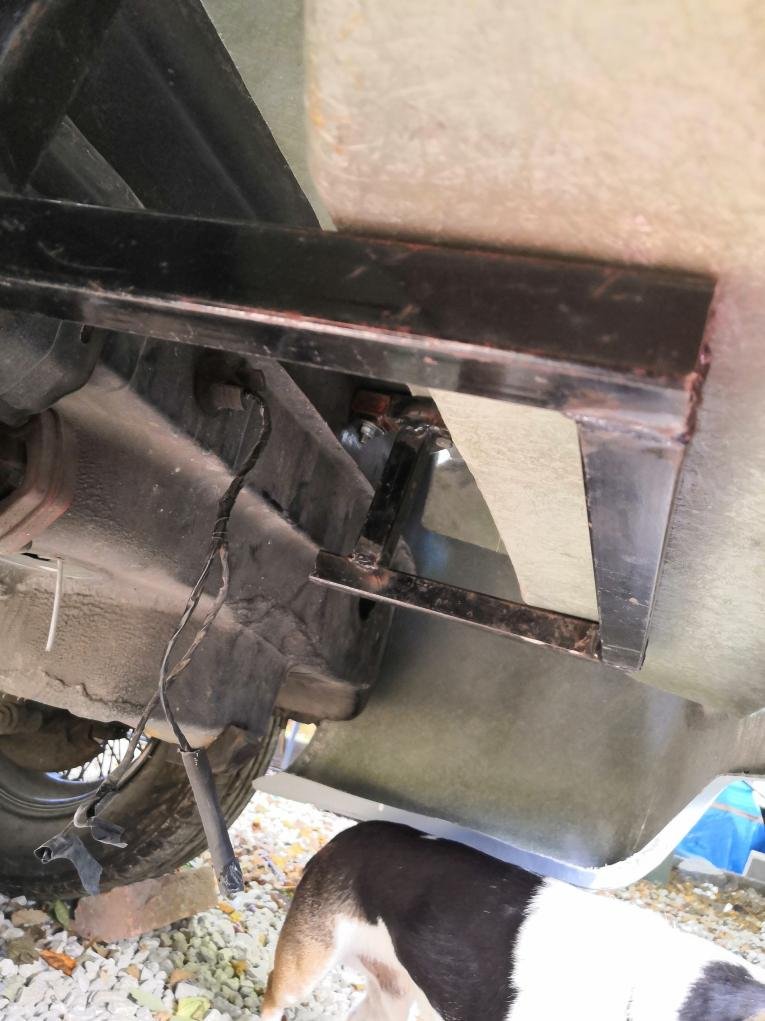

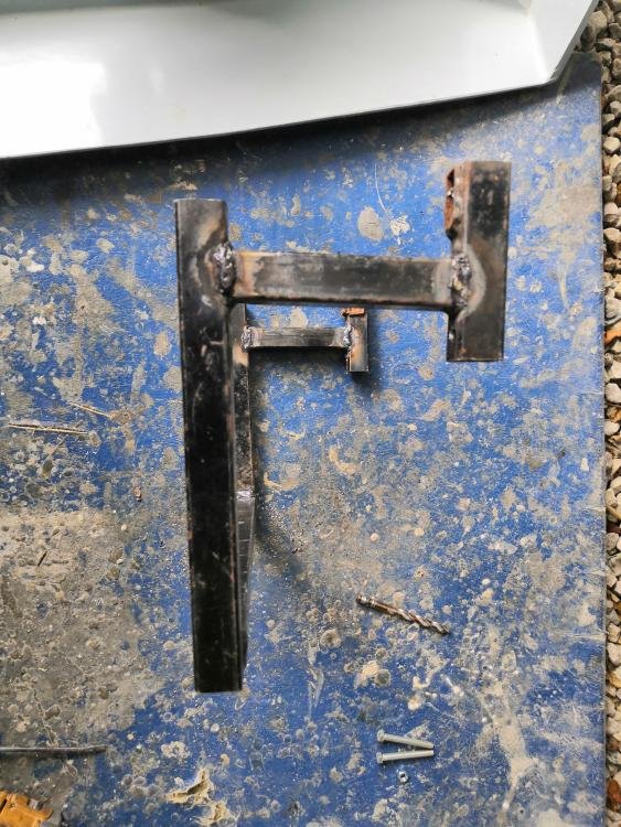

Yep deffo a problem I removed a binned the rear bumper bar for another kit so nothing to support the rear of the kit. I could not get it to sit right so I bonded just the front on the top of the window screen. Once it was set I came up with this for the rear end
works a treat holds in good and tight and all now lines up now its all on I have gone round it with PU 18 so it should not move.

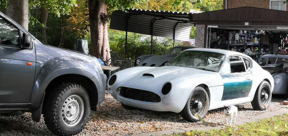

could relay do with a longer drive or selling some cars, nope longer drive lol
12 Oct 2020, 2:44pm
Ha ha Longer drive
forgot about your other build tucked around the side
Been following the 356 build
On this one The wires really suit that In black
What’s the thoughts on body colour ?
Do they really go together that quick? (Coming from someone who has never done one )
12 Oct 2020, 3:55pm
got to be British racing green ,not sure on other mods its taking a back step at the mo got another project on the go the pickup lol

Probably the same for the hard and soft top versions is that the rear aluminium bumper support beam has to removed and put on upside down. That allows the grp infill panel to sit correctly. Chris happened to mention it in passing when collected my kit. Also keep hold of the boot hinges on the convertible as the kit makes use of them unlike other models before !
