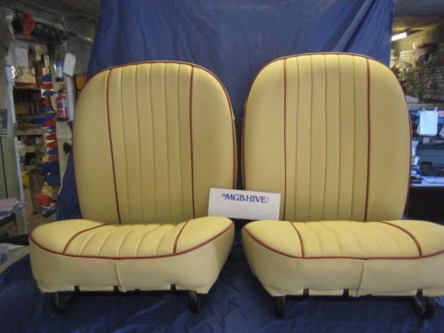

I had decided that MGB seats would fit the bill,
http://i1301.photobucket.com/albums/...ps5542fd99.jpg

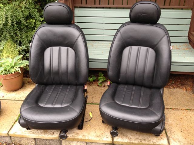

and was surfing for 'MG leather seats' on ebay when I had a moment of inspiration. On finding these Rover 45/MGZS seats it triggered a vague memory of possibly seeing something similar in a 250 SWB.
http://i1301.photobucket.com/albums/...psfc1035d7.jpg

The B seats might fit but I wonder if the squabs of the MG/Rover ones are too high to allow head room?
Good point, they might need a bit of modification to the frame.
Mind you, the Z3 seats aren't exactly compact -
http://i1301.photobucket.com/albums/...ps5e4294a4.jpg
Compared to -
http://i1301.photobucket.com/albums/...pseeb509e2.jpg
The Rover seats might even be a bit lower...
y cymro 19th October 2014 20:45
I didn't realise the z3 seats were that tall as the driving position feels low. Though I when I removed one from the car because the electric drive motor jammed I notice it must weigh about 40kgs.
Good find on the MG ones.

I measured a pair of MG/Rover seats at yesterday's Restoration Show and think they'll be too wide for a Z3 - though it was a rough and ready measurement. Whereas on the Z3 the rear of the backrest is tapered to be narrower than the front face, on the MG its wider. The front face is about 15mm wider than the Z3 whilst the rear face is more than 40mm wider. I suppose you may get away with it if you sit close to the steering wheel and don't push the seat far back.
Interesting, were they this type you measured?
40mm wider at the back is only four fifths of an inch to find each side. Once I've purchased a donor (don't hold your breath) a bit of clearance measuring will tell me if I can get away with fitting budget leather seats.
