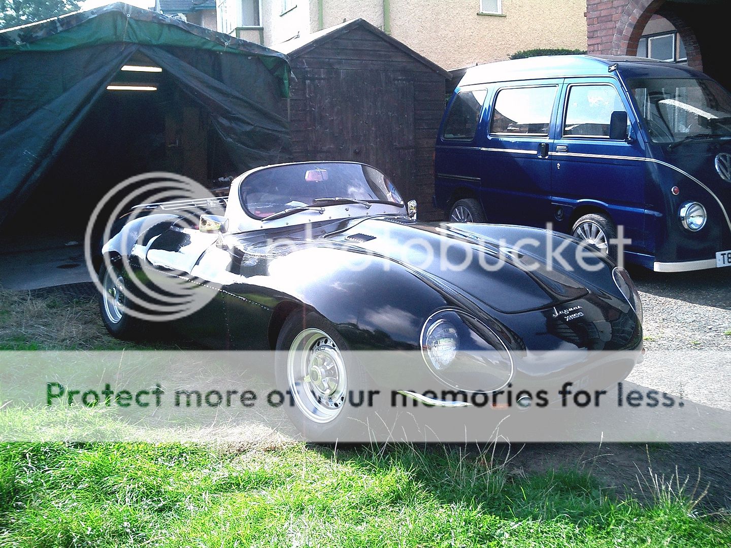

QUOTE=Scottie22;86866]Well obr, it is and it isn't!
When I put it to bed for the winter, it was suffering from an overheating problem, and having spent two years building it, and then have the head gasket go and the subsequent strip-down, rebuild etc etc, (which was made much more difficult because I had opted for the non-flip front), I just did not have the heart to start all over again.
So at the present time, it is till waiting for me to sort it out.
Now that the better weather is coming, hopefully I can get stuck in and do it. So will update in due course.
I am most likely going to get a lot of stick for being an idle sod and not working outside during the winter with freezing numb fingers, but I had enough of that over the build period!
So that explains why there has been no updates, plus the fact that I did start a thread called "Scottie on the road" or something like that, but because I've done bugger-all, that was not updated either!
Here is a pic from happier days:
[IMG] [/IMG][/QUOTE]
