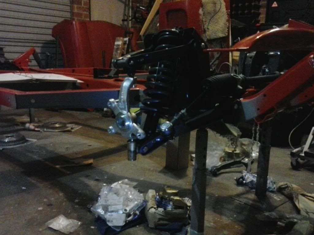

front corner underway.

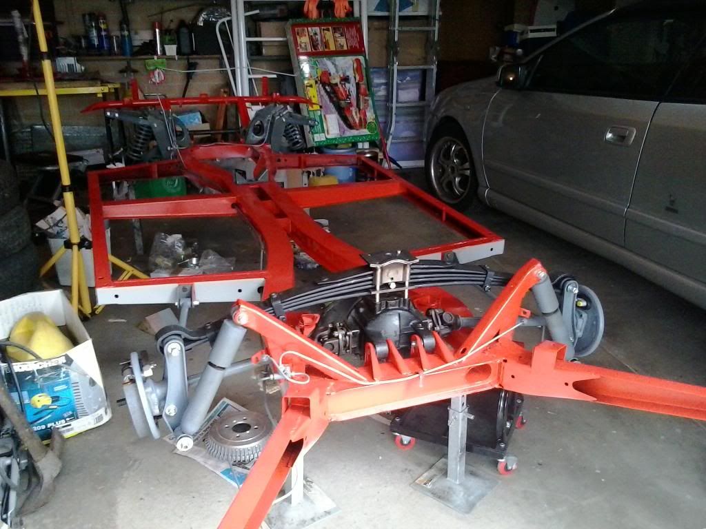

Thanks gents. Here's a pic of my rear, prior to tying down the spring
snigger....
5th May 2014, 19:42
Posts: 839
Nice work 1iTim, i hope to be at that stage pretty soon, the finned drum will look cool on the car.

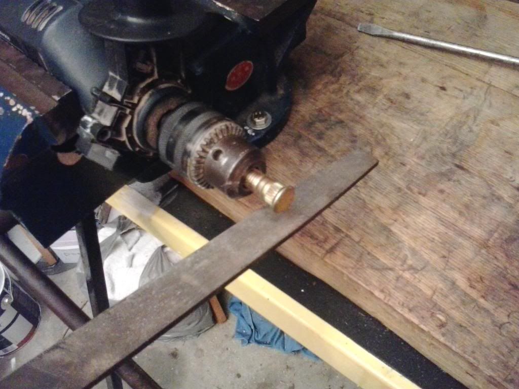

My lathe...
15th May 2014, 14:57
We buy from the same tool shop. That is how I did my lugs. It worked just fine and was quicker than I'd anticipated.
