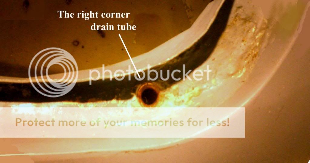

Drain your boot for £7.24
So- the big question I had for Chris at the weekend was... how to drain the boot lid channel and keep the boot dry? I've not sealed round the boot aperture channel yet and periodically have to dry out the battery tray area. then apply some WD40 until the next time.
Well here's the answer:
The £7.24 in the title refers to the price of 10of 15mm Tube Supports and 2m matching pipe from B&Q in the plumbing section.
How to: locate the widest area of the channel in the rear corner of the aperture- you can check this out from underneath against the light. The old rear light panel obscures most of the channel but in the corners there is room to drill large enough holes.
Before:
Once the hole is drilled and made large enough for the support, countersink it carefully to get the lip as deep as possible into the hole without it falling through. Then cut a length of pipe to suit. I angle-cut the lower end to maximise the exit area- it sits on the inside of the rear apron just below the rear lights. Feed the pipe through the vacant rear light hole in the rear panel keeping a loop of wire on it so that you can manoeuvre it easily to be under the hole you've made. Then push the tube support into it.
That gives you the dry fit.
And it looks like this:
Remove it all, apply the sealant of choice to the hole in the channel and to the end of the pipe and re-assemble.
My sealant of choice is Sikaflex (or Tiger Seal) but I use so little at a time, I end up wasting half a tube because it goes off. Any tips for stopping it doing that please?
These polyurethane adhesives are cured by atmospheric moisture. I seal the part used tube around the end of the nozzle and at the bottom with clingfilm and masking tape then store it in an airtight container with a tub of the orange self indicating silica gel beads which dry the air inside the container.
I still need to cut a small amount of length off the nozzle if I need to use it a few weeks later.
If not using it for a few months then I replace the nozzle with a new one.
Hope this helps.

Draining
Before:
Would the poly sealants successfully hold and seal the plastic though? Some of the plastics really don't want to stick. Another possibility would be to either get some GRP tube from ECF or other supplier of the correct size for the plumbing tube, and bond the GRP tube in place with resin or specialist bonder for GRP, or ......... Make a female mould of the support 'sleeve', then make your own tube using the female mould. A suitable sized bolt could be incorporated when the final 'tube' is made, or a solid 'peg' made, and then a drainage hole drilled in it (but coat with resin after so no bare GRP fibres to get damaged by water. The main aim being to get a GRP item which will (no question) bond successfully to the GRP, and accept the plumbing tube!

Ever used Tiger Seal ???
These are only drain holes- no pressure.
For plastic-plastic sealing, Osma provide an adhesive.

I've not used Tigerseal, but I have used other polyurethanes, such as Sikaflex and the very reasonably priced Stixall. I'm not sure they will stick to the plastic of the insert - If I have any 'live' stixall I'll try it, as I have some of the inserts.
The osma adhesive is for 'solvent weld' pipe and fittings and works by being VERY volatile and melting the plastics (smells awful) - I'm 99% certain it wouldn't melt the GRP, and therefore wouldn't create a bond with the insert.
I wasn't looking for the ultimate seal with the plastic, very few things do that, but Tiger Seal will support it sufficiently. I'll check out Stixall- interesting name. Yes, Osma is a solvent and wouldn't work on GRP. I might try moulding some GRP pipe myself. It will make it worthwhile mixing up enough resin for that along with other small jobs that need it.

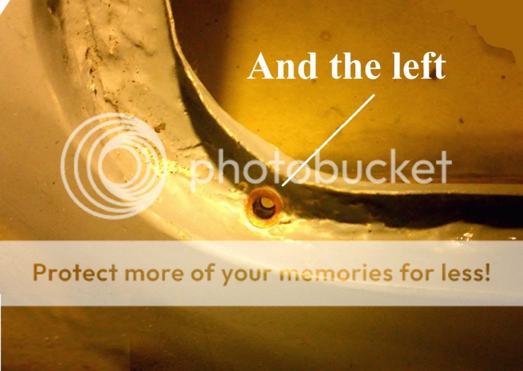

Bootlid drain holes
Don't know if this will be of any help, but way back in the first week of January this year, I finished the drain channels in my boot, and realised I needed drain holes. I discounted plastic as not all adhesives are effective, so I used copper pipe, which worked very well, I stuck the pipes in with araldite, (4 minute setting time, as I have no patience)
Here's what I wrote then:
When I re-designed the boot lid aperture and put the rain channel in place, I was aware that eventually it would need a drain hole each side.
This is a bit obvious, but I had it illustrated to me one day when the cover blew off and it rained ( at that stage the body was outside) the boot had lots of water inside.
Well its done now, I used two lengths of 8mm copper tube, flared the ends and glassed them in.
Rubber pipe will be used to channel the water down through the floor later.
One more time consuming job that had to be done, finished at least,
another 5 thousand to go...........
[IMG] [/IMG]
[IMG] [/IMG]
Hope this helps someone.........
