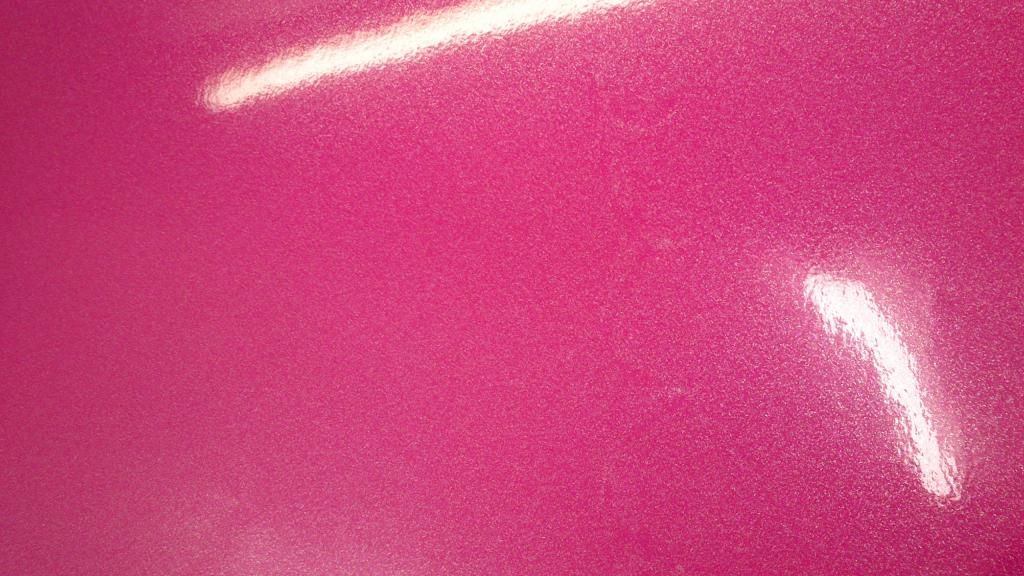

My job for tomorrow is to get the car ready for wrapping,
obviously that will involve removing all the bits ive been working so hard to fit! but it needs to be done to get it right first time.
I have quite a bit of some really good quality metalflake pink sparkle vinyl, left over from a nissan Juke we have just completed but i'm not sure it will bring out the best in the car!

Thanks for the wiper links, will place my order, not sure about the candy pink sparkly wrap though!

decent chromes cost up to £130 a metre, so I doubt I'll be doing that! I already have the vinyl for my car but I'm keeping it under wraps - excuse the pun
Chrome looks great but is a complete b****d to fit as its prone to discoloration when used on tight curves (which the mx250 has loads of!)

Ha ha,
I can safely say it won't be leopard print, I have do have Brown snakeskin, not enough to do an mx250 fortunately!
The vinyl I have is a pearlescent colour, that's all I'm saying

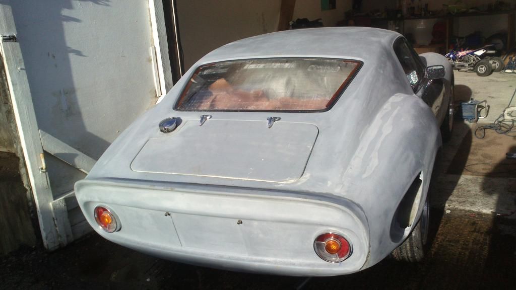

4th February 2014, 20:53
Are you having cut-outs for the exhaust...
4th February 2014, 21:33
Join Date: Nov 2013
Location: essex
Posts: 193
i haven't decided what route i will take for the exhaust, currently it consists of the standard mx-5 box with the tailpipe cut shorter with a 60 degree elbow clamped on to redirect the fumes!
I imagine i'll get a dual exit set up, going to try to avoid cutting out the rear end if possible,
a few people have recomended a custom exhaust shop (pipecraft) near me, i'll probably just hand the car to them and say "make it sound as good as it looks"
4th February 2014, 21:51
It is a very clean look, if its gonna make a nice noise, it might be nice to see where it comes from? maybe tucked away by the rear wheels?
