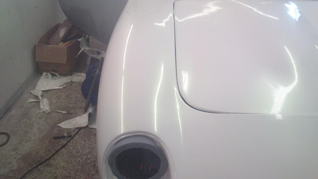

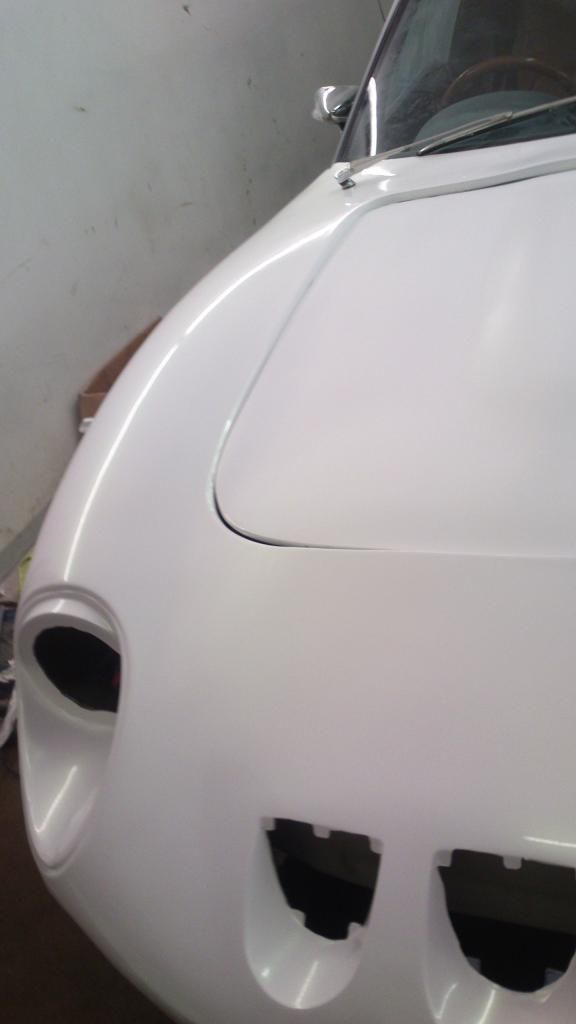

After shed loads of Sanding and filling finally the wrapping has begun!

the colour is a pearlescent white/green, the pictures don't really show off the green effect, hopefully it'll be more apparent when it ventures out into the sunlight!

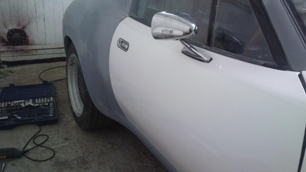

Got my mirrors wired up today (now the doors are finished)
I installed some BMW LED side repeaters into the wing mirrors to save me chopping a hole in the wing/fender sections. really pleased with them!

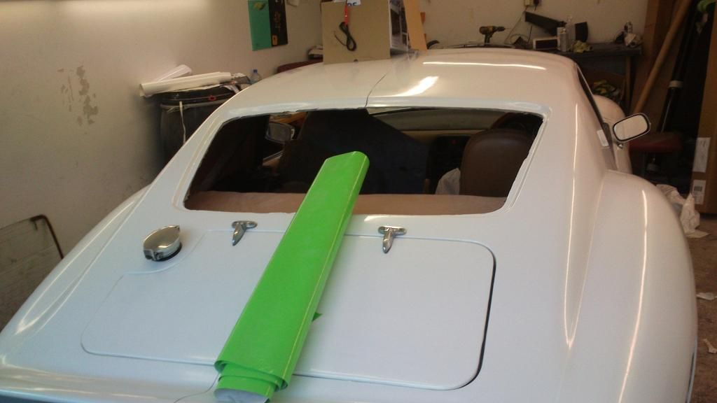

As the vinyl only comes in 1.5m widths it's impossible to wrap an mx250 without a few joins, to keep them to a minimum the whole car was split down the middle, the main join in the centre will be under the stripe so shouldn't be noticeable, the bulbous rear arches were also done separately with a join at the sharp angle in line with the bottom of the Windows, this could have been avoided if the colour I chose was available in air release,
Tomorrow I'll get the rear screen back in and connected up and. Fit the grills,

thats the green that the stripes will be
