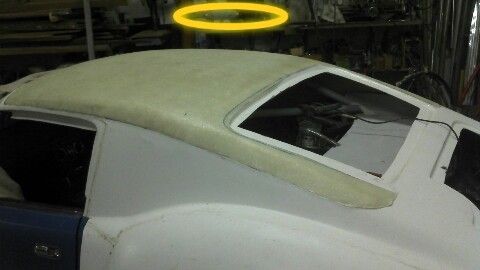

I am about to put together an MX250. My plan for a headlining is to use the roof as a mould, laminate about 4oz of GTP onto it. Once removed, trim, upholster with 5mm foam backed vinyl then insert back under the hard top. Nit sure how it will stay up yet, the roll cage will help. I will make that bit up later.
I dont want to stick straight to the roof as I want an air gap for insulation

Heres my headlining laminated on top of the roof...
[IMG][/IMG]
And nearly trimmed up...[IMG][/IMG]
The sides are flat, so will be 6mm ply or MDF. It will be spaced about 20mm away from the roof so should fit, as the sides are tapered.
All will be covered in 5mm foam backed vinyl.

Very clever! I look forward to the next installment....
