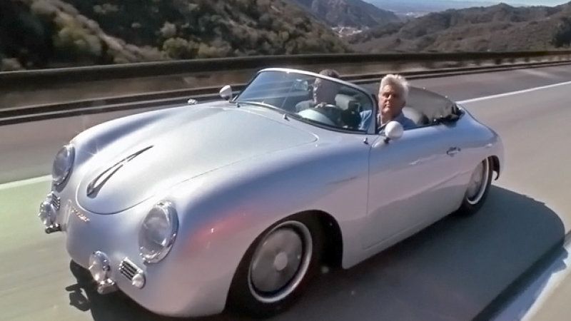

Mr T I saw this and thought of you
Hows the 356 progressing?
I know this is a 550 but it has similar styling cues.
I like the air intake in the lower valance - if you need more cooling for your front mounted rad.
The low profile modern wheels and stance with classic paint and styling, a new twist to the "outlaw" theme

Wow i like the look of that, any interior shots.

Very nice indeed Roadster.
