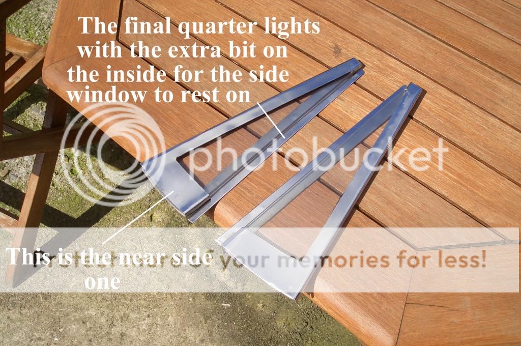

Like most people, I tend to put off crappy jobs, and one of those was finalising the quarter lights. But it had occurred to me that I have to do those, and get them in place on the car BEFORE I can attempt to fit the windows to the doors.

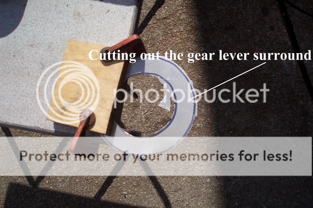

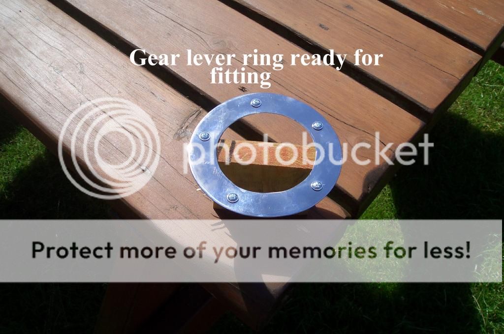

So today I got grip of myself and sorted them out. I had to cut the bits I needed out of stainless sheet, so while I was doing jobs I did'nt like, I cut
out the gear lever and hand brake trim, and finished those off too.

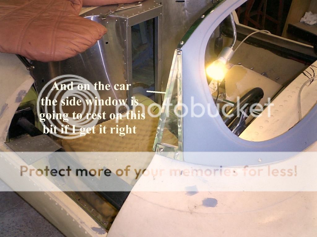

My next job logically, is to bolt the quarter lights to the car and then refit the doors and try to line up my new windows to match the quarter lights in a
neat line.
Mmmmmmmmm.

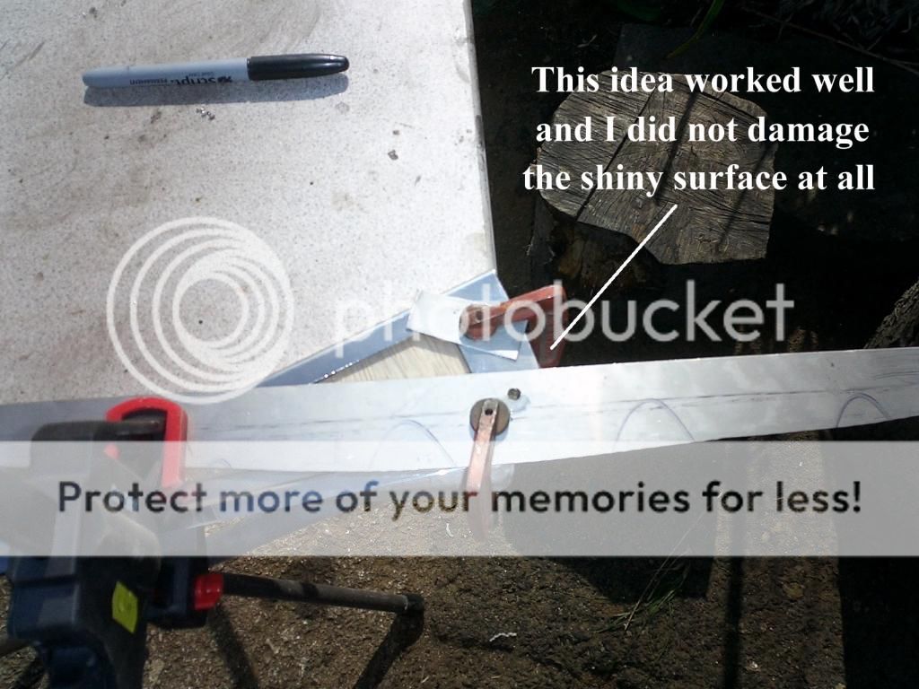

Tuesday

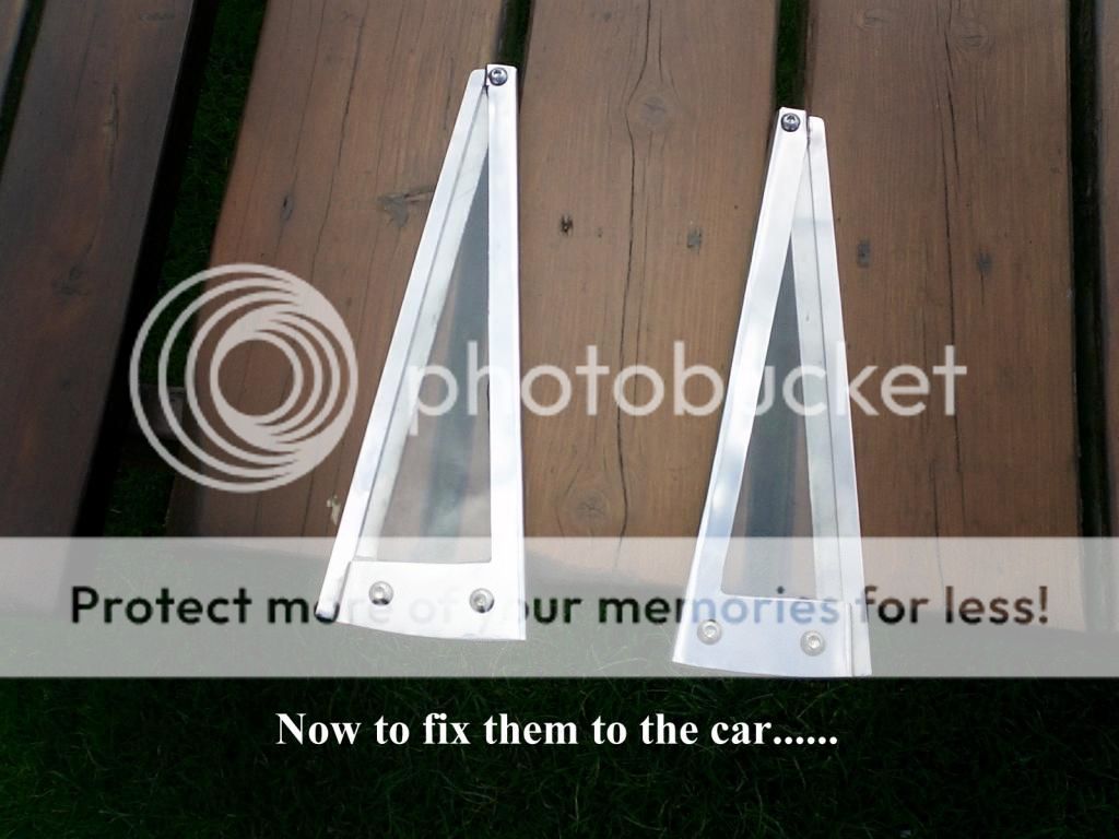

Before I can fit the quarter lights to the car, I have to drill the three bolt holes in each one.
This was a job I dreaded, as drilling holes is one of my weak points.
Even with a punched mark, the drill still seems to skitter all over the place wrecking the surface.
It took me so long to actually make the quarter lights, so I did not want to have to do it again.
Also the they have a back, a front and the lexan in the middle, so I had three bits to line up and hold still before drilling the holes.
My answer was to drill a guide hole in a bit of spare steel, and clamp that over the marker-pen dot, that way, I would not have to risk distortion by punching the metal, and the drill bit had less chance of wandering off target.
It all worked well and I had my neat holes with no drama.
I will use 6mm stainless bolts at the bottom, and 5mm at the top, as 6mm look too butch at the top!
Well they are now on the car, and its gone 3 pm, so that little jobbie has taken me most of the day, and now I've had enough, not to mention only just had my lunch!
Here are some pics:

... I have to drill the three bolt holes in each one.
Even with a punched mark, the drill still seems to skitter all over the place wrecking the surface....
For the best drilling experience, may I suggest a set of cobalt steel drill bits rather than HSS. Reasonably priced sets of re-sharpened ones are available on eBay. The difference is amazing. You can get spiral swarf at low speed on many materials up to cast and mild steel.
Yes you'll still need to centre punch accurately but a small guide hole followed by one of the desired size is easy.
I still use HSS for some larger requirements but for anything up to 8mm, it's cobalt steel bits every time. They don't seem to blunt easily and the cutting power is super
