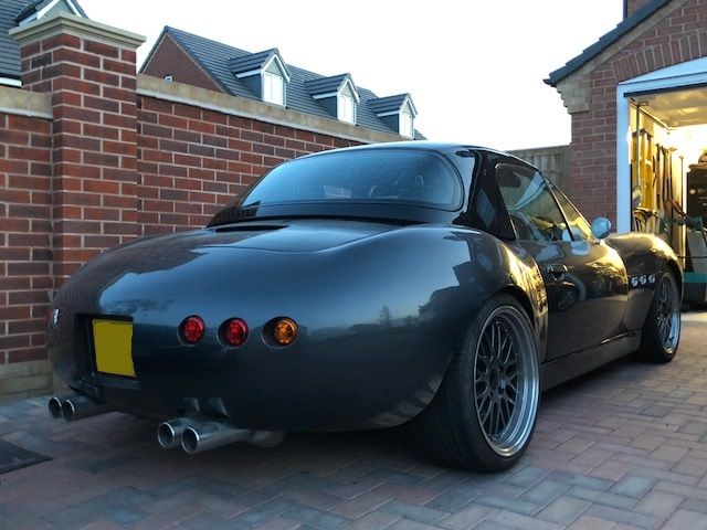

The car now has a hard top so its a little bit quieter for when the weather isn't as good. The car is now supercharged and going in for a remap on Wednesday next week. Hopefully there should be some serious gains on power once the remap has been done.

Then just a photo with the new roof!

Just viewed the pics on my computer screen, wow, great job. I am now wondering if that colour would be better than the green for my Z3gato, it certainly looks the biz. (Especially as I have the same wheels)

A great looking car - can I ask...... what diameter are the rear lights?
16th August 2018, 23:37
Join Date: Nov 2017
Location: Coventry
Posts: 36
The rear lights are 75mm diameter led clusters. They’re meant for a caterham I believe.

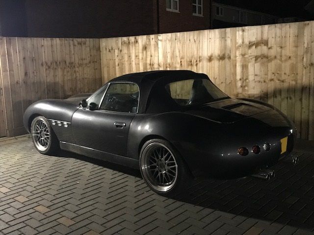

The only recent photo I have is this one:
Excuse the bit of timber... I was adjusting the hand brake at the time so it was to prevent it rolling away!
