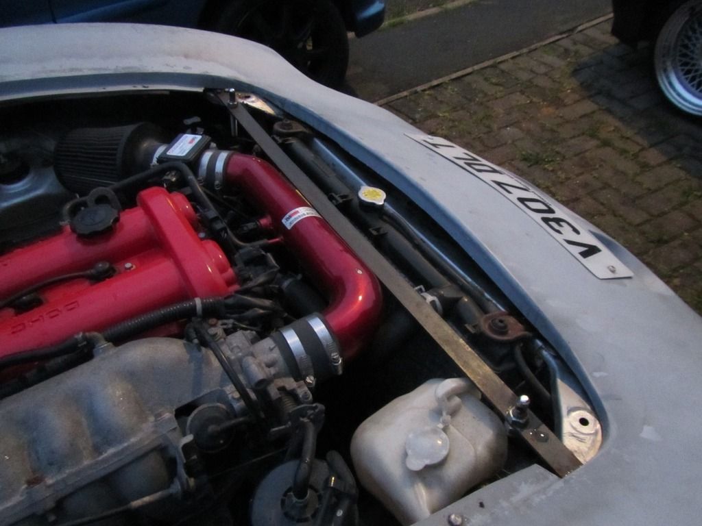

Hi guys. Got a problem I could do with some help on. Has anyone come up against the front end sitting too high on the slam panel?
If so what is the best solution? To cut the slam panel or to cut the GRP in the front corners of the bonnet recess?

for memory the front end is riding high as it's sitting on the headlight frame work ,I took a hammer to mine and flatten them down you can not see them when the fronts on an finished. The door window reveals I bonded a frame in to make a step meaning you then dont need a massive rubber to fill the gap. have a look on my build thread or ask NED for a pic of his to give you a idea. the boot must be the rubber it should not get water in it mine never did . good luck

I had the same problem with the front end and "trimmed" the fiber glass off the kit until it sat properly. I had to take quite a lot off.
The German guys also built theirs on MK2's and cut away the light mounts. I was advised against this but it's an option.
On the rain build up, have you put any drains in?

If you trimmed out the corners, how did you secure the front end? I presume just the plate down the front of the radiator into the back of the slam panel?
No, not done any drain holes, I must admit I was looking at that as a possibility, but by my reckoning the holes would drain into the boot area?
Cheers for the help.

This is how much I ended up cutting away to make the front fit.
[IMG] [/IMG]
To make sure the front end didn't move I fitted these which fixed the bottom of the front to the chassis.
[IMG] [/IMG]
Thanks mate - a picture paints......etc etc. You basically took all of the big corner bit out!!! I can see the benefit of leaving the headlight brackets in, gives you something to mount bonnet rubbers etc to.
I had always planned on some kind of strengthening from the bottom of the front end to the chassis, but DO like those adjustable rods, where you get them?

Just search for front splitter support rods there's lots out there. Think I got mine off Flea Bay.
