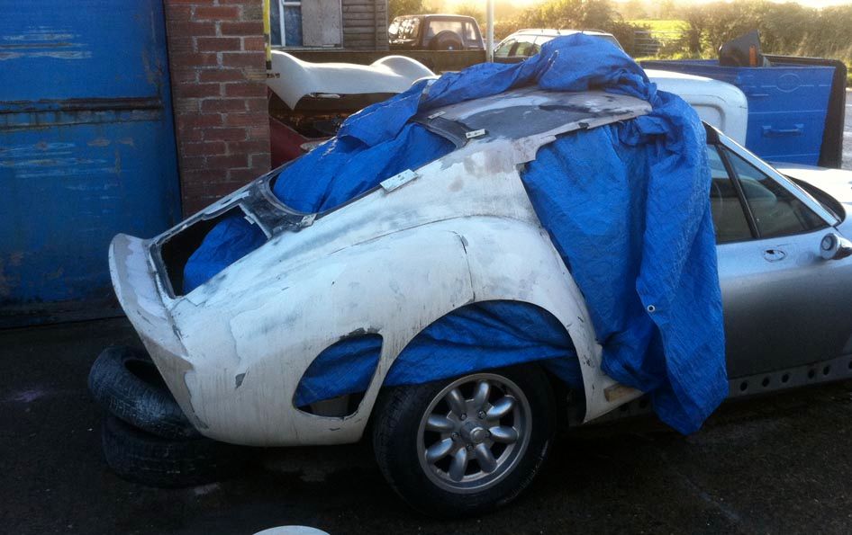

Z3 stripped of its outer panels
Cobra rear end tried for size.
We will be using just the first foot of the panels combined with the MX250 rear wings and roof.

I think the cut and shut Cobra panels will be a quick start to the rear end of the SWB when combined with the MX250 kit. Some parts of the front end can be utilised too, headlight mounts etc.
To me the arches look incorrect, and it almost looks like cutting the extreme rearmost part off and turning it upside - down would do it! Also need widening at rear (ie arch is 'flatter' when viewed in plan than cobra one.) Just my opinion , but only looking at photos - reality can sometimes be a lot different.

This is where the magic happens and Chris turns it into stunning kit . All you have to remember is that its based on shapes. Some bits stay and others go. Quite fun watching the builds coz it looks like the car cracks and then rebuilds itself into the right shape. Quite a unique process. Wheel arches can be moved up and down, forward and back in the wing.

We have removed the rear of the "buck" body work from the TVR wedge that was used to produce the panels for Alex's Tuscan GTO build. Combined with parts of the Cobra it will be a good start.
