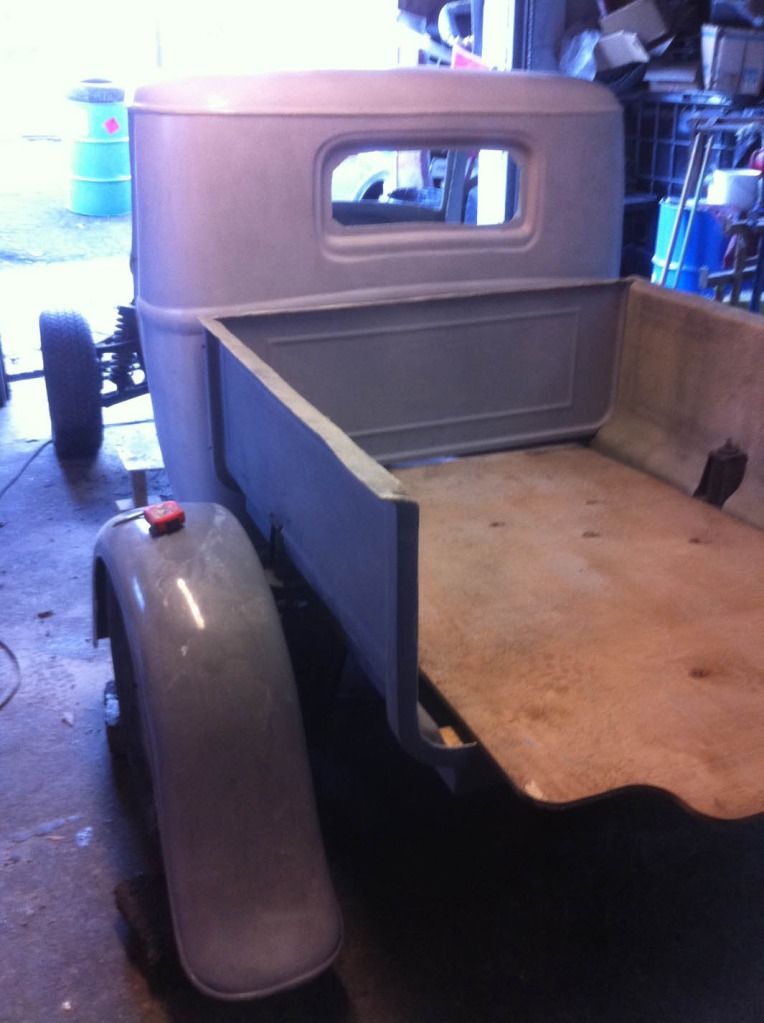

I have started to mount the panels on an unmodified 1970's Lotus Elite backbone chassis with cut down GRP floorpan. Wheels are TR3/6 steels (banded on the rear) and engine and gearbox will come from a Volvo 940 2.3 Turbo. I will be trying to fit a few hours in each week and hope to get the truck up and running in a "rough" form in the next couple of months.

Managed to get a couple of hours on the truck on Saturday. The mock up was pulled apart, here's the Lotus "back bone" chassis for those who haven't seen one of these odd looking things!
A bit more trimming done to the old Lotus floorpan.
Once happy with the position of the cab a 4" gap between the bottom edge and the floor was filled with GRP sheet hot glued in position, bonding paste painted over all the joins and then glassed over with 2x900gsm layers of matt

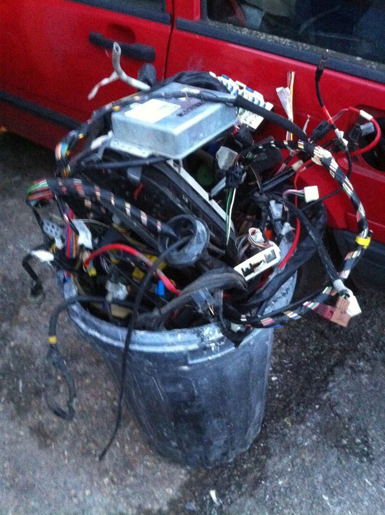

Not much time to spend on my own projects at at the moment but due to the need for space at the workshop we needed to get rid of the Volvo estate that was to give up it's engine and gearbox for my truck. So out the came it's "guts" and were dropped into the truck's somewhat smaller engine bay.
A good fit apart from the lack of clearance for a radiator, not to mention the intercooler, the turbo sticking out of one side of the bonnet and the alternator out of the other!!!!!
Wiring anyone?
