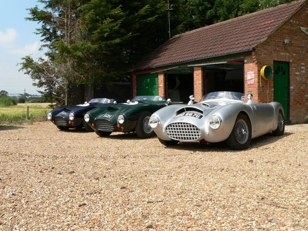

Yep, once you've bonded the shell wherever it touches the frame just fibreglass across from the floor up the inside of the shell. That'll make it really strong.
One thing worth looking out for is the fit of the offside sill at the front, the early Spyder bodies, mine included, didn't wrap under the chassis like it does on the passenger side. I just painted the outrigger body colour and nobody's ever noticed the asymmetry. After all, you never look at both sides of the car at the same time. If you look just behind each front wheel you'll see what I mean -

I had exactly the same with mine and i did the same as Towed, i just painted the chassis rail. In my case i painted it black and it looked fine!
I did talk to GaryJ about this a long while ago and originally the sides were both meant to lip under the chassis rail. Some did, some didn't and we always wondered if there were differences on the later cars as '66' was based on an early Herald and that was fine?
But I agree with now legendary saying "you can't look at both sides at the same time"
