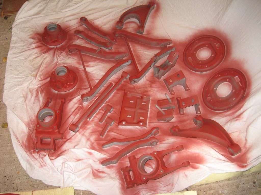

I decided to get some bits shotbasted as i was getting frustrated with the speed at which i could get stuff done... £120 got my 4 wheels done and most of the suspension parts, enough to see me through to the new year. It means that i can hopefully have a rolling chassis by the spring. I did spray some of the topcoat on this afternoon, but it was going a bit wrinkly... is this because it was to cold?

I like the colour, and I love the look of blasted and primed parts.
  #219
Old 11th November 2012, 19:32
Its the way they start off rusty and it comes up so clean... and a bit pitted!
  #220
Old 11th November 2012, 20:47

Hi Gary,
Looks like getting someone else to blast the parts will save you time in the long run.
Sorry can't help you with the paint question, but I'm wondering about the temperature outside myself.
