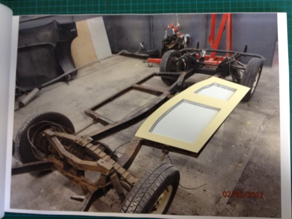

I am a bit bored today, so i thought i would look at how i will do the floors and bulkhead.
Andy, i have used one of your photos as it gave me all the points of reference. So its going to be 18mm ply with dropped foot/floor wells... it would be interesting to hear if the pedals are still ok? as when sitting i think your feet approach from a different angle, especially the throttle. The drop in the floors will be made up of complete panels routed to match the one above, basically laminated to the depth i want. Not sure hat to coat in or should i tape all the joints with fibreglass matting? Once the floors are in place, i will bolt the frame in and build the bulkhead to fit. So, what do you think?
  #83
Old 15th May 2012, 17:02
Looks good! Although remember that the 'std' footwells attached to the bulkhead are recessed anyway so i can't see there being any pedal problems. Are you not going to reuse those front footwells?

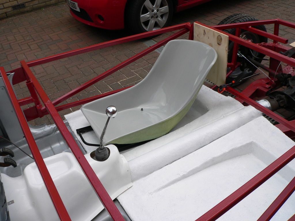

If you're planning to put sliders on the seat bases it'd be a good idea to slope the rear floorpans so they're level with the edge of the outrigger at the front. Otherwise the vertical face at the front will seriously limit the seat travel forwards.
Here's how mine evolved -

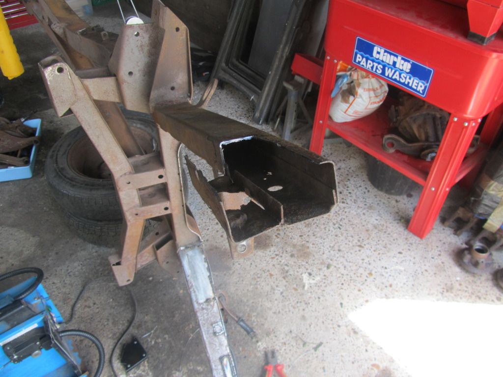

Old 6th June 2012, 19:25
I have finally finished patching up the rear outriggers, i know some of what i have done won't be needed, but i thought it was a good place to practise welding. Tomorrow i turn the chassis upside down and start on the passenger side main chassis rail, which seems to have rot all the way round.

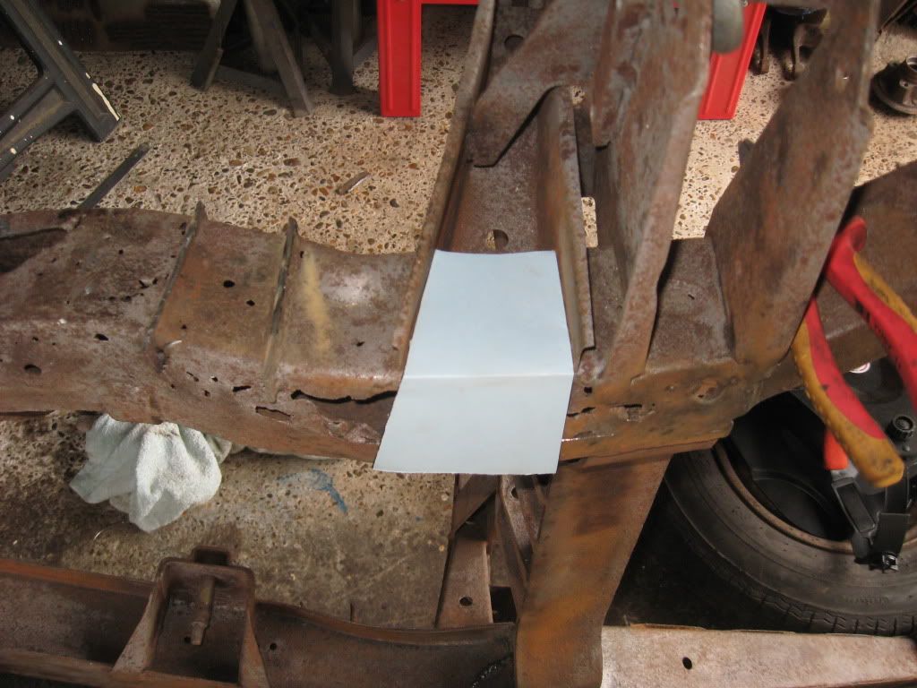

Old 7th June 2012, 20:58
Another good day in the garage, a couple more patches done and making up templates for the more complecated chassis rail
I can't believe that i might be able to paint the chassis soon. Well, once i have welded all of the chassis rails and outrigers back on...

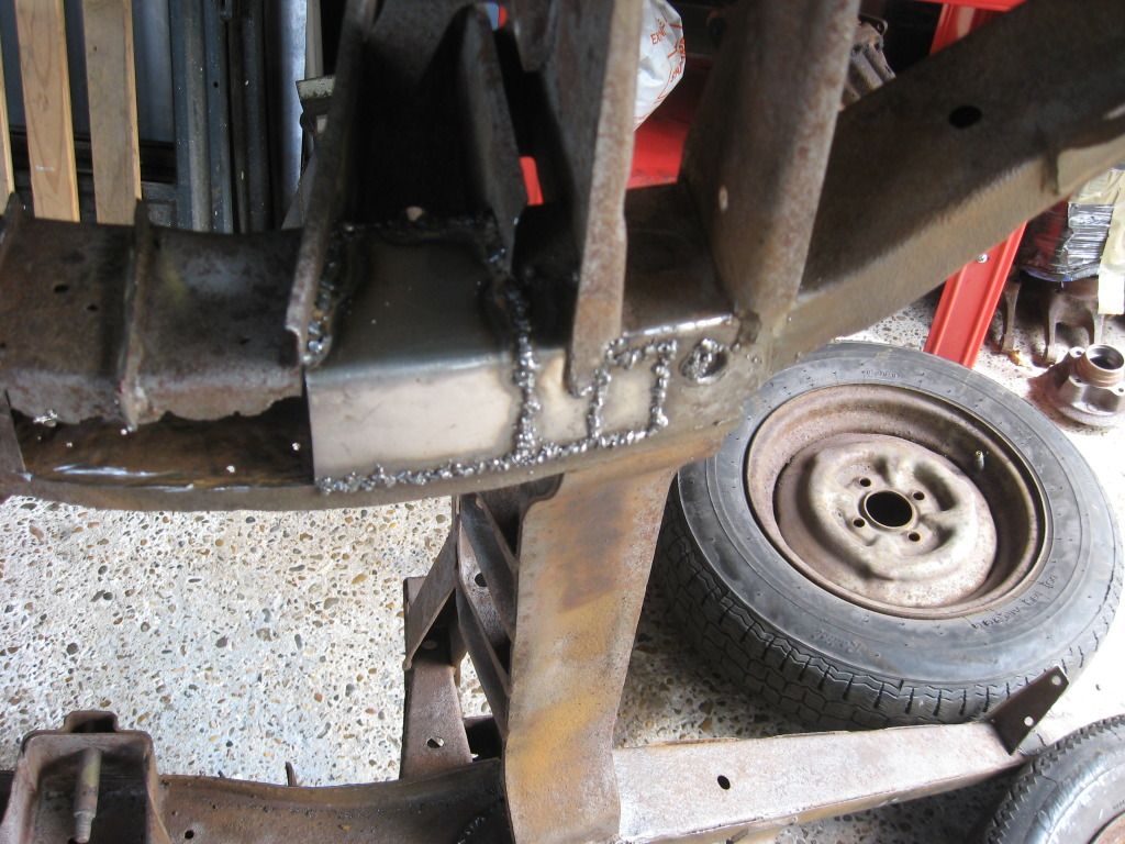

  #100
Old 8th June 2012, 21:13
There you go, its a bit stronger already.
