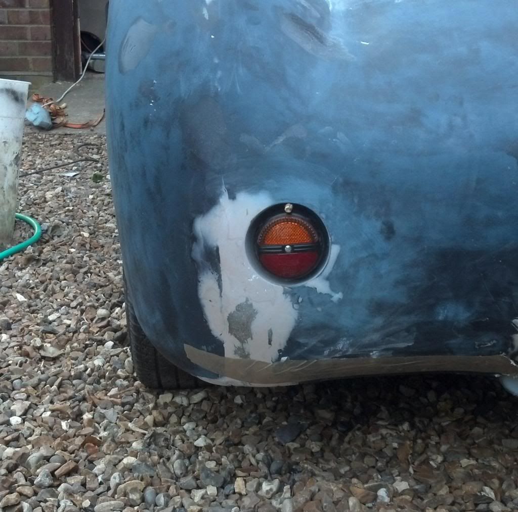

Made a decision on rear lights with these from SVC~, keeping the minimal but hopefully period look. Stop , tail and indicator all in one and only 80mm diameter, fingers crossed.

Well the paint turned up and I am really pleased with my chosen colour, however I never got as far as spraying anything, found plenty of little jobs to be getting on with and a couple of changes to plan which delayed this.
Decided the lights wouldn't look so good surface mounted so have had a go at frenching them in at the rear,
So far seems to be working,
Did take a little longer as of course when I cut the holes the rear out rigger was directly behind so had to be shortened about 8cm.
Not mounted yet just held roughly in place with the stick but you get the idea.

15th April 2013, 10:36
Posts: 1,163
looking good, what front lights are those? Im looking at brear lights at the moment and struggling to find something i am happy with are those SVC units?
15th April 2013, 10:48
Location: Marmande 47200
Posts: 501
The headlights are copies of P700, an Ebay special around £50.
The rears are SVC, was worried the compact size wouldn't be bright enough but very surprised 5 watt tail is ample, break is 21w and indicator 10w all separate bulbs..
