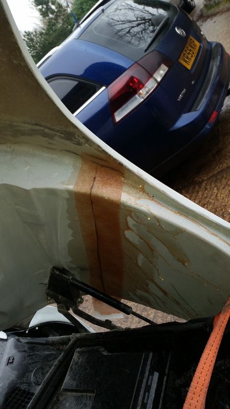

Thank you for all the great comments, it makes it worthwhile for all the hard work we put into a build. Each one we learn from and it makes for better finished cars. Obviously the boot lid is not bolted on. We tried a new technique with the bottom of the bonnet wings. They sit perfect now, if you look at all the Koupes and Kalifornias that have been done before they stick out.
Good morning Richard will the new technique be available to already built cars? thanks Geoff .
17th February 2016, 08:34
Posts: 607
Sorry no as it has to have this done before the paint stage. Basically we cut out 7mm strip under the bonnet below the bonnet hinges. Then use a ratchet strap to pull the edges together closing the gap. We then lay Glass fibre over the gap to strengthen it again.

I guess if we were careful and padded the strap we could do yours. You could do away with your leather hold-down straps then. Unfortunately it would have to be after Stoneleigh as we are stacked out with work.
