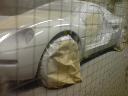

Now in primer... glad to be seeing the back of that foul green colour!

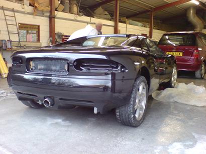

Back from the painters...

Nice !
