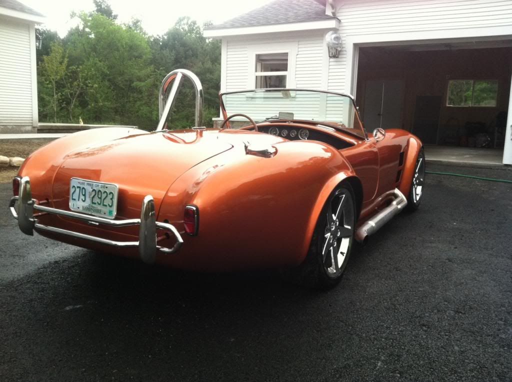

Posts: 214
You amaze me Chris. Love Cobra's. Here is my self built one. It uses the complete suspension and drivetrain from a C5 Corvette. So, it's not a replica. It's a Tribute too.
