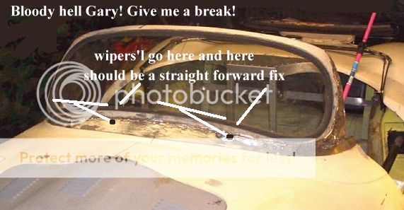

Default Wipers
[IMG][/IMG]

Old 11th February 2014, 19:23
Like the bloke in the "A" team once said,
Don'tcha just love it when a plan comes together!
Thanks Ox.

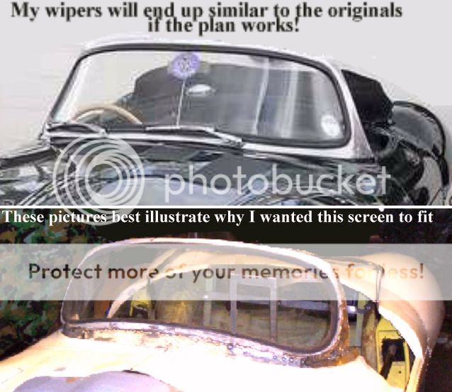

Default Screen
[IMG][/IMG]

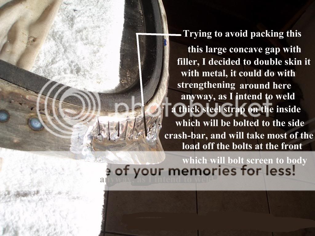

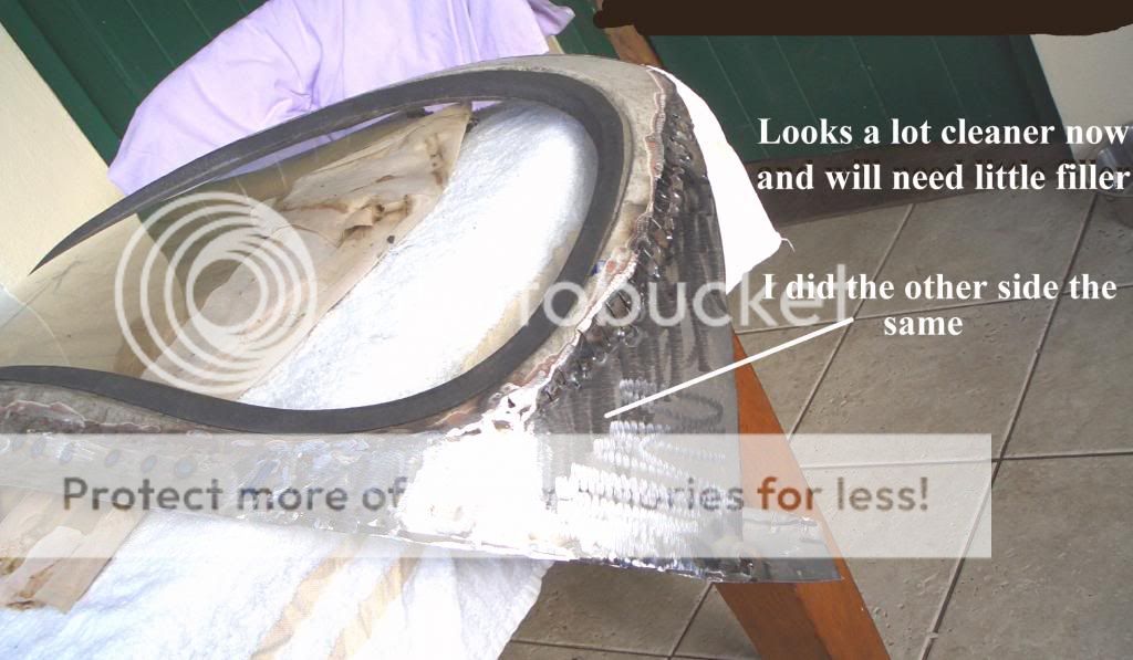

Default Today

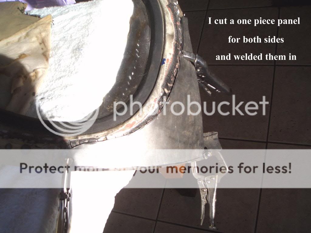

Like most people, I like to do my welding outside, but it can only be done in good weather. Well, that's not strictly true, but its more fun in the sun.
Today was a good day, so I went for it. Windscreen back off the car and more welding to it.
It is stronger now, and will need much less filler, both good plus points.
[IMG][/IMG]
[IMG][/IMG]

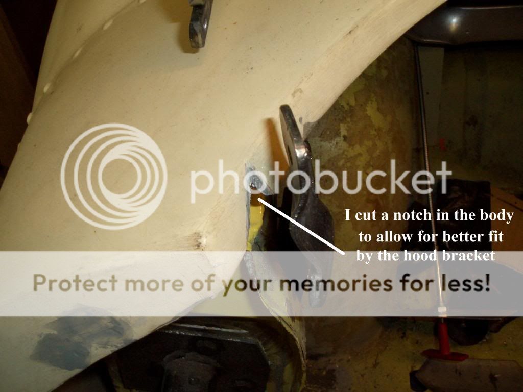

Default Also today

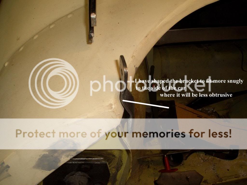

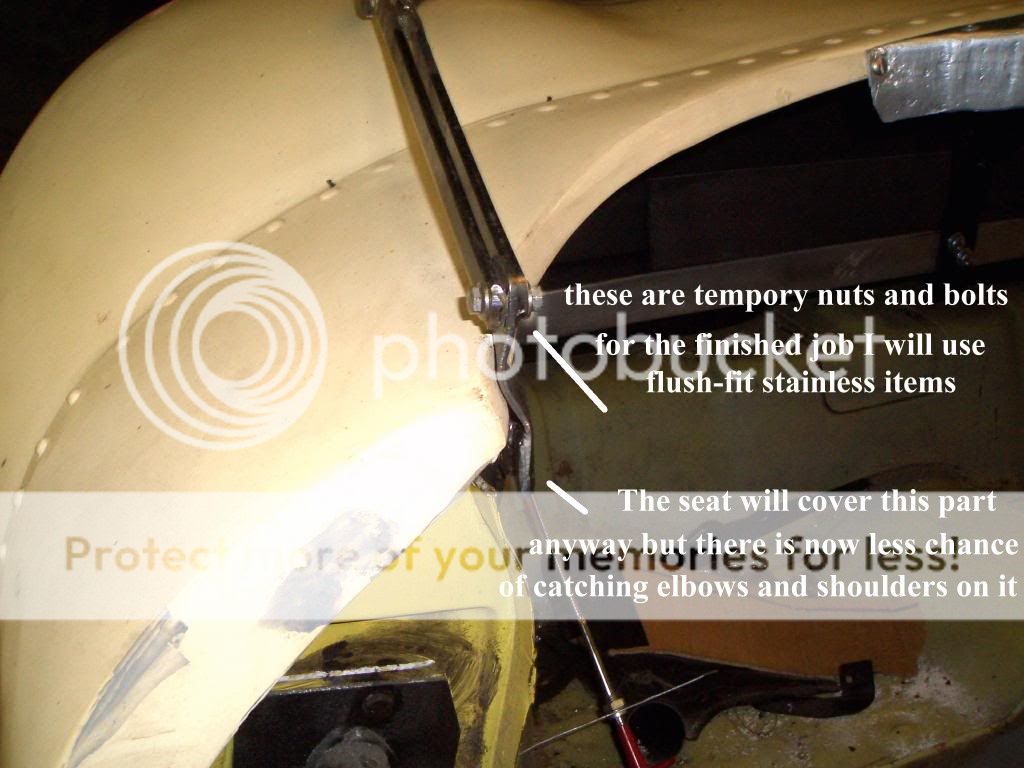

When I fitted the hood brackets, it was more to see if that was a viable solution to fitting the hood.
As it turned out, it will work, so I set about refining them a bit.
They needed to be more precisely engineered to fit, so they did not
protrude into the (tiny) cabin space, or dig into my shoulder.
I took them out, heated them with the welding torch, and shaped them to fit more snugly, and cut a small slot in the body to make them even more neat.
I think it was worth the effort.

[IMG][/IMG]
[IMG][/IMG]

Old 13th February 2014, 18:53
Looking good Scottie. The screen surround is nearly there
