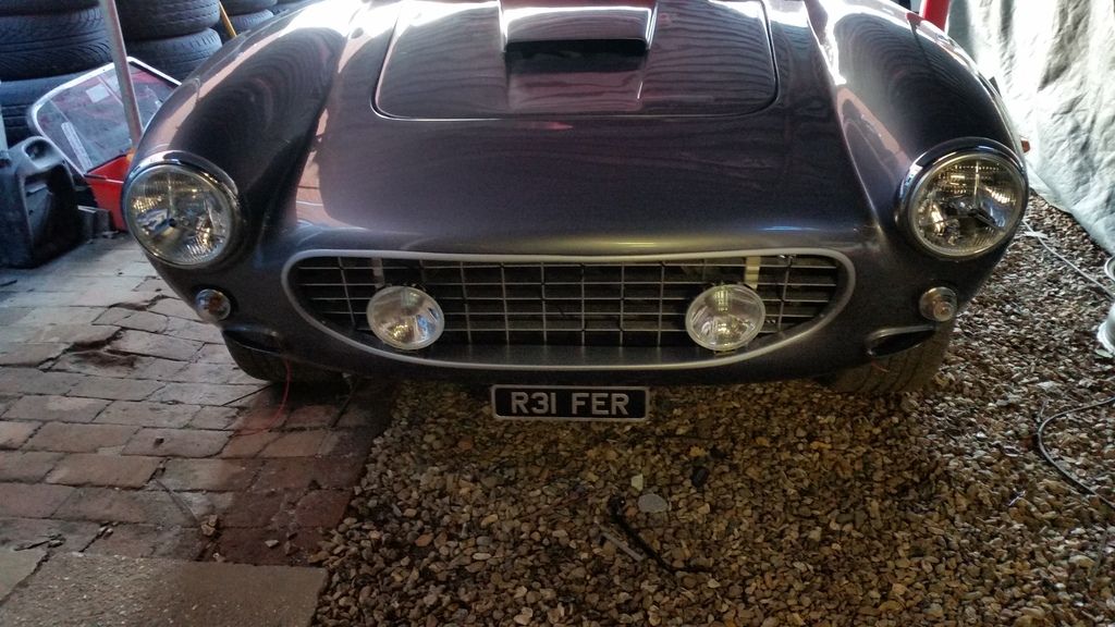

The grille was trial fitted. The new spotlights were lined up and bolted on. The surround was sprayed silver for now. The customer wants to change it for our polished alloy one when they are finished. We will take it apart tomorrow to paint the mounting brackets matt black so they disappear.

Today we finished the grille. Painted the mounting brackets we made yesterday matt black and they disappear into the background. The area behind the grille was also painted matt black which helps the grille stand out.
