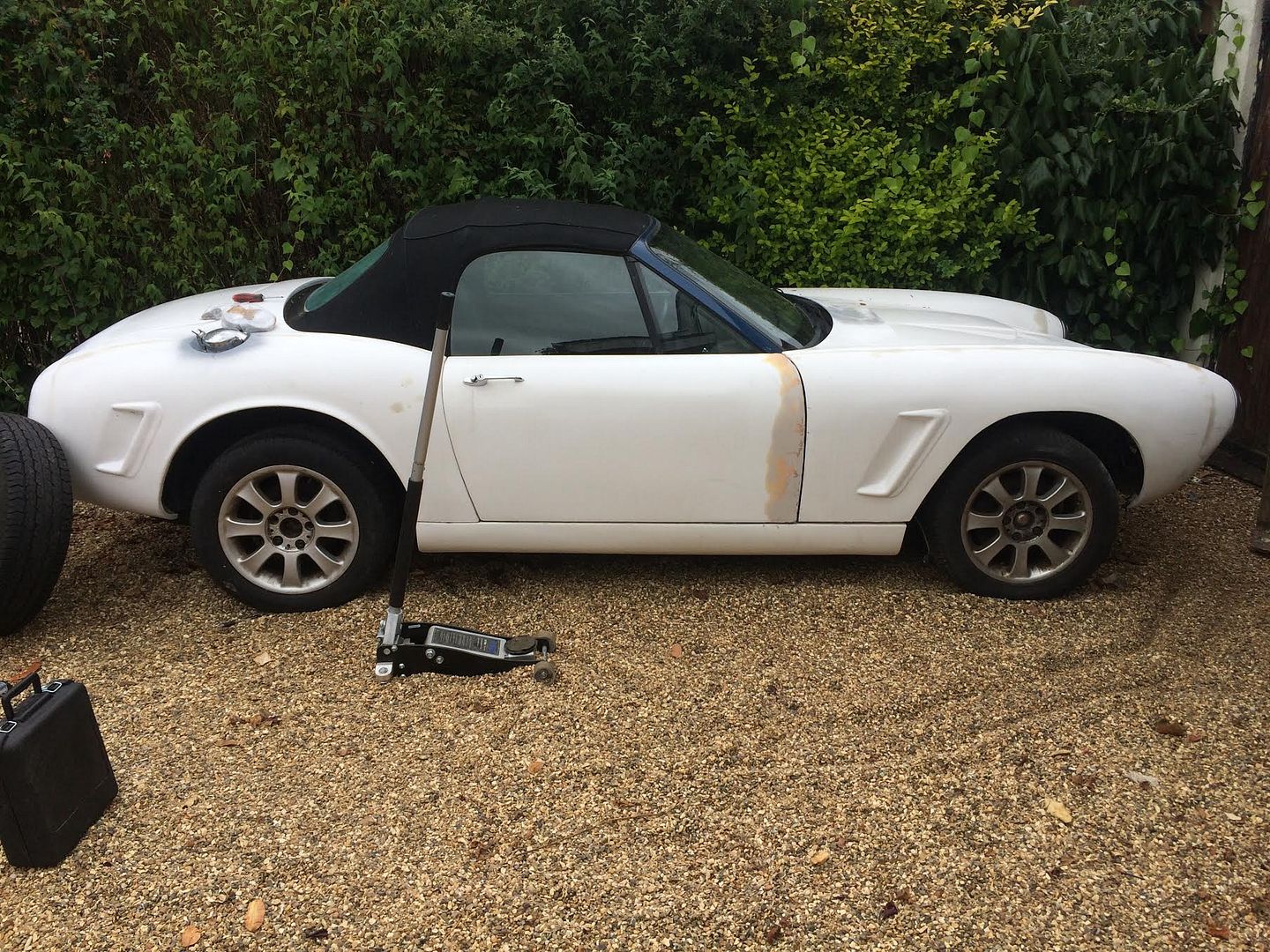

Default Success on the door gap/opening problem

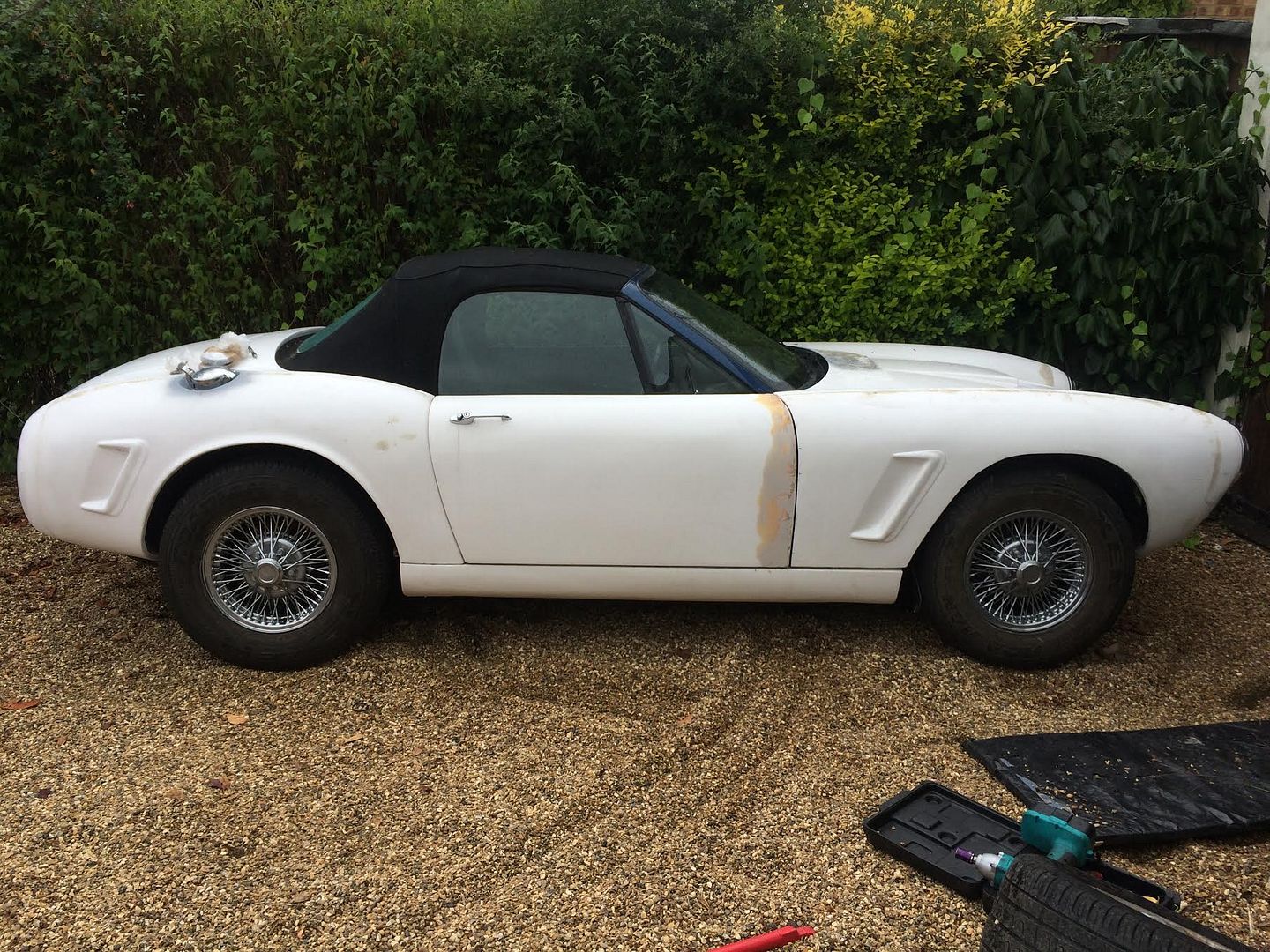

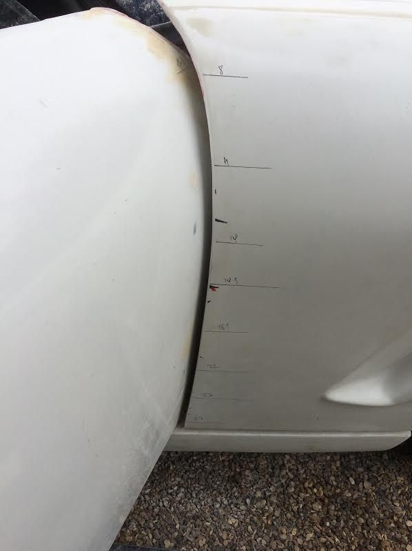

First picture shows how much I have had to build up the leading edge of the door

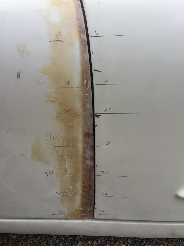

I have just run a thick felt tipped pen along the trailing edge of the wing, this marked the front of the door, I then used this line to sand back to give me a pretty even door gap, obviously needs to be filled and neatened up.
Gap against inner wing with door fully open and a bit of pressure against it.
small section of old wing mount removed
Door fully open with extra pressure applied, plenty of gap and no need to shorten the check straps.
Even passed the wife test.

Small update, I finished the passenger door in the same way. I didn't need to sand away so much of the wing this time so it was much easier. Probably helped as it was a known problem and solution the second time around.

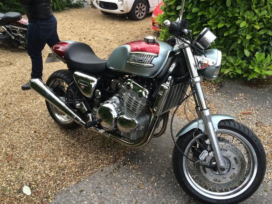

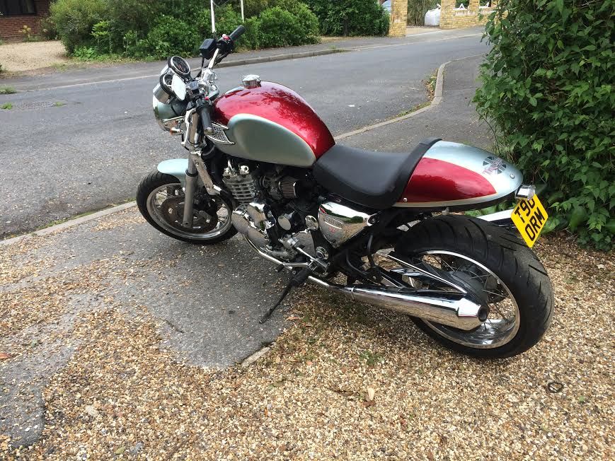

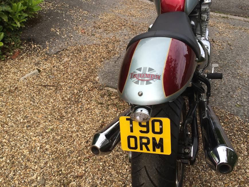

I make the seats, fender eliminators and mudguards as a paying hobby.
This one is a standard Thunderbird that has been fitted with a Thunderbird Sport front end, down pipes and exhaust. 5.5 alloy rear rim with front to match. Pods with K&N filters. rear cowl had a custom airbrushed paint job.

Wheel Fitment
Fitted the bolt on wire wheels today. They are monsters and weigh a ton, I struggled to lift the wheels onto the hubs do I fitted two studs to help align the holes. Worked a treat but I will put some electrical heat shrink on them so they don't catch the powder coat. I will keep them in the boot along with some standard bolts to fit the spare wheel.The standard studs are too short.
[URL=http://s803.photobucket.com/user/jaguartvr/media/z3gto/wheel2.jpg.html]
The new studs have a 45long thread + 10 collar so are 55 in total not including the head. They are wobble bolts. I also fitted collars to the hub to give the right diameter.
Before
After
I think the tyres may be a little too big but will do for now as I won them on Ebay for 99p

Just gone to move it as it's pouring and it feels as if all the brakes are locked on. I suspect that the wheel bolts may be fractionally too long. Will try and have another go tomorrow.
I also drilled some 5.5mm holes through the doorskin, then removed the gap skin and enlarged the holes to 7mm to fit rivnuts. I can now fit the doorskin very tightly and precisely. I have used M5 countersunk screws, the heads are almost invisible.Will take some pictures when I do the other side.
