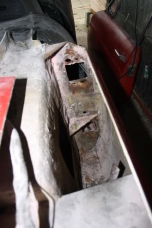

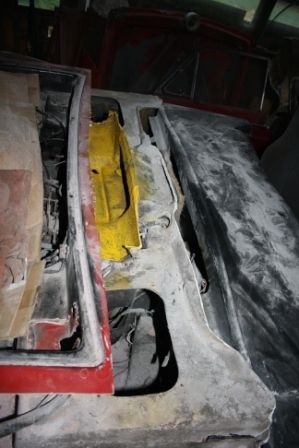

The skuttle top had been separated from the rear body at he doors so i set about cutting away the dash to get it to fit,
using the pictures of Nike55 and GWA's threads on this forumn.
The cut slowly and trial fitting is taking longer than i expected and creating a large pile of small red fibreglass pieces.
However i now have acess to the door hinges and the supporting metal work, which seems to have rusted considerable.
I had considered fastening Gary's metal frame work to these but the dimension were wrong and the frame to tight for my body
so i will stick with the reliant bulk head as Reliant deemed that no front metal frame was required.
However I am planning to retain the existing heater arrange ment so have sprayed the inlet yellow so i do not cut it out!
The skuttle is not forward enough for the old front bonnet channels so I have left them in place for now.
The good news is that the skuttle and rear body now match up so I have not screwed up! phew!

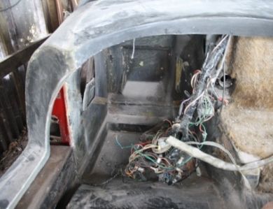

that shot of the wiring loom has left me in a cold sweat!

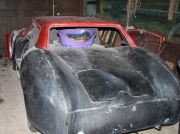

Well lots of time spent on the body with no visible progress.
I am now happy with the fit of the rear body on the old wheelarches.
The front valance is sitting on what remains of the front bulk head with a cutout for the old heater inlet which I plan to fit a grill over.
I have trimmed the bonnet so it is sitting well on the front bulk head and the headlight pods are resting on the old scimitar front bumper bar

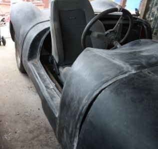

My 356 screen fits but the angle is still too sevre for my liking as i can still see over the top.
below are a couple of shot of the screen in situ.
and another
It certainly changes the look of the car
More to follow
HM

I been wanting to move the car out of the garage to get a side on view now that all the red panels from the scimitar are covered over.
So I finally managed to get the engine started tonight and move it up the drive to take these shots.
the body was covered in dust so I gave it wash down and ended up with a somewhat angry Nimo
The guy in the car showed a passing interest.
There may be a few too many holes in the dash for some, but the scimitar does have some usefull dials.

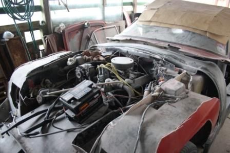

The expansion bottle from the standard scimitar needsto be higher than the thermostat housing, but the shape of the bonnet does not permit this easily.
Having seen Mr towed arangement with the modern 2 stage pressure cap.
I considered an addition of a length of piping with a cap.
However, ford provided a more elegant solution in the form of a modified thermostat housing.
The expansion bottle can now be fitted low behind the front wheel arch.
onto the nex problem, relocating the battery.
