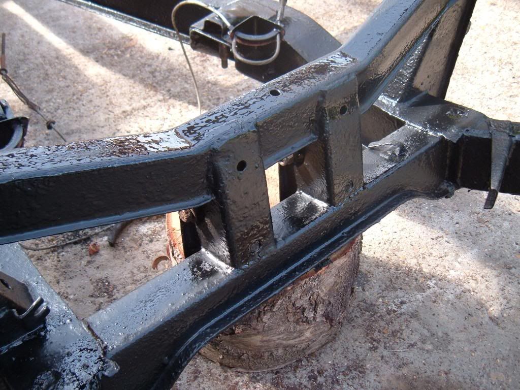

Unhappy Chassis update
Nearly ready to start building up the rear end. (I hope I've attached the photos correctly).
Got a new set of bolts & bushes and rear diff should go in soon.
Rather pleased with the chassis as I've not had to do any welding .. the car was properly undersealed soon after manufacture.
More photos to follow as I build up. It realy seems like I'm getting somewhere but it's taken a year to get this far ...
Slarti

Size of a postage stamp... Rozam Ko-bar... Bigger pics please, you did the pic of your car ok!

Hi
Any better?
Not strong on technology .... give me a set of imperial spanners any time
Got the diff back in the frame tis evening. Will post some more piccies soon
Slarti
