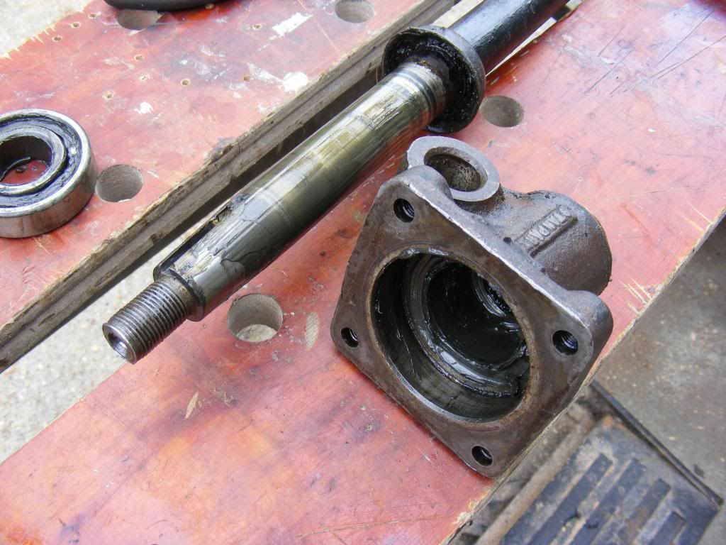

With the rear hubs off I can at last strip down the bearings & replace them. The main bearing also took a bit of a pull, but soon yielded under a 3 legged puller. All de-greased, pressure hosed and ready for a rub down and repaint with trusty Hammerite.
Chap I know with a small engineering works has made me up a lowering block & I should start to rebuild the back end this week. More photos to follow.

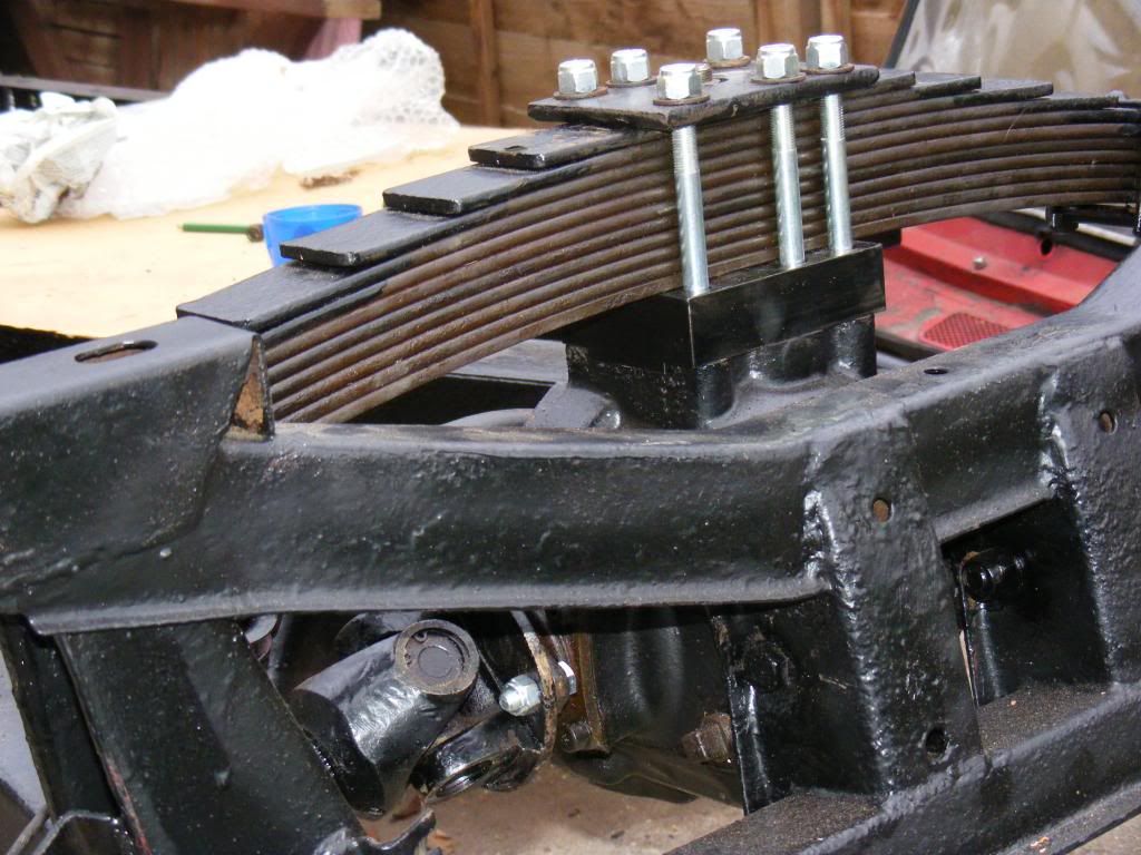

Not much got done again this week end as I has to straighten out a little bend on our oldest daughter's car ..... at this rate it could take 5 years or more to complete the Sammio ...
However, got a fair way in building up the rear suspension. Slight problem. The shockers aren't long enough .... I bought standard ones but as you can see from the picture they are just a little too short and I don't want to strain them. couple of questions: will they be long enough once the body goes on and there's a bit of weight on top or should I 1) get longer shockers or 2) remove the top 3 leaves on the spring?.

Bearing in mind they are at full droop i think those shocks will be fine by the time its on the ground with the weight of the body on, not sure you can even get a shorter rear shock anyway, others may know different though.

You shouldn't find the standard shocks to be a problem, just lift the hub until the bolt holes line up.
You might find the ride a bit hard with a full spring stack fitted though. I initially took out the three loose leaves and got very firm rear suspension - perfect for track use but too hard for the road. I've now removed the next stack of leaves too and the ride is much more supple, allowing faster progress on the road without the wheels hopping off the tarmac.

Thank you Mac, thank you Towed ... will remove a few leaves and put a bit of weight on it. Ordered new wheel cylinders & fitting kits from Canleys. Should get the back end finally rebuilt next week end. Then I can turn it round and start on the front suspension. Watch this space.

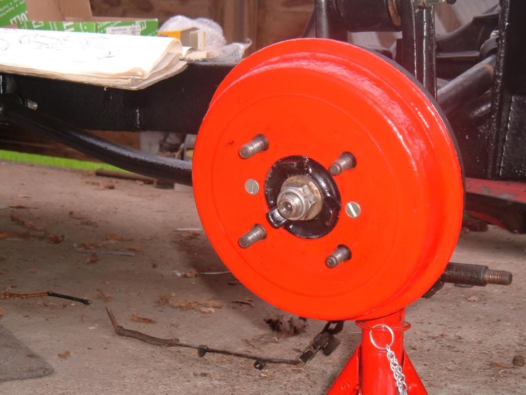

Retaining clips/springs arrived and I've at last rebuilt one side & drum is back on. Thanks Viatron, they certainly were easy to put on.
Have removed the top four leaves on the spring ... didn't need the extra long studs after all ... The shockers now fit easier.
Tomorrow I should be able to get the rear end all back together & have the Old Girl staning on her own back wheels again. Then I can ter her around & start on the front. That is all IF the current wife doesn't have other ideas
