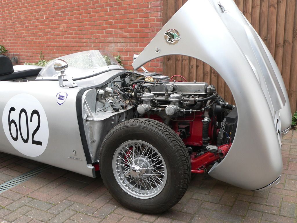

Old 16th January 2019, 19:36
Posts: 5,327
Possibly mr towed did the same in his Sammio?
Yes, pretty much. I needed the airbox to accommodate the methanol injection system -
I ran it like that for about three years before switching to bigger carbs, removing the methanol injection and running it with mesh trumpets -
