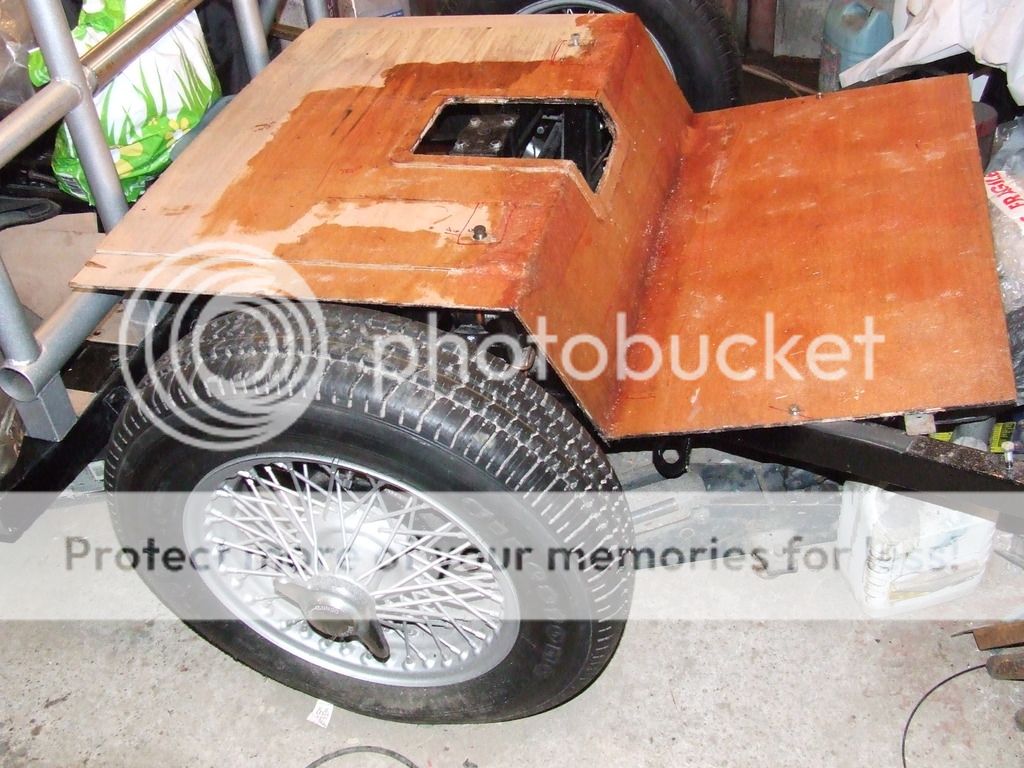

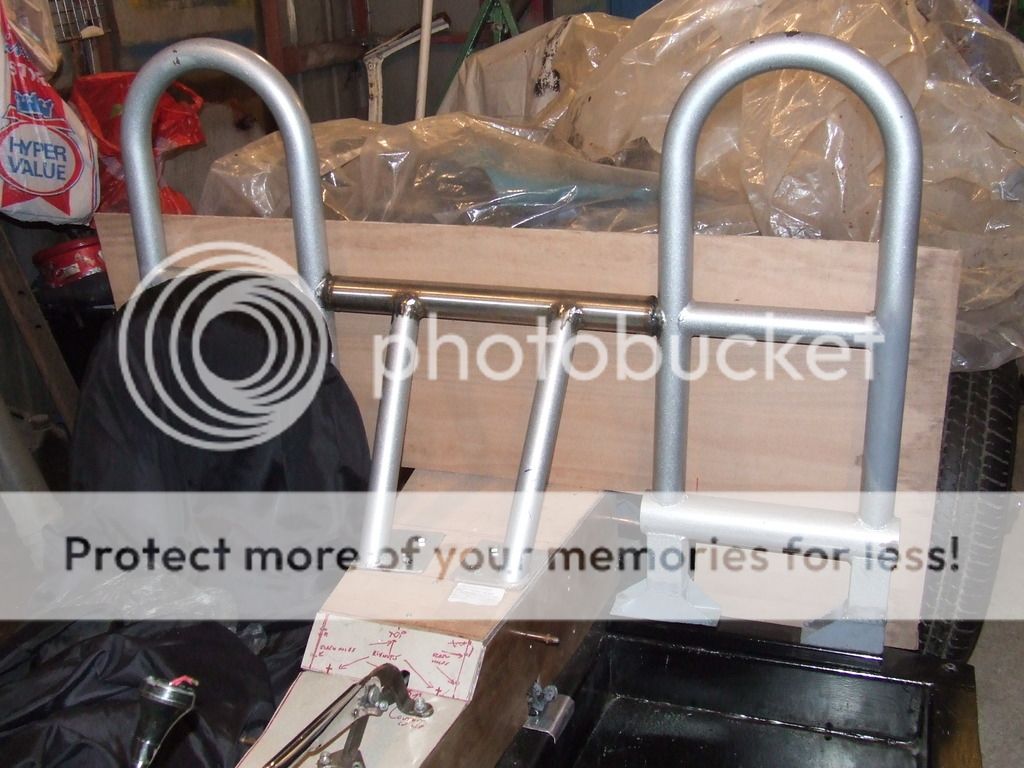

The boot floor in place 6mm ply skinned with glass fibre
[IMG] [/IMG]
Also the roll bar which will need to be modified when the frame arrives
[IMG] [/IMG]

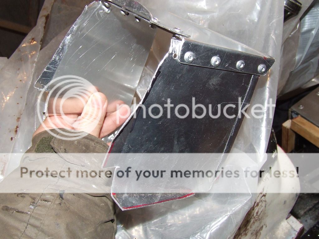

Been playing with the rear tunnel cover today got it roughly in place it's made from 6mm ply and alloy sheet painted the ply with silver wheel paint not bad but not right so I skinned the top piece (under the roll bar supports) with alloy
Looks a bit better now! I just hope the frame (when it arrives?) clears the roll bar if not back to the drawing board

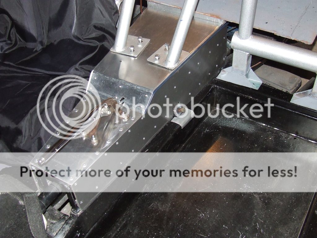

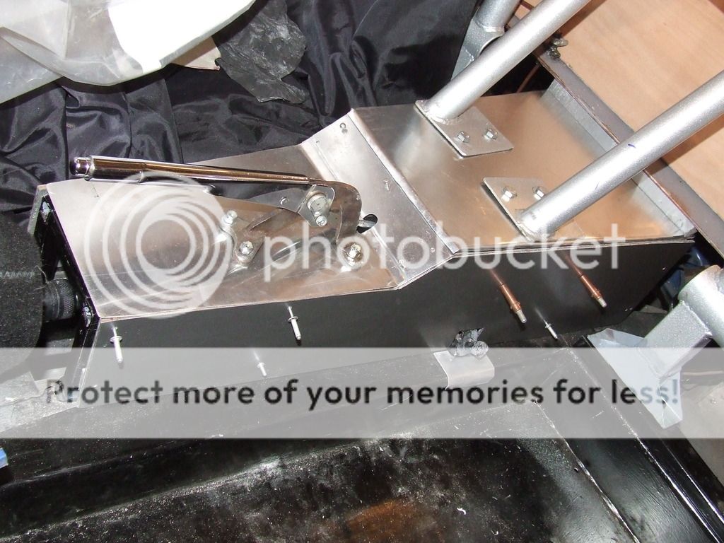

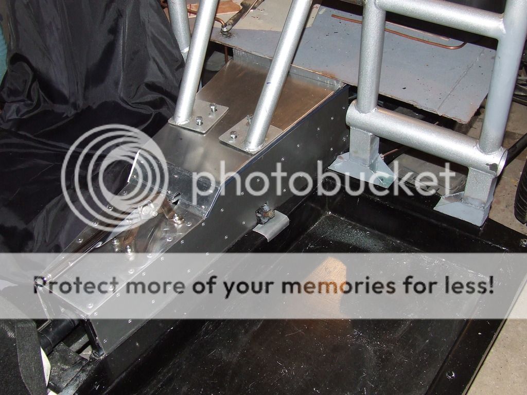

Finished the rear half of the tunnel cover but I'm not entirely happy. it looks a bit big and boxy to me any opinions? All replies will be given due consideration and may be totally ignored?????????
[IMG] [/IMG]
[IMG] [/IMG]

Love it deggsy, where did the handbrake come from?

Bought it in a auto jumble a few years ago can't remember what car it's off well worth the fiver I paid, knew it would come in handy one day

Looks like Mini or perhaps BMC 1100?

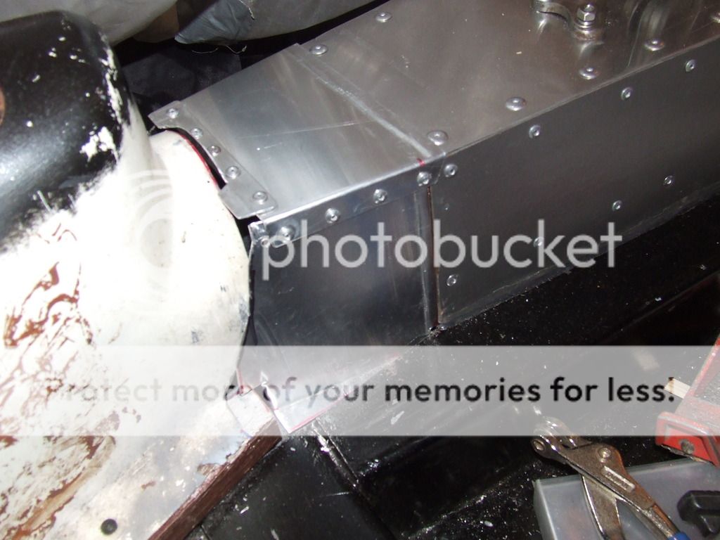

I have just spent two days cutting bending and riveting this cover plate and it's still not finished
[IMG] [/IMG]
And I still don't know if it's any good as I haven't decided weather to use the fibreglass cover or make an alloy one?
[IMG] [/LMG]

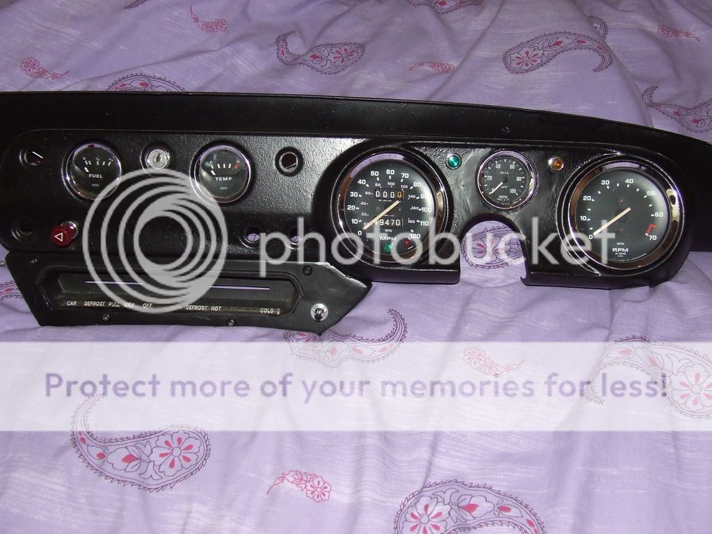

On the other hand I have made some progress on modifying the dash.

Deggsy, I used a new fibre glass gearbox cover (modified) then covered that with ally, take a look back on my thread and you'll see it.
P.S. I like your dash!

thanks' Scottie it' a slightly modified mg midget dash do you have any idea what page your gearbox mod is on I'm up 15 and still searching
4th June 2015, 19:18
Try page 79 deggsy, and the ally paneling came a bit later.
4th June 2015, 19:32
Join Date: Mar 2015
Posts: 395
Thanks found it looks like a good option it's either that, sprat it silver or make a new one? hmmmm

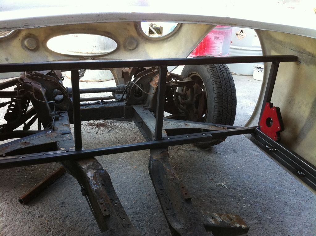

Not having a Herald chassis available to us, we have taken one of our Spitfire chassis's and stretched to Herald wheelbase and added outriggers at the correct outline size as a base to build Derek's frame onto.
Start of lower rail for frame with body mounts:
Lower front bulkhead:

Derek, you may not need the rear most section of the frame I am building but it has been a good design exercise for me to see how itwill work with a Spitfire frame/chassis:
Side sections with door mounted, getting there:
Rear bulkhead area:
You should be able to collect next week.
