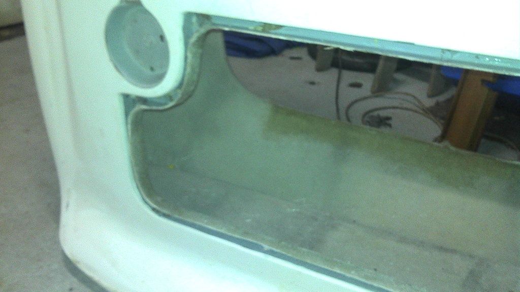

Pulled the former out. Da daaa! One gutter and seal mount. Just needs cutting down a bit and a bit of fettling!
[IMG] [/IMG]
let it rain!!

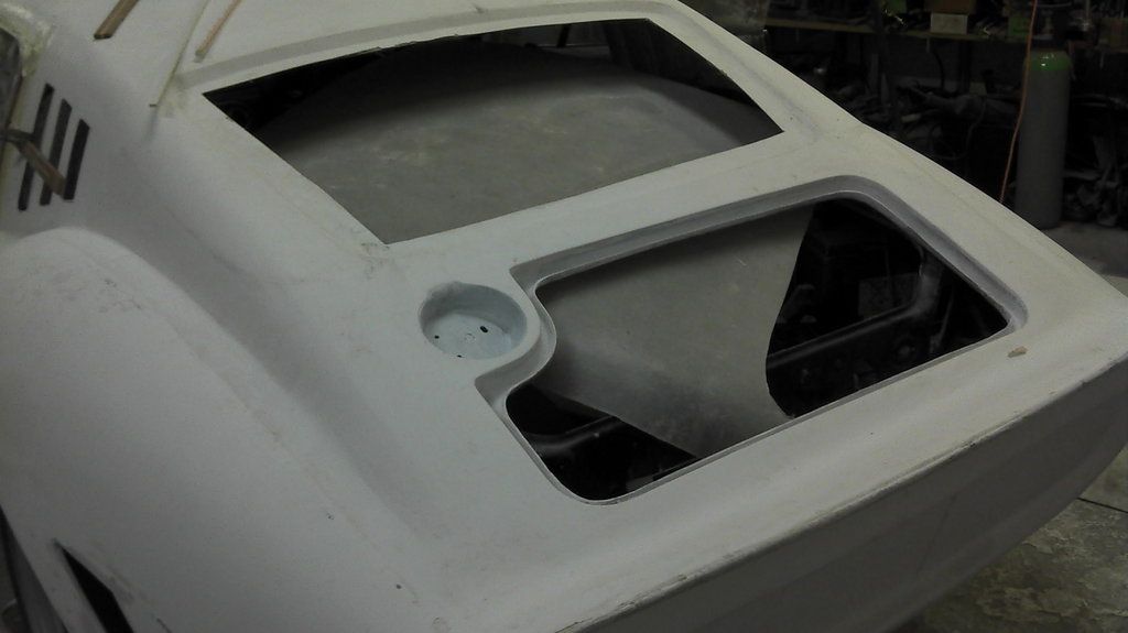

Made reasonable progress this eve. Cut the new boot lip down to size, and filled and faired it. Trial fitted the old seal, then trimmed up the boot lid and inner moulding. Put them ib position the added a couple of self tappers through the two so I can glass them together in exactly the right place.
As the body was off filled and faired the vents behind the door pillar. They will be seen from the inside so have filled over the grp and faired it in.
A bit mire work to the rear vents, doubling the thickness of the cut edge ti make look mire substantial.
Finally did a bit of tweaking to the l.h. door shut so it will match my chosen seal.

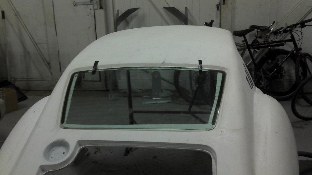

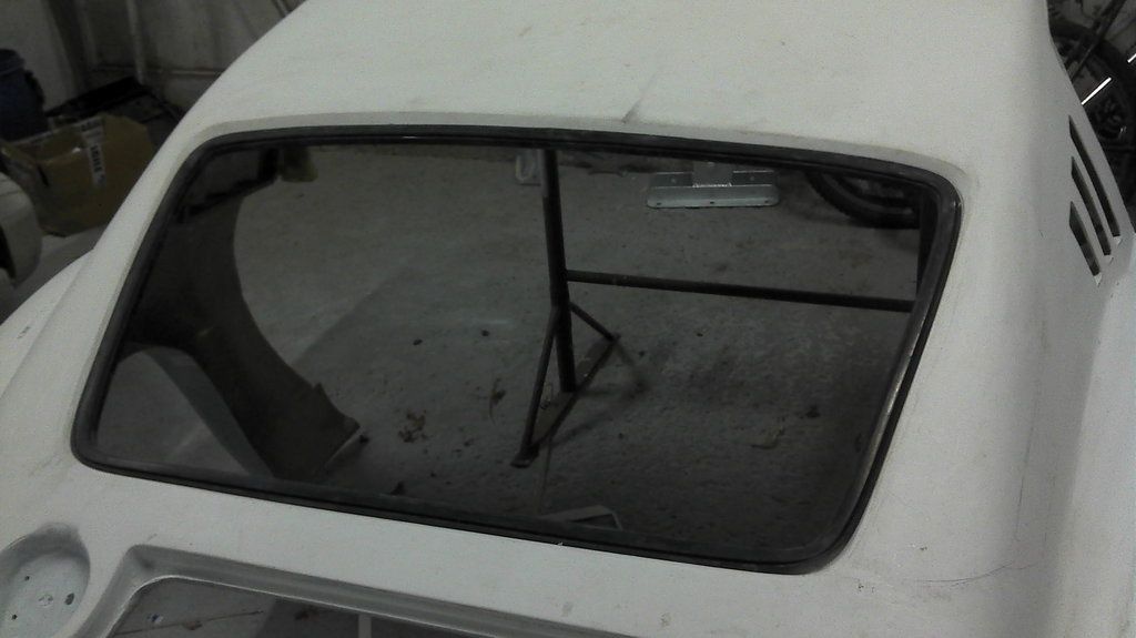

Another few hours this afternoon and I have dry fitted the glass to the rear. The hole in the car is the size of the glass less 6mm, so I taped it in place, marked it out, then marked out 6mm smaller. After cutting out I checked the rubber fitted.

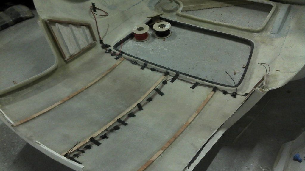

Finally ran wires for two extra interior lights and the heated rear window. Taped in place then stuck them in with a lodge of polyurethane sealant. It would be REALLY annoying if they were to rattle!!
