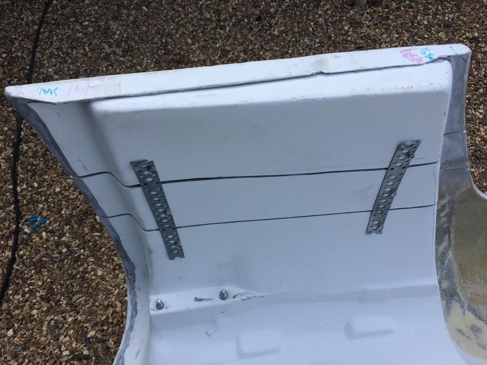

The bonnet cut.
The bonnet sits about 1cm proud of the sill at the bottom edge. I wanted to avoid the 7cm cut method as I thought it might cause too much stress on the bonnet.
I tuned the bonnet upside down and measured across, 1695mm at the rear and 1680mm at the front. Cut two slots on each side of the bonnet with a 2mm cutting disc. Don't plunge too deeply or you will catch the vent on the other side. Take the slot right to the ends.
Then put a ratchet strap on it to curve the bottom inwards, just a little pressure takes it in a long way,I was surprised how much. Release some tension and measured across again, tried 1670 at the front and 1680 at the rear, simply because this is what it came too with a little tension. Attach some builders band across the slots front and rear with self tappers.
Trial fit and adjust the bands if necessary, I was lucky, it was just about perfect, I thought if I tried to improve it I would only make it worse. If you look closely at the gaps you will see that I have had to close them up only slightly, next time I would start with a 1mm cutting disc.
Apply some CSM between the builders bands
Let it dry and remove the builders bands and apply more CSM to the gaps.
I find 4 pint milk bottles ideal for mixing the resin, use disposable brushes and use the last brush used which will have gone hard for mixing the resin.
Gloves are for pansies!
Refit the bonnet and check the line, you can fine tune the fit by putting pressure at the hinge when tightening the fixing nuts.
Almost perfection if I must say so myself.

Good job but its a shame you have to do this on a £5k panel kit. Tribute should really get the mold sorted out for future kits.
28th May 2016, 23:19
Posts: 1,780
Small adjustment, took about an hour, this is the cheaper convertible kit. No complaints so far.

Jag - Thanks for showing us how you did it.
… Take the slot right to the ends …
Can I just check if those slots go all the way through to the "sunny side" of the bonnet, or do they only cut the inner panel?
As I must confess I got the impression you needed to cut off & reattach a section of the bonnet to make it fit.
Hence the example I gave above of working on both sides of the join for extra strength and no visible joint.
( Happy to edit/remove that post if it is not relevant to the fix required. )

It is simply slots in the inner skin only although you need to slot the returns to allow it to bend.
It feels a very solid panel, I was surprised how much it came in with the ratchet strap.
Before you start measure how much the bottom edge of the bonnet stick out past the sill, I had about 15mm. I pulled it in 25mm at the back and 30mm at the front simply because this was where my first tensioning of the ratchet strap brought me to and I was just intending to use it as a first reference point expecting to have to tighten or losen the builders bands before glassing the slots up.
As I got it right on the first attempt it makes me a genius......or it could be down to luck, but I prefer genius!
It is most important to measure across the bonnet at the front and rear where it meets the sill to give you a reference point.
