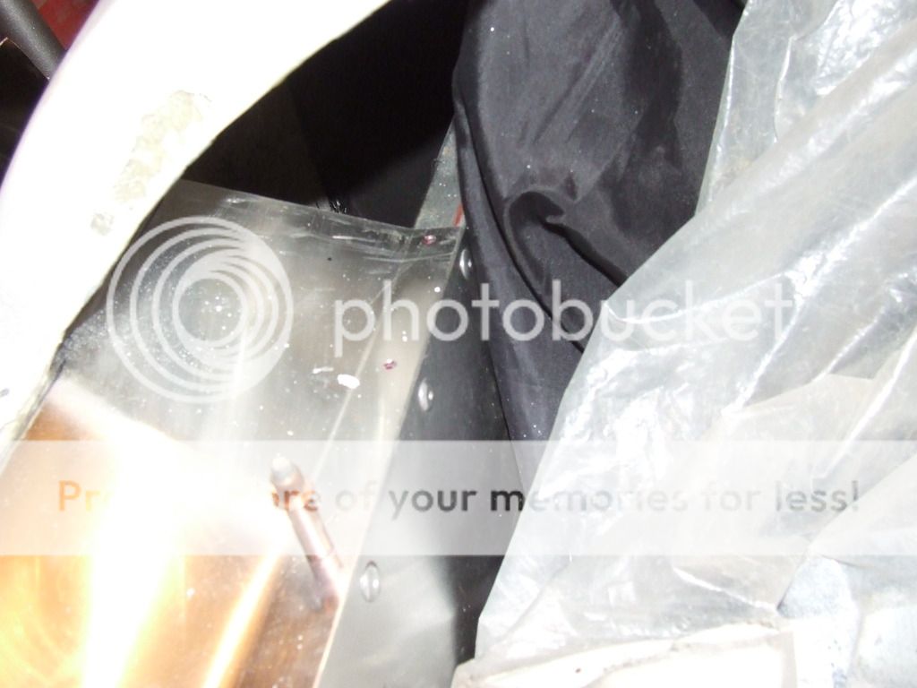

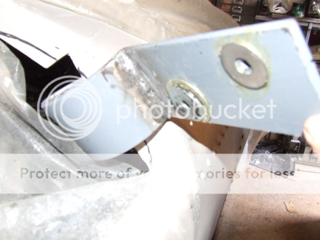

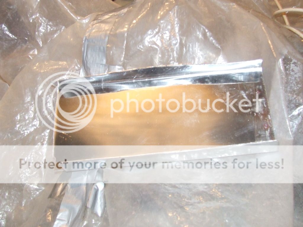

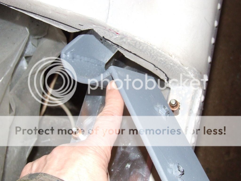

Scottie I was thinking along the same lines though I will have to cut here
[IMG] [/IMG]
almost to the bottom then twist it up tack it and see if it fits probably several times.

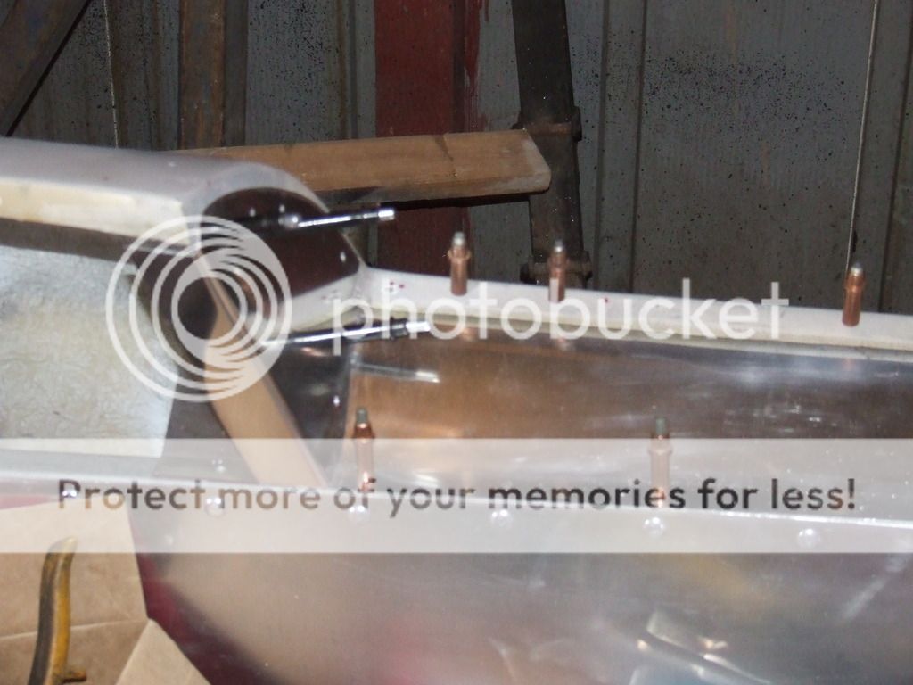

the issue is that due to a total lack of planning it will have to be done in situ now the body is on I can't get the hinges off the frame.

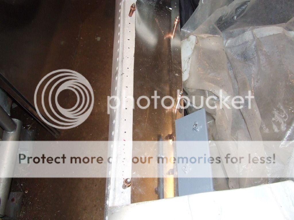

[IMG] [/IMG]

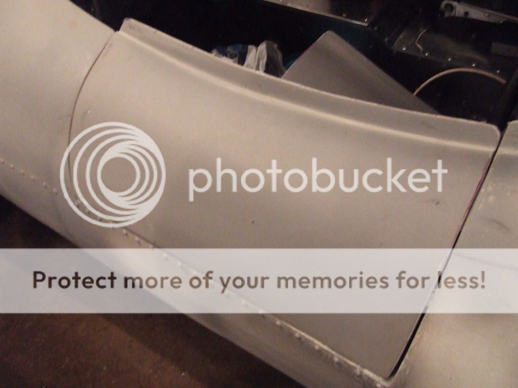

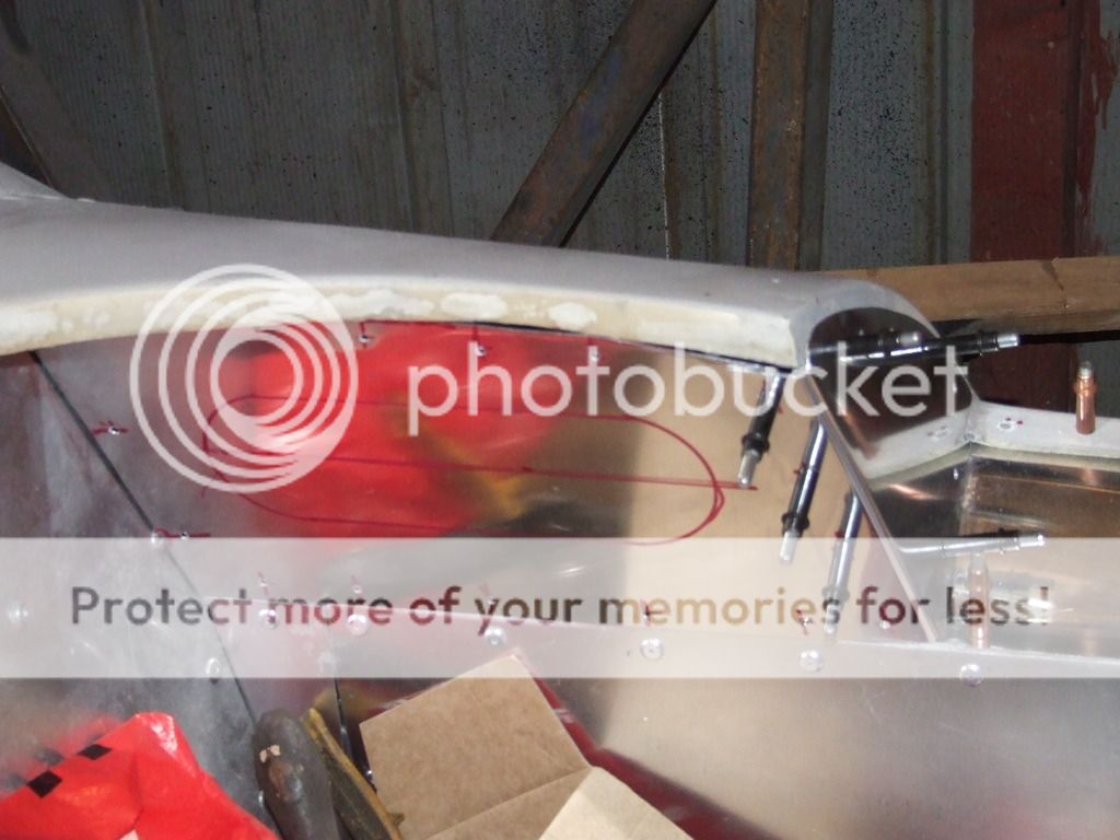

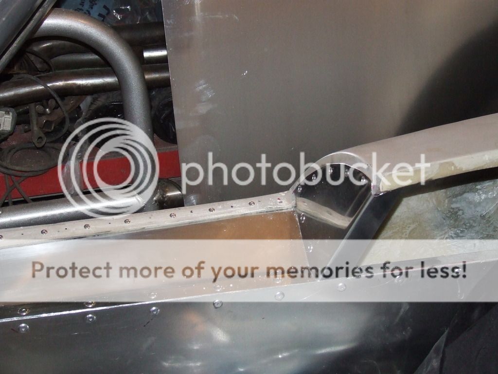

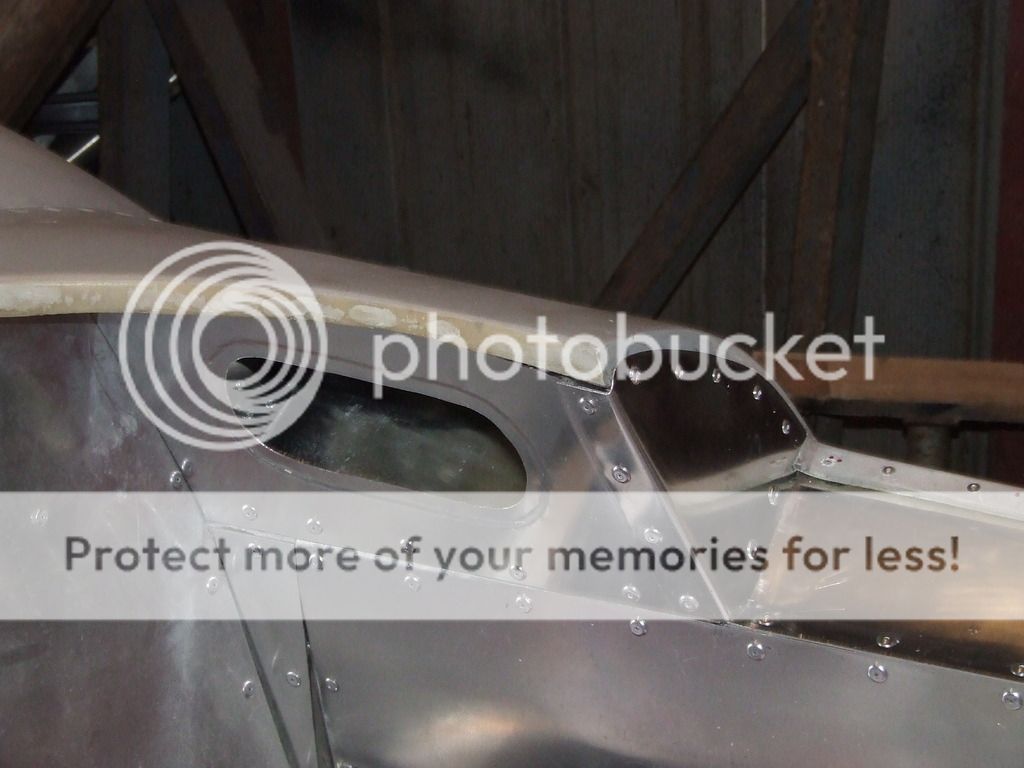

so whilst building up my courage I have been making some of the panelling around the doors.
[IMG] [/IMG]
[IMG] [/IMG]
[IMG ][/IMG]
This should keep me busy for some time.

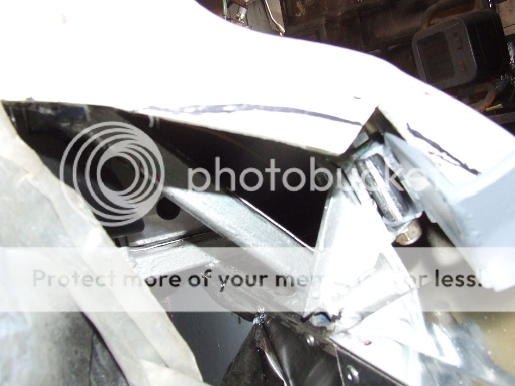

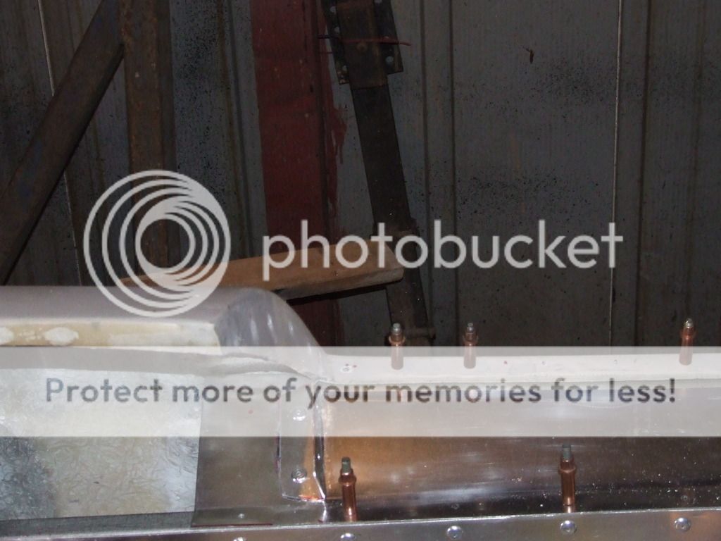

Well I cut the first one in situ and cut too far it fell of it made lining it up a bit harder but worked out ok.
[IMG] [/IMG]
The spacers are glued on temporarily to get an idea of wot's needed.
[IMG] [/IMG]
[IMG] [/IMG]
four 2mm spacers fitted and it's just about there
[IMG] [/IMG]
[IMG] [/IMG]
pretty close eh! Now for the other side won't be for a while though as I have to get my seven ready for the road and then there's Stoneleigh next week end

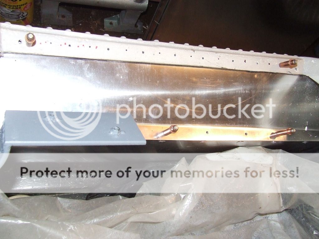

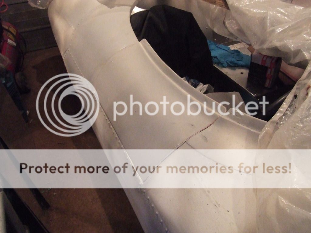

I have managed to get the occasional hour on the car mostly small fiddly jobs
[IMG] [/IMG]
making the panels around the door.
[IMG] [/IMG]

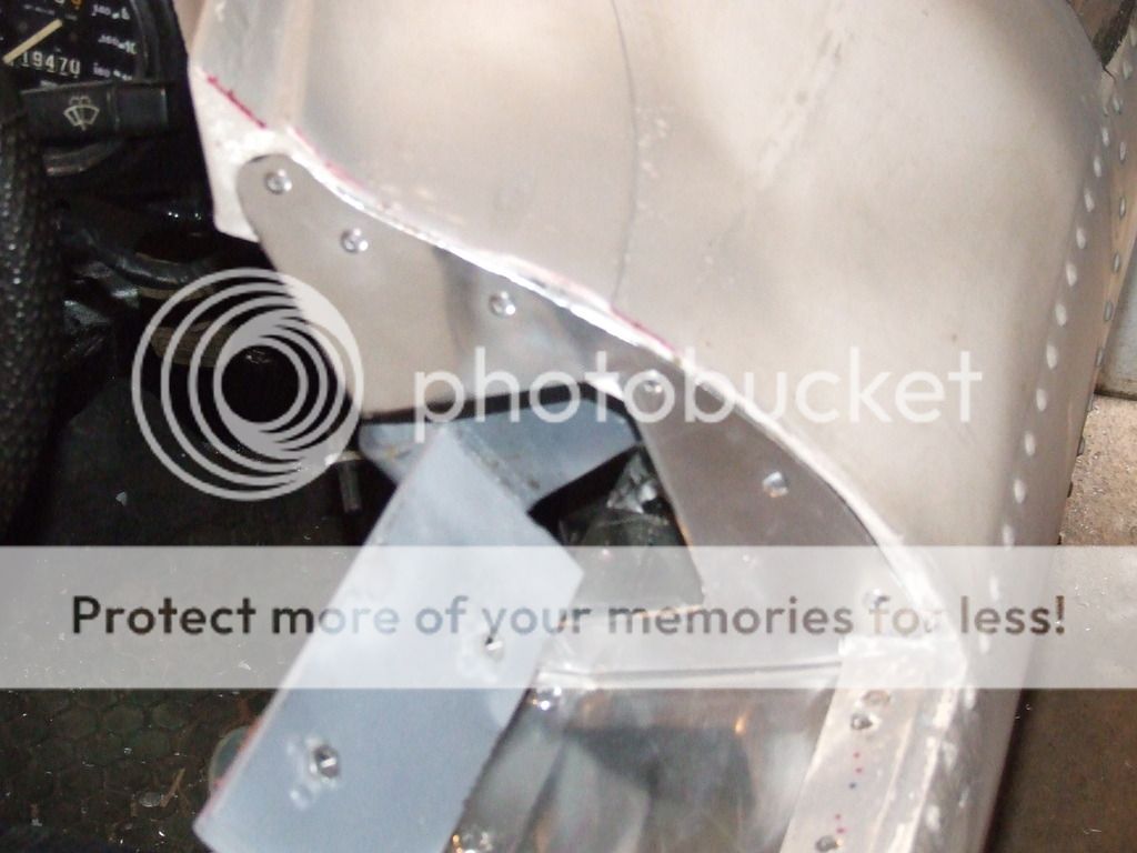

very fiddly to make this end panel after 4 attempts to fit it on the inside I gave up and fitted it on the out side I will have to use filler to make it flush with the body doh! I then realised that when panelled in I wouldn't be able to access the rear of it to fit the lock striker pin double doh! plan c . turn it into storage space.
[IMG] [/IMG]
[IMG] [/IMG]
[IMG] [/IMG]
[IMG ][/IMG]
the other side
[IMG] [/IMG]
I have also cut and welded the passenger door hinge jur a matter of lining it up now.

Deggsy - Your panel work looks great.
How did you get the "indent" around the hole you cut in the storage panel?
Regarding the rain channels...
When I was building a rain channel & drain holes for my boot lid, someone pointed out that there was a still big hole in the middle of my car where the roof should be.
14th June 2016, 09:07
Join Date: Mar 2015
Posts: 395
Paul
I used a Joddler Can't get the link to work but if you type in Joddler in eBay you'll see what they are best to get one with a hole punch as well. I think I'll give the rain channels a miss and use the moulded stick on seals instead.

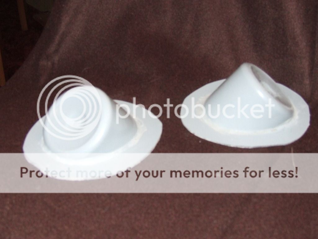

Chris sent me a pair of rear indicator light pods today which I asked him to make for me.
[IMG] [/IMG]
Lovely Jubly
