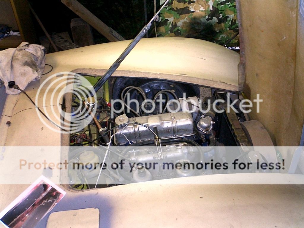

Seriously though, Chris gave me the option of a flip front, but I chose what I have now instead.
I still am not sure if I made the right choice, but as the freshly deflowered virgin once said "its too late now"
Having said that, the bonnet opening is large enough easily for the engine to be removed. And access is fairly good above and below.
Oddly enough, Mick O'Malley, who is building the D Type version A352, opted for a non-flip front as well, then changed his mind,
and has converted to flip!
At the stage I'm at now though, I'll live with it.
See what I mean?

There must be room enough to remove the engine with the bonnet removed.

I thought about a removable rather than flip conversion, but rejected it as I'm a stickler for fluid checks and wanted them easily performed. The front only lifts about 30° but this is sufficient as I have a header tank by the fuse box. I'll post a piccy or two once my latest film has been D'd & P'd.

With only a 30 degree lift, is an engine out action possible, or would you just take the front right off?
Just take the whole front off. It's held at its front end by four M6 bolts which connect it to the hinges. The only pain would be the wiring as I bought the fancy twist together connectors shown on the Sammio side but cannot see how wires can possibly be either soldered or crimped to them, so I'm stuck with terminal blocks for the moment.

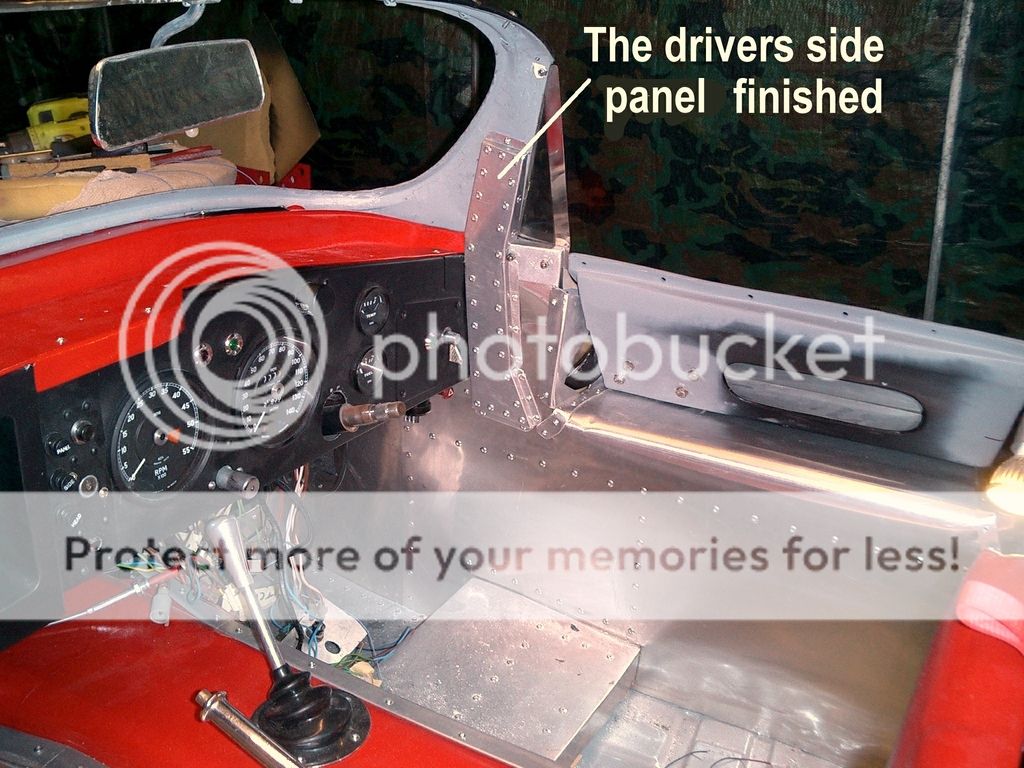

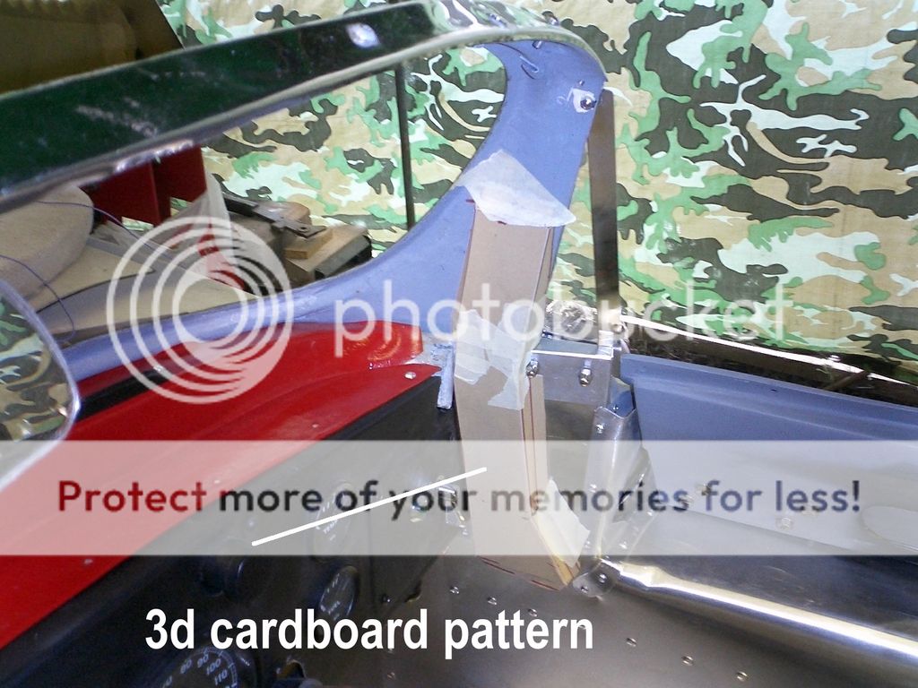

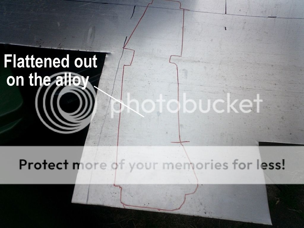

30th March 2015, 20:02
Monday
Today I intended to do both of the windscreen support covers, However,
there was more to it than I thought, and I never got both done.
I did work for 9 hours though, and just managed the one, but the other ought to be faster now I'm practiced at it!
I may have gone a bit wild with the rivets, but I'll live with that, and the other side will be the same.
pics:
[IMG] [/IMG]
[IMG] [/IMG]
[IMG] [/IMG]

Scottie - That is a very impressive bit of metal shaping.
It also adds to the "layers" of detail, which in turn add to the overall effect.

In my earlier post of the finished panel, I forgot to add that regardless of the 30+ rivets in it, it is held on to the body with just two self tappers, top and lower side, so it only takes 15 seconds to remove.
