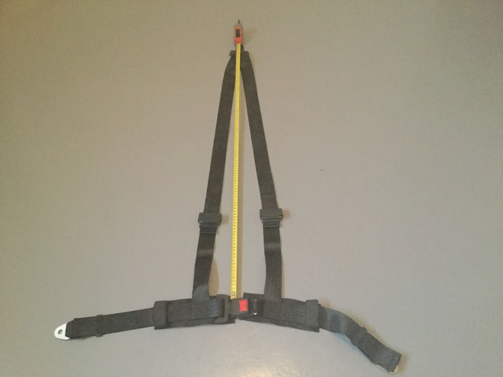

Measured at its fullest extent
102cm belt to buckle at top
Will eventually exit at bulkhead, at the moment the buckle doesn't exit bulkhead but movement is adequate, may open up slot to allow free passage and further movement for bigger drivers..

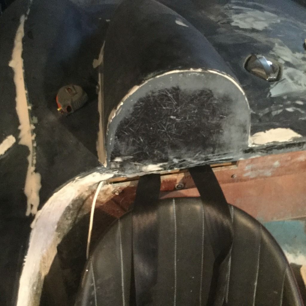

The seat belts arrived yesterday so today Ive been working out where and how to mount them. There's little room directly behind the seats as the fuel tank is mounted just where the ideal position would be so at the moment Ive gone with mounting the inertia real down near the floor directly behind each seat bringing the belt up and through a bracket ill machine up out of ally this next week, this will bring the belts level with the top of the seats and prevents pressure on the spine in a collision.
The red line shows the travel of the belt and the green square indicates the bracket position i need to make.
One of the belts bought form Amazon, they sell them as one but the description states a pair so if you argue the toss you end up with two belts for the price of one, don't know how long they will leave the description after admitting the error so will more than likely change the product description very soon.

Made a little progress this week with the seat belt brackets.
My thought is to bolt through the top box section behind the rear bulk head, welding in crush tubes for the bolts to pass through and bolt to a 10mm spread plate at the rear of the box section, this way i hope to achieve maximum security in the event of a collision. The section where the belt passes through has a 3mm chamfer to prevent any chaffing of the belts when in use.
Bracket loosely in place above the seat, its looks to be the solution but i will know better once the inertia reel is fastened to the lower box section near the floor, need to make sure there's enough belt movement before the back catch meets the ally bracket.
