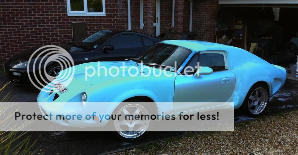

Colour
Think I am going for this colour. What you think ?? olympic Blue very apt i thought.[IMG] [/IMG]
I like. Saw a lovely AC coupe at a classic car meet on New Years Day in that colour, a Sprite as well. Looked good. I am slowly steering away from metallics......
4th January 2013, 21:17
Photoshop a bit cr*p, but gives you some idea...

Thanks for Pic's. Its the blue for me. I think the green for seanick as he is a Nautical leaning.
