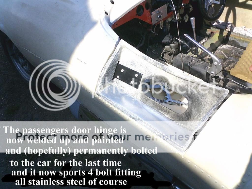

To be honest Paul, I had thought of sealing my doors too!
What stopped me was the thought that its going to be hard enough getting in and out anyway, but with no doors at all, nigh on impossible!

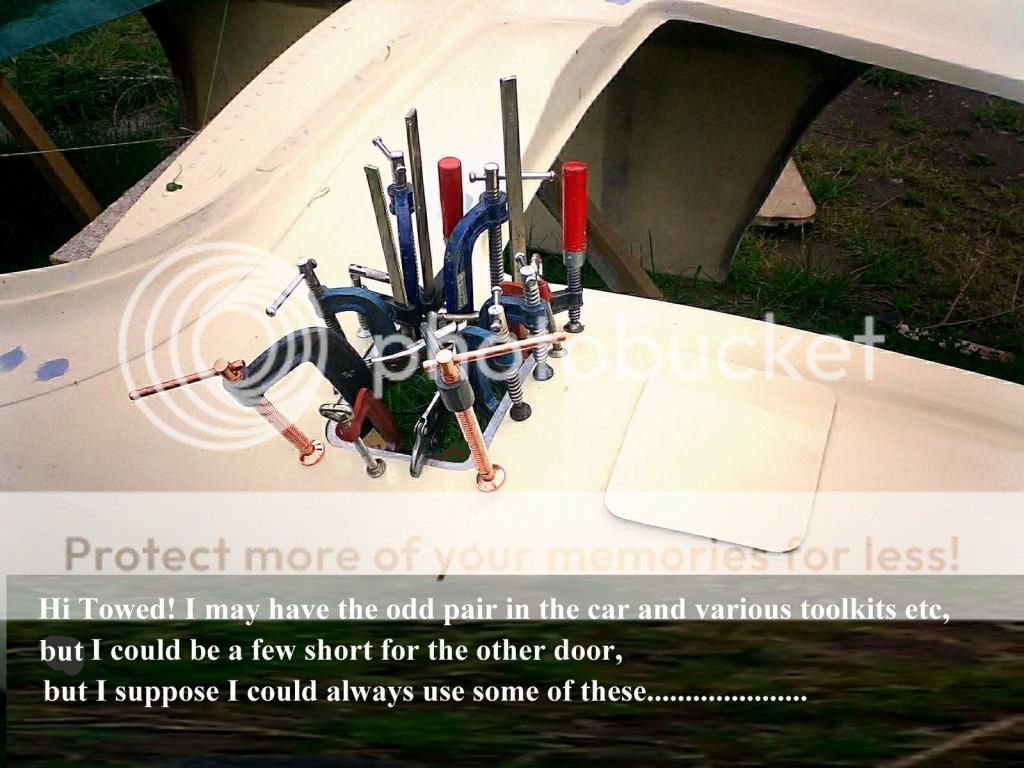

Have you got enough mole grips left over to do the other door too?

[IMG] [/IMG]

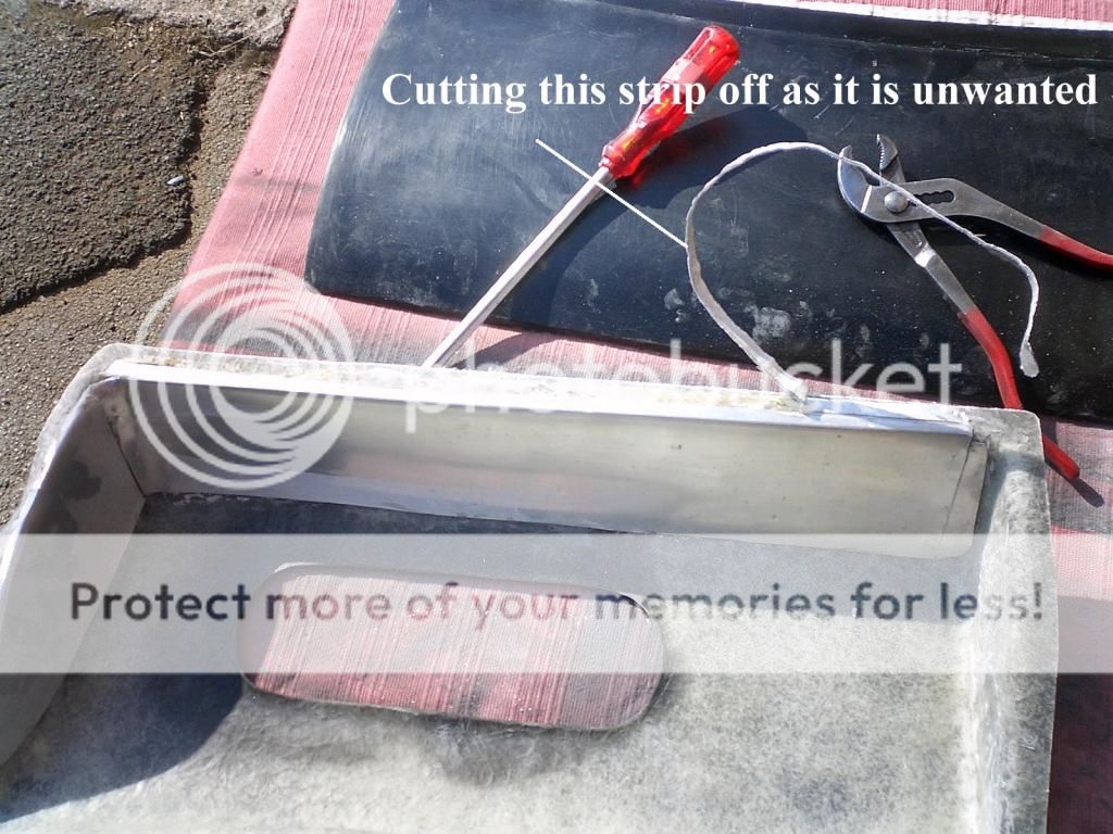

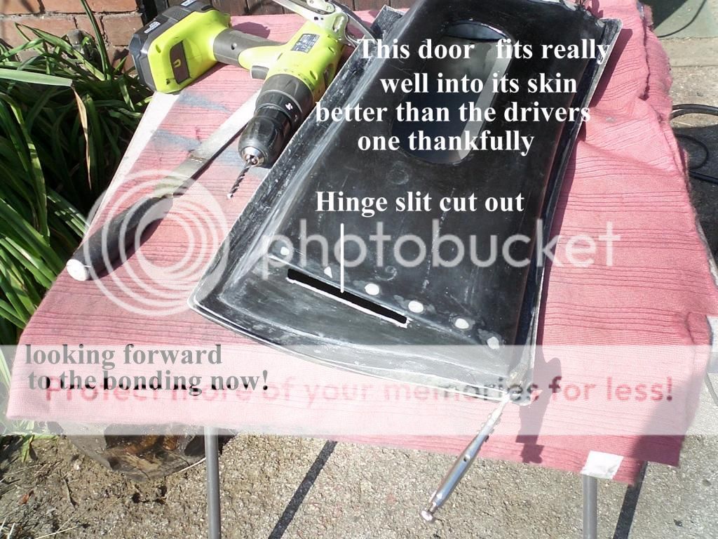

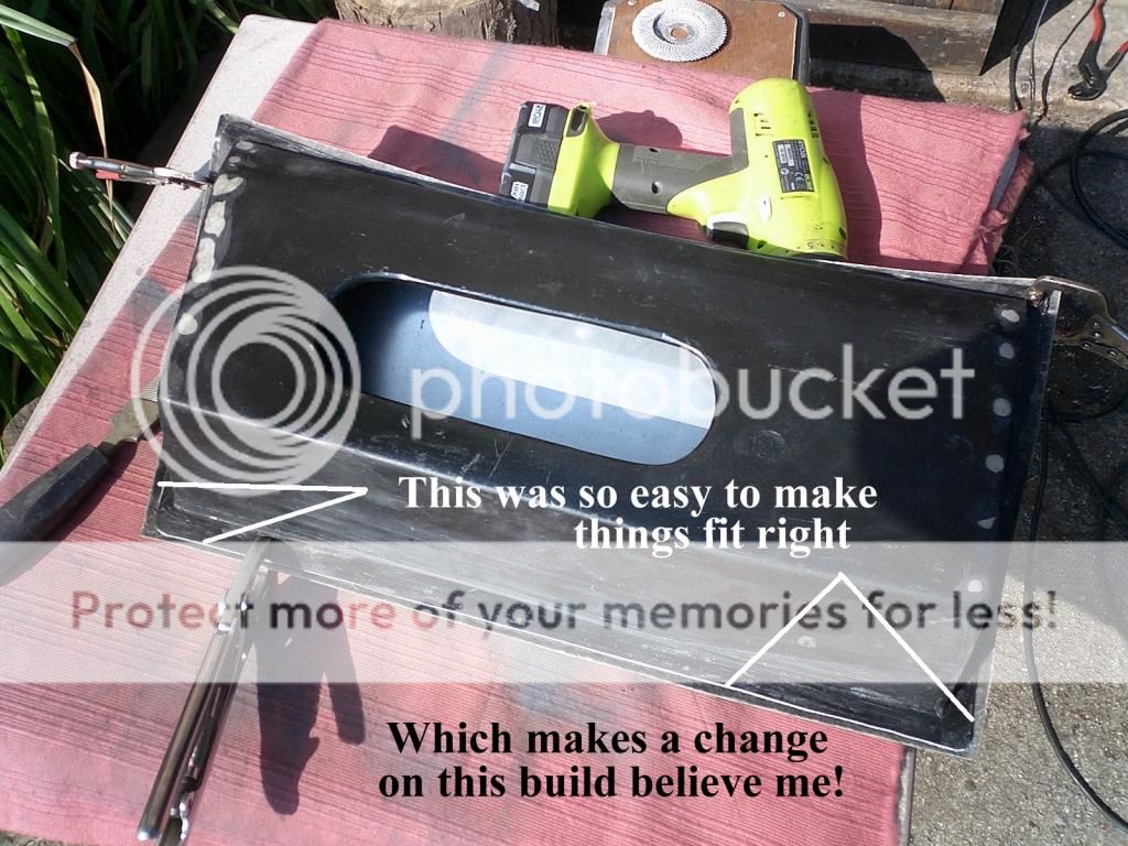

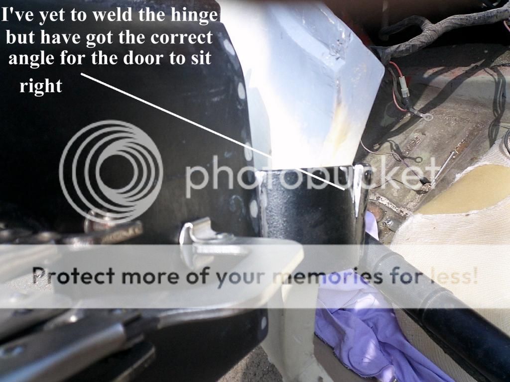

Well I started at 0830, on the passengers door, and after an hour and a half, I have, cut out the hinge slit, (the other one was so fresh in my mind I did not even measure this one, just cut where I knew it should be!)
Also I have cut a strip off the alloy I put inside the skin, because it got in the way of a perfect fit to the door.
I have trimmed the door so it will fit into the skin probably better than the drivers one did. But that is what the experience of doing it once already teaches you!
I must cut and rework the door hinge next, then hang the door for checking,
watch this space...........
[IMG] [/IMG]
[IMG] [/IMG]
[IMG] [/IMG]
23rd July 2014, 15:44

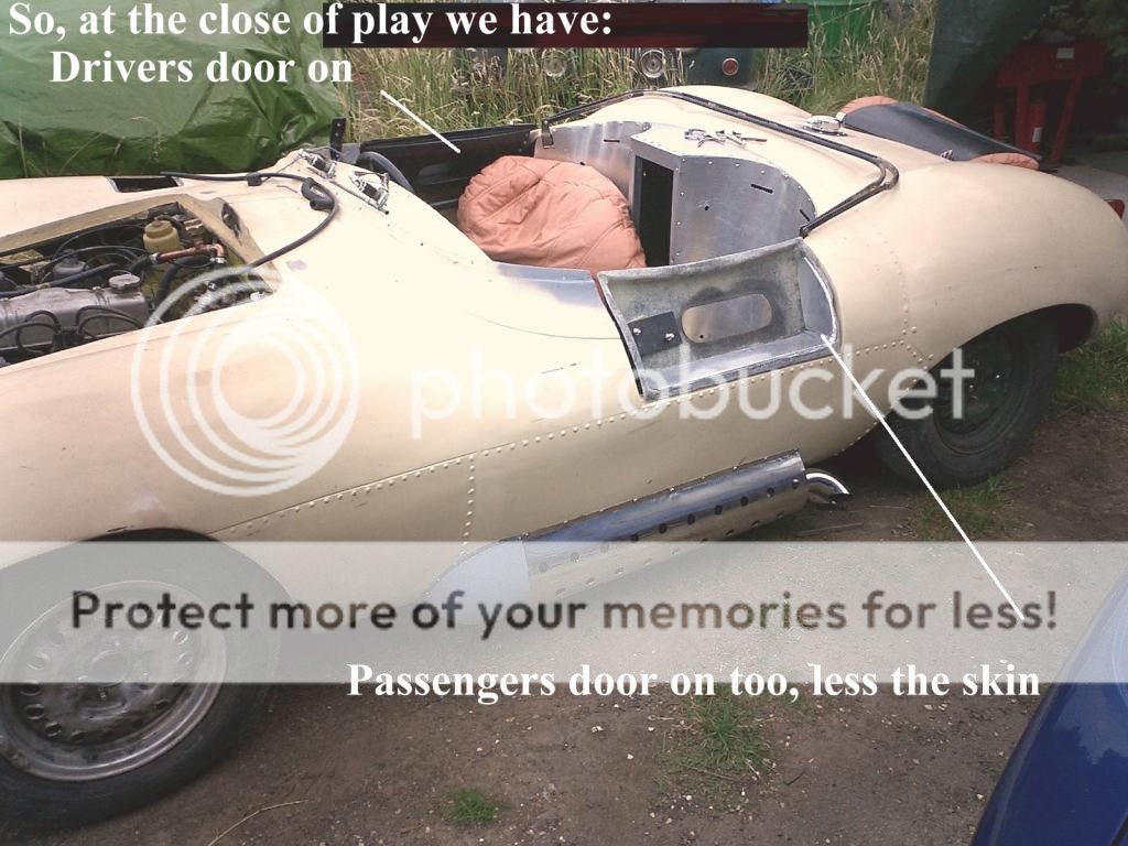

session two Wednesday
Right, I went out and toiled in the midday sun, as per mad dogs, (and I am an Englishman)
At the end of the day, or, more to the point, when I was pissed off with the heat, dust and all else, I packed it in, but have now got the last door bolted on
in roughly the right place. (In the big hole on the passengers side)
I have not bonded the skin on the door, as the adhesive has not arrived yet,
( I did not plan on using the whole 2 ounce pack of epoxy, on the first door, but that's how it turned out) so I had to order more.
Also, I have not welded the door hinge yet, but that is small potatoes, the important thing was to get all the angles correct, and the door hung, which I have done.
Looks like I might have to use two or three tons of filler on the back edge of the passengers door to get the curves to match a bit better, but that is not a big deal either, so at the end of the day, a I am a happy bunny.
[IMG] [/IMG]
[IMG] [/IMG]
[/IMG]
[IMG] [/IMG]

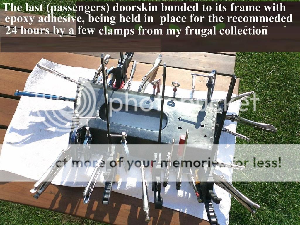

Well, the epoxy adhesive arrived today, giving me no excuse for not using it,
so I took off the door hinge and welded, painted and replaced it, having first drilled out two more holes
I fitted the door and drilled the extra holes in that too, then took it off to have the skin bonded on.
Again, I used all two ounces of the adhesive, which worked out just about right, then clamped it up.
I am not certain that it needed quite that many clamps mechanically to suffice, but it did need that many to appease my sense of humour and presentation! (But I did have quite a few left over.)
You would not believe how heavy those clamps made the workpiece, I could hardly carry it at arms length!
I will have to leave it for a day or so, like the other one to cure and harden properly, then I can get on with making both doors fit right, filling, sanding and making them look right prior to painting.

[IMG] [/IMG]
[IMG] [/IMG]
24th July 2014, 18:03
Location: Swansea
Posts: 803
[/URL][/IMG]
Hahahaha Brilliant, that made me laugh out loud.

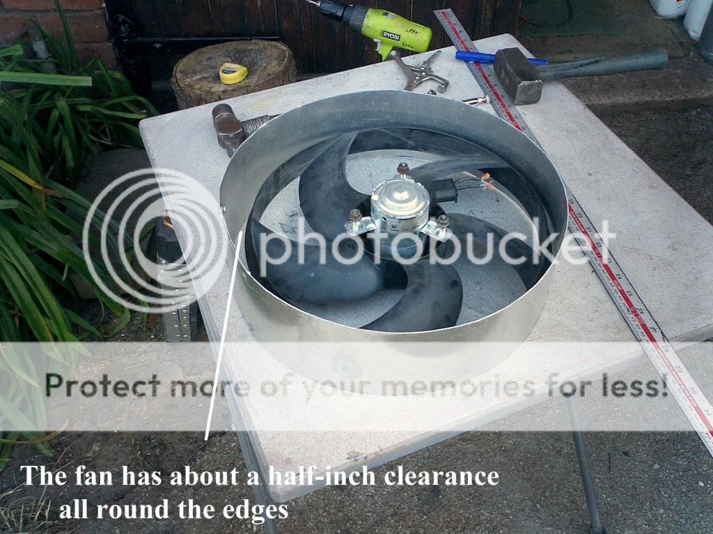

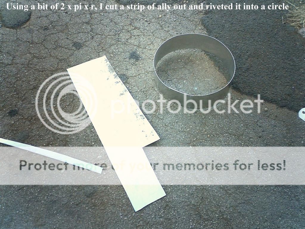

I needed to make a cowl as it came without one, so I used some aluminium,
and fixed the fan to it with three stainless arms.
Being an incurable hoarder, I still had all the old rubber strips that came off the Spitfire donar, so used some of that to go around the cowl where it will touch the radiator.
I will finally fit it to the car tomorrow, but all the graft is done.
Landmannn and Oxford, thank you for your input!!
Does this one have your blessing?
No. it won't fit on the other side! Bollox to Canleys!
This thing'll really cool it believe me!
