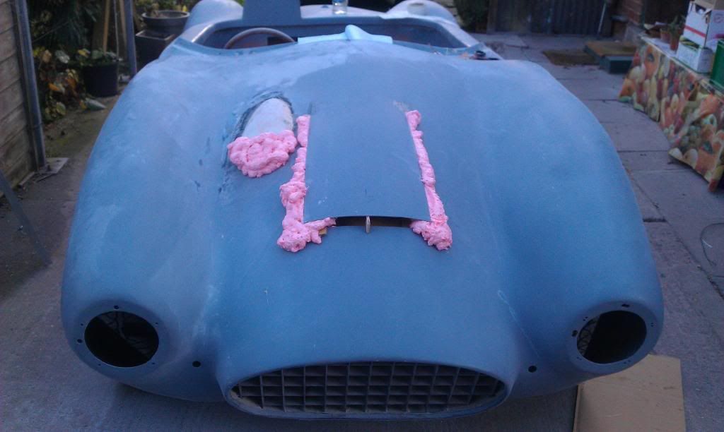

hope this works car with altered scoop and bonnet

Old 12th December 2012, 11:27
Thats a lot of bubblegum.

[IMG][/IMG] bubble gum removed

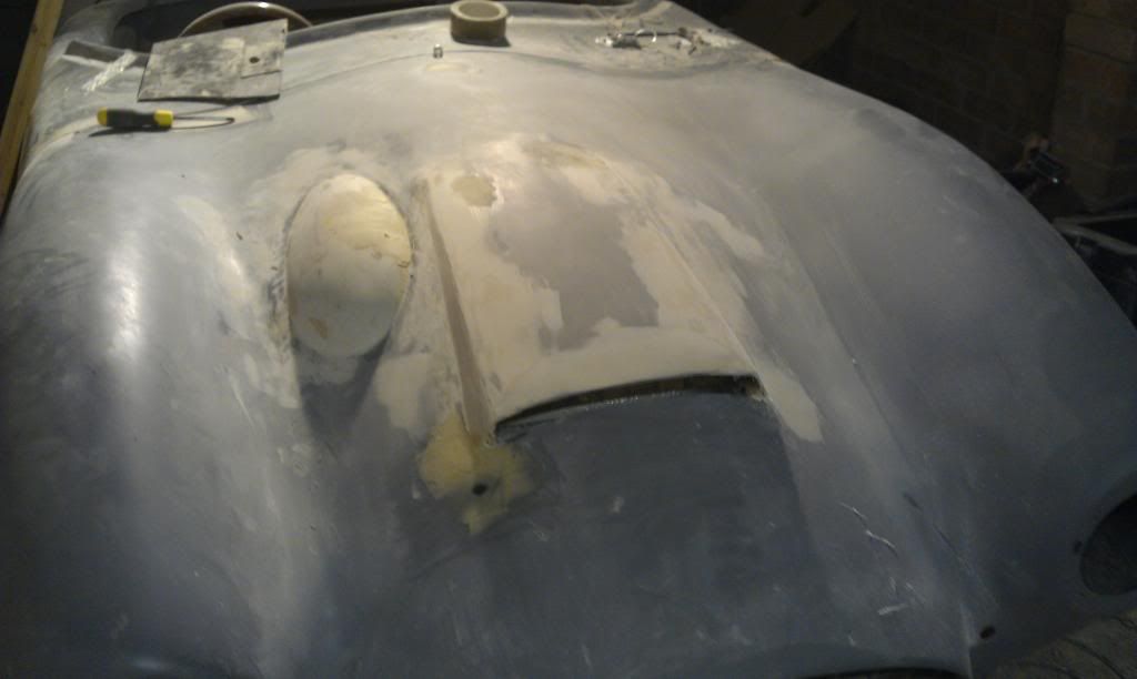

and filled[IMG][/IMG]

CarNoob - Glad you got the hang of loading photos as the are a big help.
Can I just ask what the "bubble gum" actually is and why you're using it?
Is it an alternative to using fibre glass the way Mister Towed did on his bonnet?

My guess is it's strawberry flavoured spray cream - you round up all the stray cats in the area, liberally apply spray cream to the rough patches on your bonnet and the cats do the rest. Saves hours of sanding...

Had some fire retardant foam so used it to fill gap then sand till happy with shape then glass fibre. but i must say it does look tasty.

Looks good. What did you use to form your blister?

just cut some cardboard to make rough shape filled with foam then used a large hacksaw blade to cut to shape. sand glass and fill then sand again
