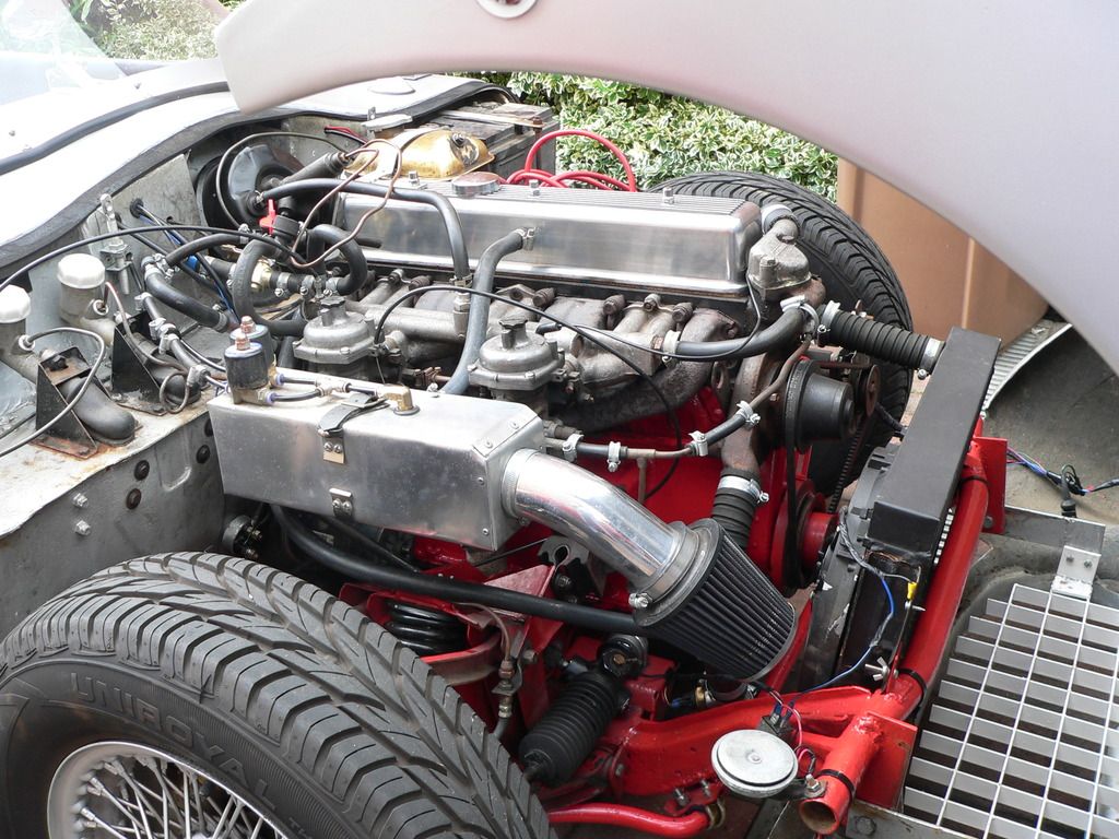

Been busy rubbing the body down over the last few days and today the air box has arrived back from the painters.
Black powder coat gives a lovely smooth finish. Air filter roughly in place for now, once the box is fastened to the carbs i'll be able to see the angle for the air filter/tube and make a permanent fix.
I'm thinking of using a latch type mechanism or leather straps to fasten the box to the back plate.
Also been busy machining a holder for the fire extinguisher out of ally, will post pictures when finished.
Well that's it for now see you all soon.

Very nice, looks familiar too...
26th July 2015, 09:27
Posts: 839
Ah i new i had seen it some where before......
Mr T, guilty of taking your idea, easy to do and practical. Do you get much induction noise from the box?
