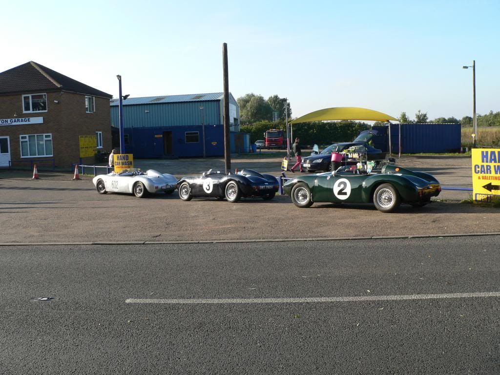

175/80/14's fit mine fine front and rear.
I did move the front bulkhead back 20mm and bash them in with a lump hammer though. 175/70/14's should be a good fit but don't quite fill the arches like the 80 profiles do though. You can clearly see the difference in looks between mine (when it was on 70 profiles) and Phil and Barry's cars on 80's in this picture -

Posts: 839
Good comparison photo Mrt it's only in the flesh that you can see how they look, are all three cars on 14 inch rims, the green sammio looks to be on larger rims but it may be the angle deception of the photo?

Posts: 5,186
All on 14's but I believe Phil's (green) Spyder is on 5.5" wide while mine is on 4.5" wide while all are on 175's. Not sure about wheel width on Barry's blue one. The main differences on that pic are the tyre aspect ratios, 70's on mine and 80's on the other two, and suspension settings, mine was lowered much more than either of the others at the time.

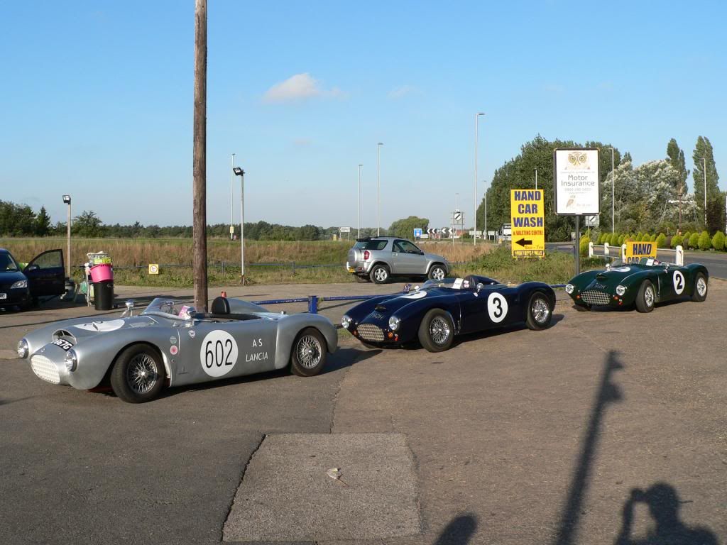

I'm usually a fan of Autobahn Scraping suspension but it was this picture that prompted me make the change to higher profile tyres and less slammed springs as I felt the other two cars just looked better than mine at that ride height.
Here's another shot from a different angle which also captures the difference -
yes towed right... green car 5.5 72 spock blue 4.5 60
