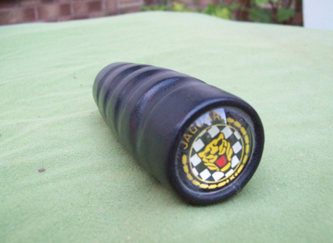

Forgot to say that i had bought a small Ultrasonic cleaner for the carbs when i rebuild them. I have many things in the garage to rebuild and get shotblasted.
and a gearknob, i will cover the cap.
