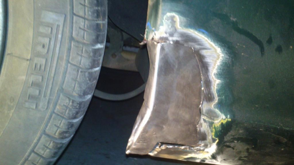

N/S outer sill removed ( not for the faint hearted)

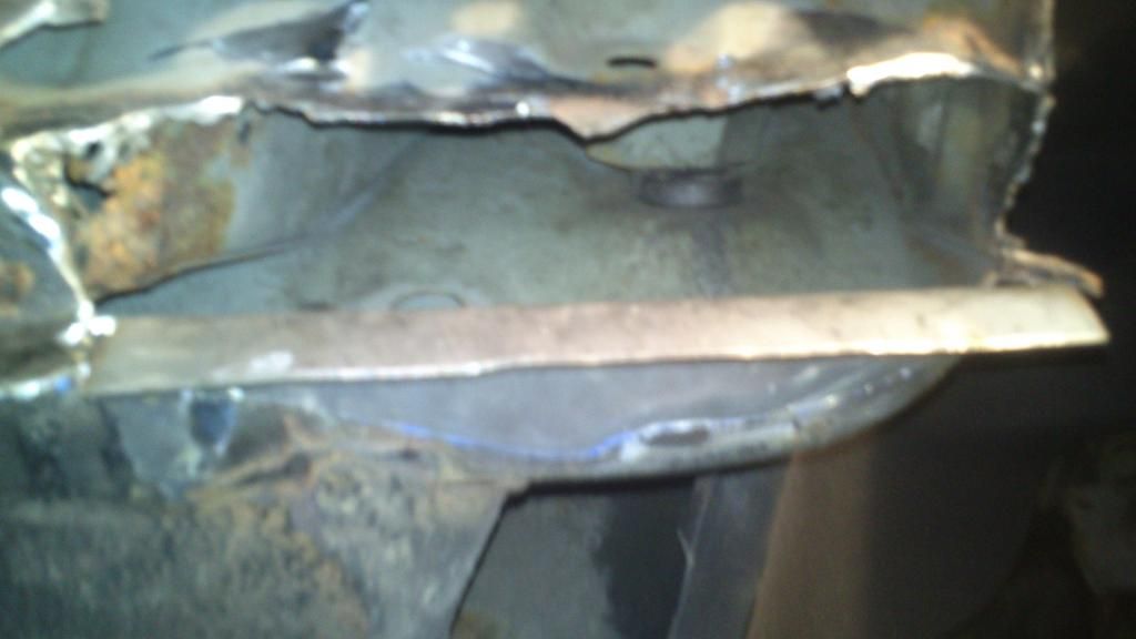

floor / inner sill repair in place

new out sill on

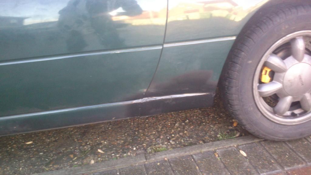

other side, not as bad more rot further up the wing than the n/s
