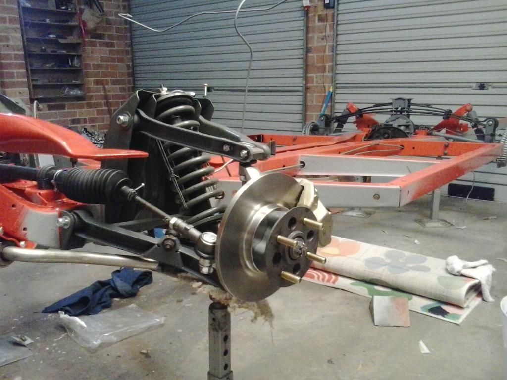

discs and callipers on!

Shiny! Love how it is going.

looking good

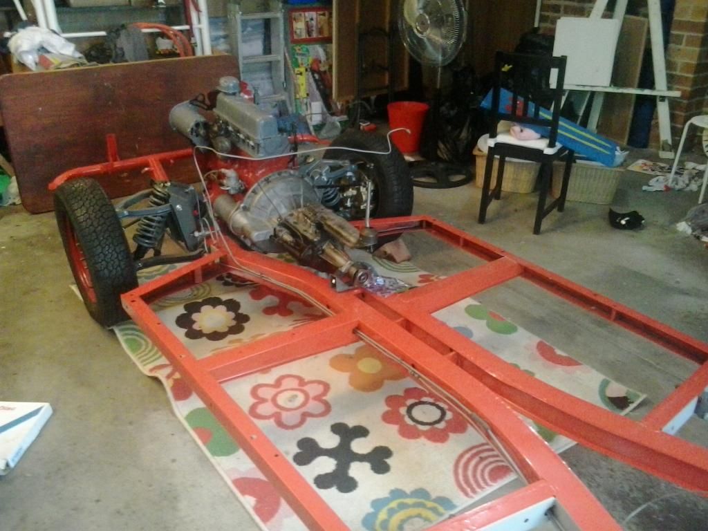

Default rolling rolling rolling!
rolling chassis:
engine cleaned and dried and ready to be masked up for painting too.

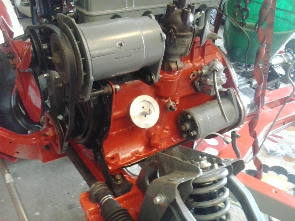

Engine is in!

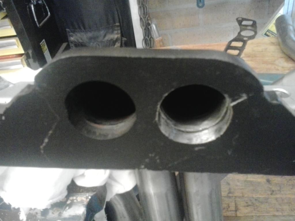

Got a mk2 zorst from mr+mr rimmer. Had to smooth out some harsh lips
